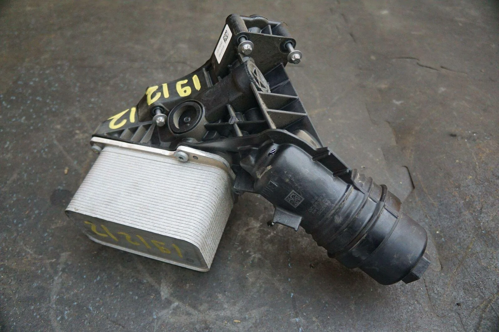

Yeah I've heard multiple times that our cars run hot. I figured I'd see some sort of limp mode before it gets bad but still worrying when I see it creep up haha. I'm on 0w-20 as well, thought about going to Liqui-Moly's 5w-30 but I'm still on rhe fence. I know many people do just fine but idk. I'm curious if/when some sort of aftermarket oil cooler will be released in the market. I know we have one already but I'd imagine there would be a market for one with more capacity.

Won't limp. But will pull serious timing

The oil cooler actually works very well for being a non-radiator type. It's on the block under the filter. Big silver block. If you notice in my logs above it's basically not much difference in oil temps with 20*F more ambient. I need to log later this summer when it's actually hot and humid.

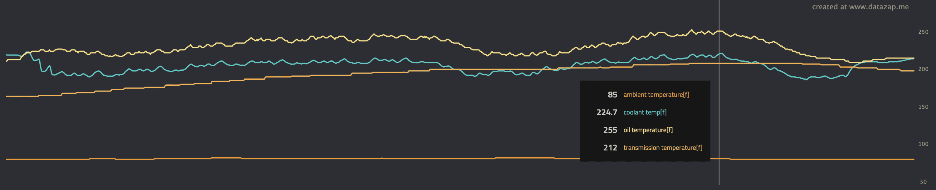

So here is a great visual showing what I mean that water and oil temps influence each other. It's not really summer here yet in the North East but this session was 85* and you can clearly see oil and water temps following the same trend.
