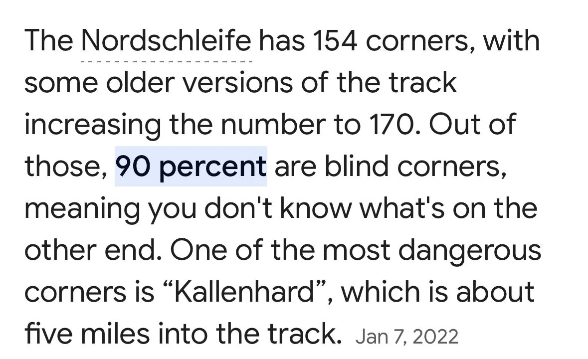

Not sure how you think I was comparing Palmer to Nurburgring. I was simply challenging your asinine comment that blind corners make a bad track. The Nurburgring is 90% blind corners and considered one of the most challenging tracks in the world.
It’s a bummer you think one of the most challenging tracks in the Northeast is a bad track. I sure hope that Palmer video of yours is in slow motion. That lap is almost a whole minute slower than us.
your math is wrong unless you count blind apex as blind cannot see the apex. :lol:
palmer is interesting but not challenging. beautiful in fall color for sure and that's what the video was for not the ripping out going so fast that you cannot appreciate the beautiful surrounding. I do this time to time to practice my vision. - most important skill for track driving.
as this discussion started, in my opinion, palmer is not a track you'd make trip for compare to watkins glen or Road Atlanta or Nurbergring or Laguna Seca.
I understand when someone is slower than a bone stock 90 hp 1990 ford escort on track at Palmer, they would consider it not a good track and not challenging. If I went even slower on my cooldown laps to match those times, I would find it not challenging either.
