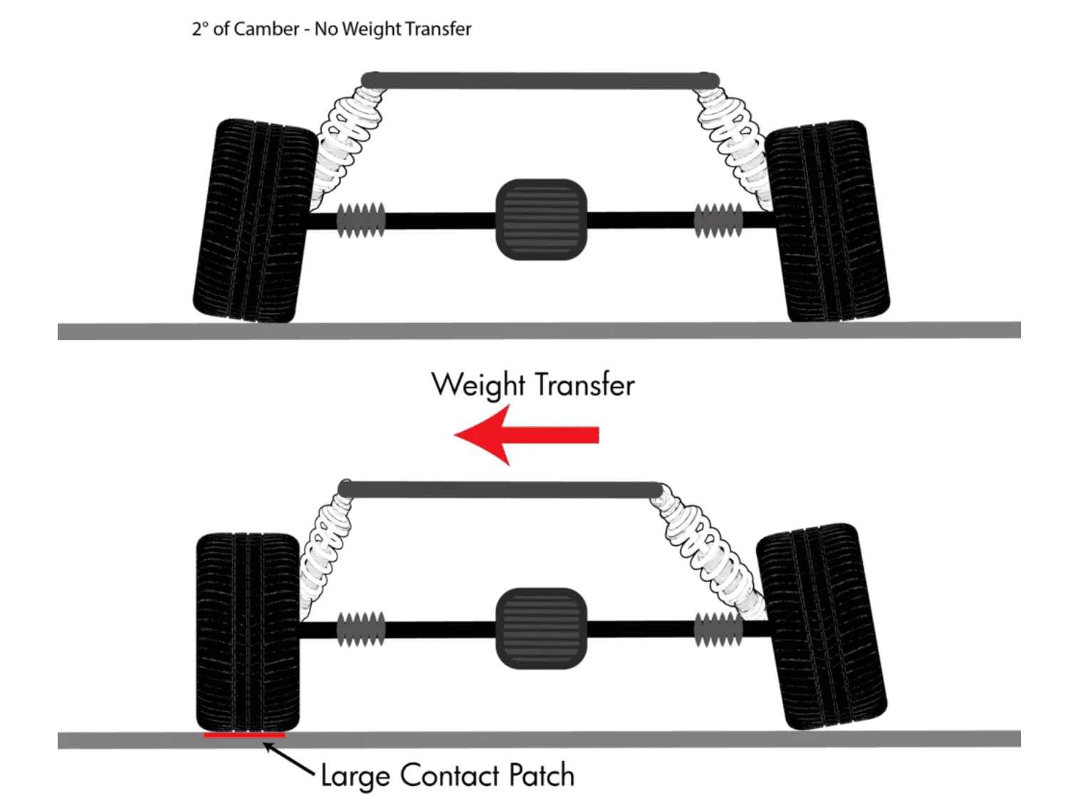

Unless I'm not understanding, you are thinking about it the wrong way.
The reason you want more negative camber in the front is because it is strut based, so as one side loads up and compresses, the negative camber reduces. An extreme example is if you have -2.2 at static height, when the suspension compresses and the arms articulate, you might lose negative camber and be at say, -1.6, now you are losing more of the contact patch, and thus, less grip. So, the more negative camber you have in the front, the less tire contact patch you lose as the suspension compresses in a corner.
Basically, you want the car to roll ONTO the contact patch and you do that with more static negative camber, as the car rolls into the contact patch, the suspension is compressing and you are losing negative camber at the same time.
Here is a great visual to illustrate the car rolling into more contact patch:

The rear on the Supra is a multi-link setup so you actually do not lose negative camber when the suspension articulates, in some instances, you actually get more. So you want to balance negative camber vs straight acceleration grip in the rear. If you have too much negative camber in the rear, and less contact patch, you will have less acceleration traction.
Nope that is correct you are maxing contact patch, grip and tire wear just as the illustration shows. The only thing missing is the fact that the tire is not a rigid structure as in the illustration suggests. The effect is more of a subtle thing where the downward force on the tire are changed by Camber to max the contact area and forces on it especially in cornering. The contact area is a dynamic thing. Check and you will seldom see a gap in reality like in the pic. Ok for illustration sake though. Depending on your application it is all a tradeoff. For circuit courses with lots of turns you want the camber. Looking at tire wear can tell a lot off the story. Where is the contact patch on the tire most of the time. In the worse case scenario you may only use half the tire and a bit of the sidewall. The sway bars effectively add compression on the weighted side and "lift the inside tire. Unclear if the overall grip is increased or reduced but can have a major effect on balance/handling.
