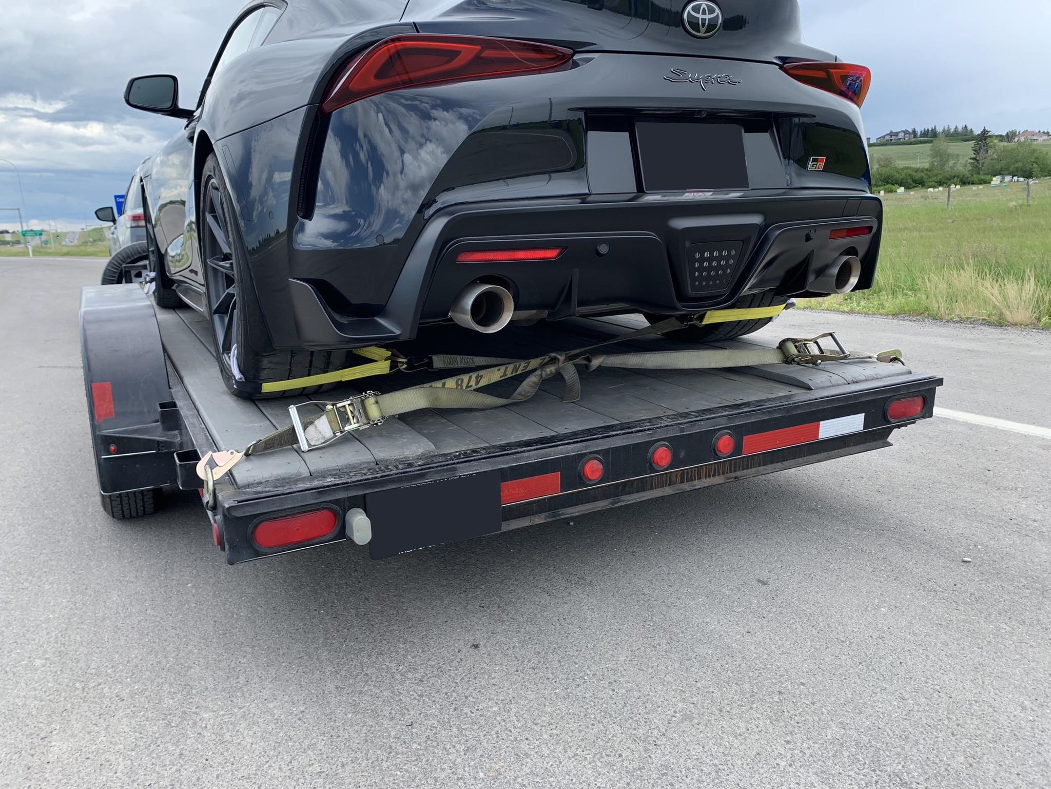

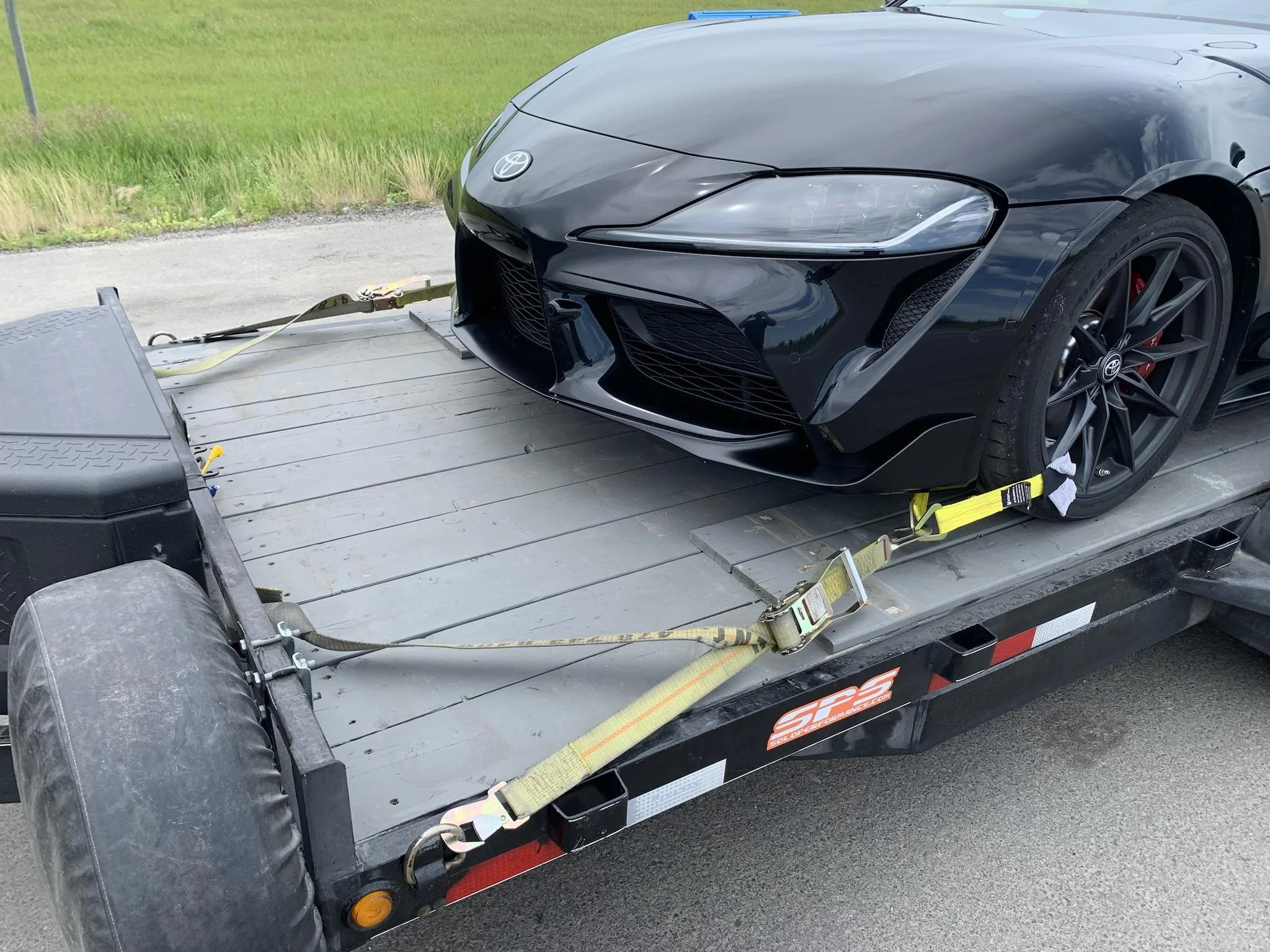

Do not cross straps. Actually a big no no
Cloth straps go through wheels. They don’t mark
The location of my D-Rings on my trailer doesn't really allow me much of an option for how to strap the rear of car down... had no choice but to cross the rear straps. Worried that it's going to cause the rear alignment to be out tying it down like this, I didn't cinch them down overly tight, it was just a quick test tow to the local scale to set my tongue weight.
Any thoughts?
Any thoughts?
The back is correct. Rear should always be strapped. But you should absolutely 1000% definitely not strap the fronts like that. Your steering rack is going to go boom boom.
Use the caster arms.
Sorry you're saying it's ok to cross the rears like that? The way it's set up it's trying to force the rear tires to toe out, and against the static negative camber that I have. Doesn't seem like a good idea to me.
As for the fronts, do you just put a small axle strap across the caster arms? Do you cross them?
Fronts we leave straight, yes, with small axle strap. Rears we *always* cross.

Way i was taught:
in your crossed rear photos. Picture in your mind what would happen i f one strap broke or came loose. The other strap would instantly have way too much play and allow for too much left and right movement
if you strap straight back each side and one strap failed the car would be better secured from lateral movement.
Just my .02
