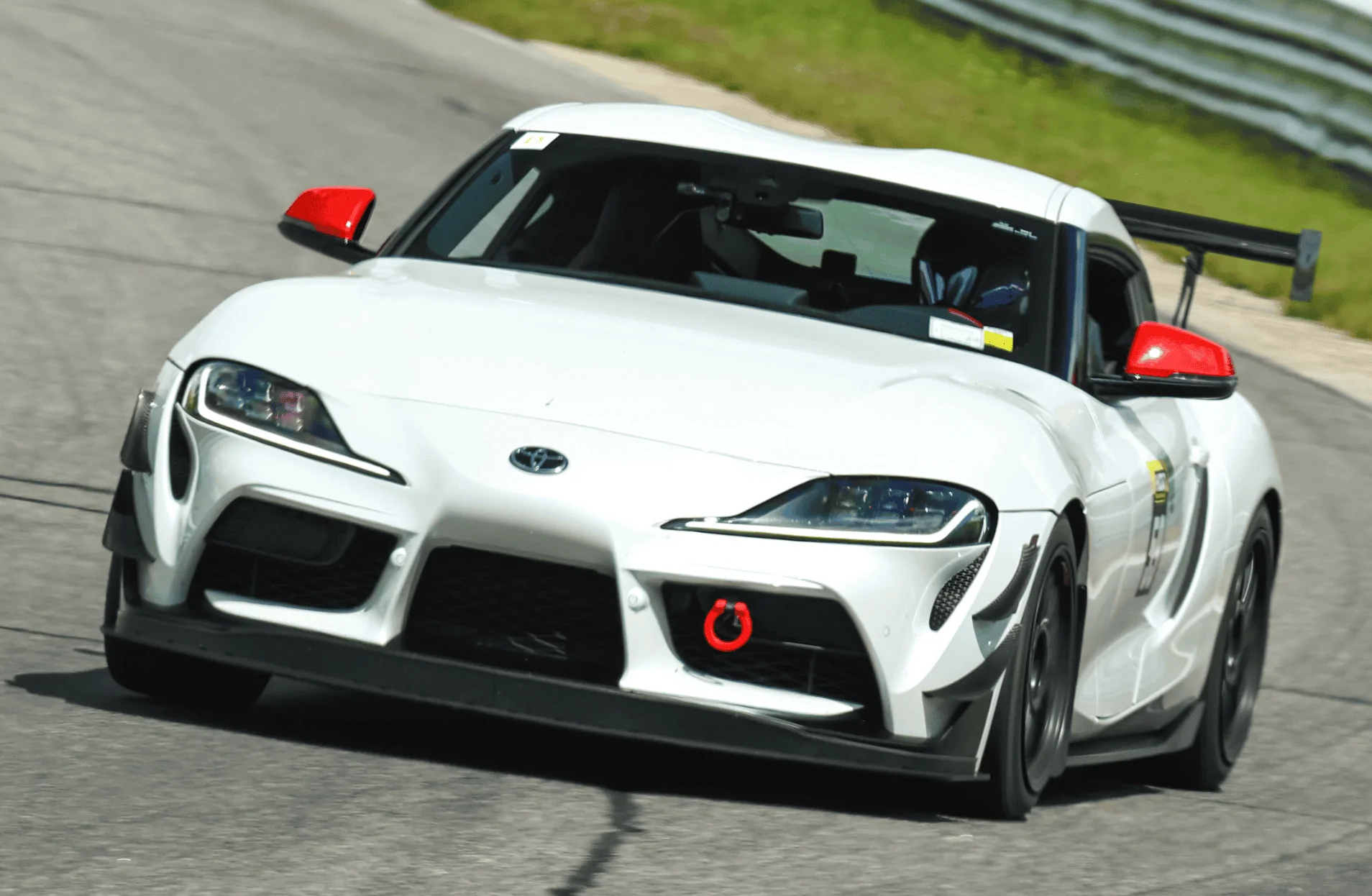

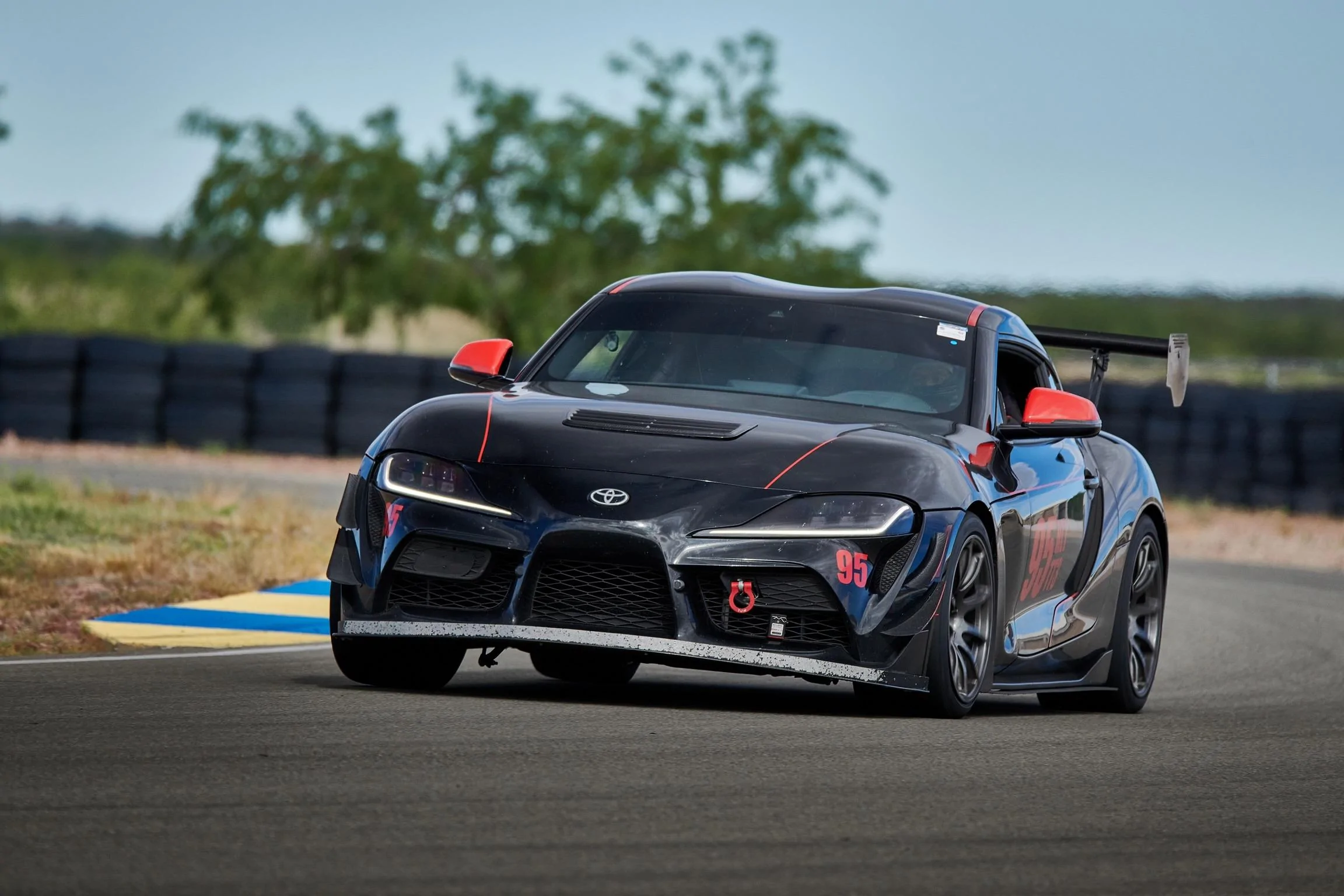

Okay, here are actual real world examples from my Supra on track which match the illustration almost exactly: :cool:
Great illustrations!
When I said they don't match reality I was referring to the top illustration that shows a vehicle in a neutral stance with big gaps in the contact patch area due to camber.
Additionally, in terms of the cornering pic, you can see very clearly it matches reality save the part that the tire is a totally rigid structure. That is the part I was referring to. Look how the outside tires are basically rolling under the edge of the wheel compared to the top. Not the same as in the illustration.
8,801
17,262
Well yea, the illustration is exaggerated, although, my fronts do have a small gap at static rest on the outside from the negative camber, but nothing like the stance bois do, which are closer to the illustration. ;)
Yup, another reason to have more static negative camber in front, so when you are cornering and losing negative camber, you aren't rolling over onto the shoulder of the tire.

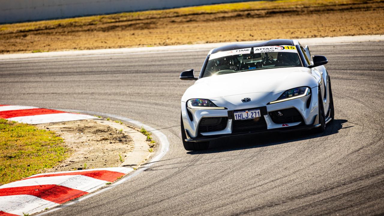

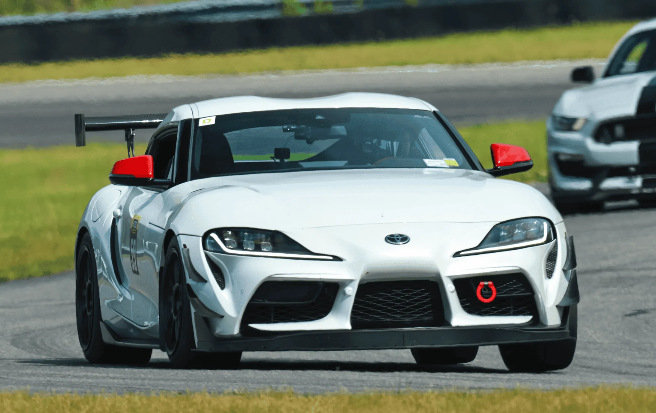

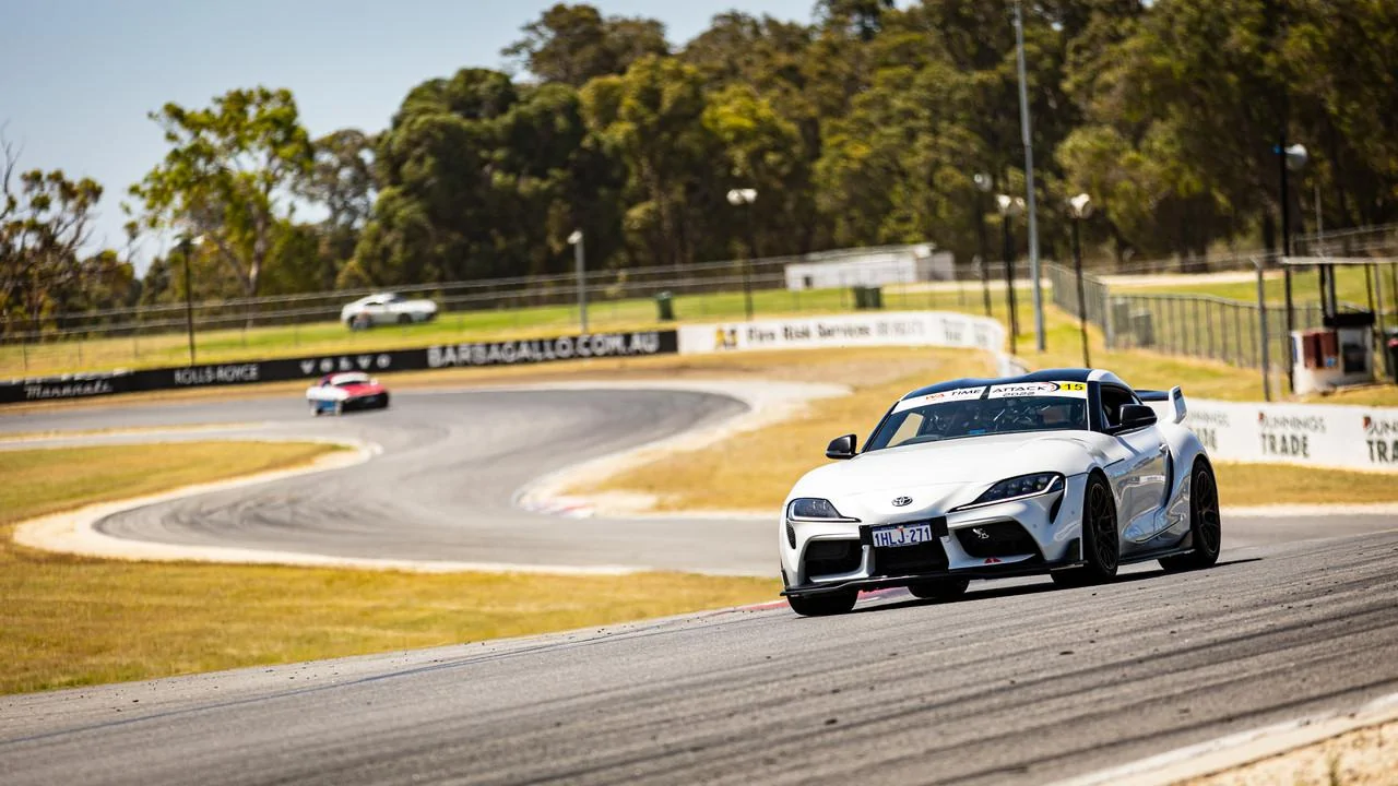

Here is another shot on a tight turn after a fairly high speed straight. You can see the rotation on the left side front and rears are pretty flat and if you zoom in can also see the neg camber on the right side. I have gone back to stock bar in front from an Eibach and have been playing around with the rear since, and ever have run without rear bar since I went to coil overs to get a little more acceleration out of the turns. This pic however has eiback bar on soft. These are on maxxis rc1 tires and -2.8 front and -2.6 rear. With about 1/8 tow out front and 1/8th tow in rear. Have camber plates on the coil overs and all spl arms front and rear to get to these settings. But I also ran on stock shocks with camber plates, sport springs, and the eiback front and rear bars with all the spl arms and it also worked really well on that set up. Rear wing and front splitter also help a lot. I have tried a lot of settings going up to -3.3 front and -3 rear but then was trading off too much forward grip for acceleration on the rears so this setting is the best I have found so far. Hope it helps others as they are fine tuning their set ups.
