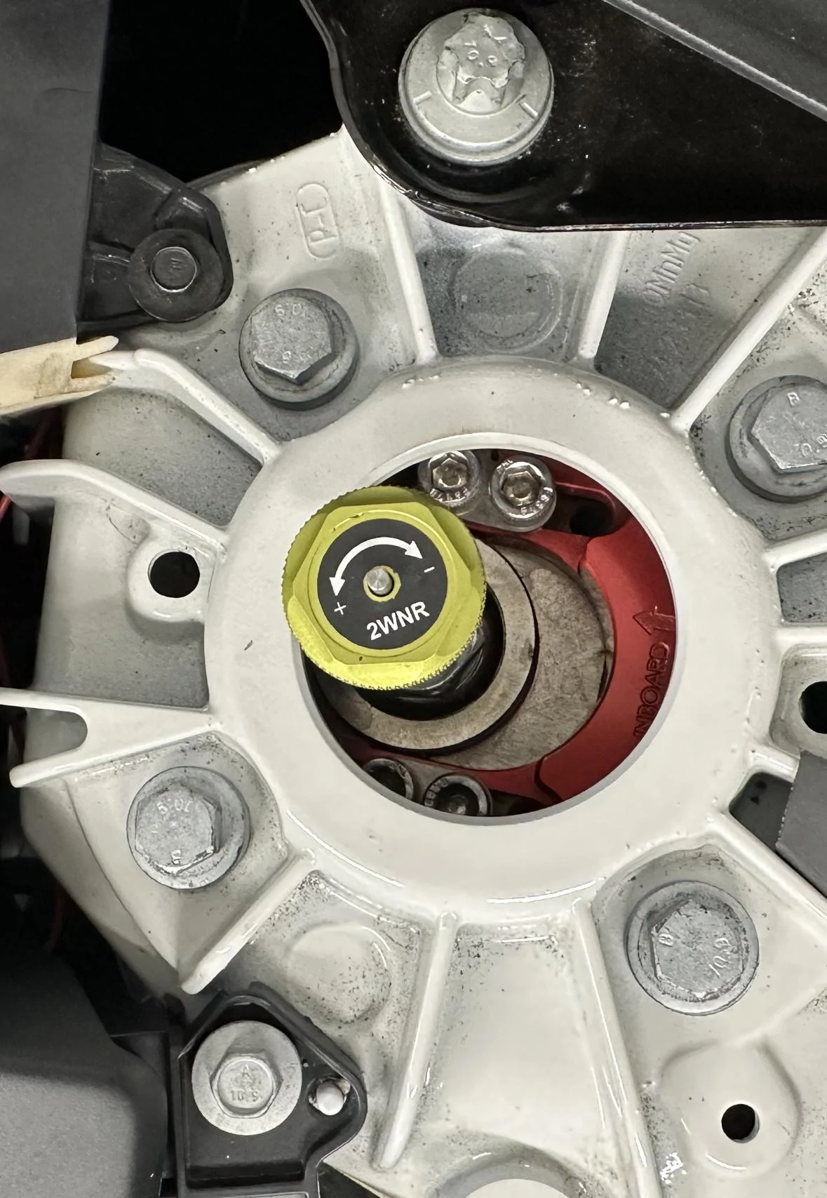

Well ...if you have coilovers and are going to max the plates, anyway, then it's fine because you can set them before you bolt them up to the car.
Adjusting them after they are on the car pretty much requires cutting the strut tower with a hole saw to open it up in order to get tools in. When I installed mine, I didn't have all the stuff I needed, so I ended up just cutting down an allen wrench to fit in there and tighten it with my fingertips lol
Don't get me wrong. It's worth it, just not all that easy. The arms are going to be far easier to get to.

Huh? You are using the wrong tools my man. No reason to cut the tops of the towers.
Use this:
I use that and have no issues getting to these to loosen and adjust:
