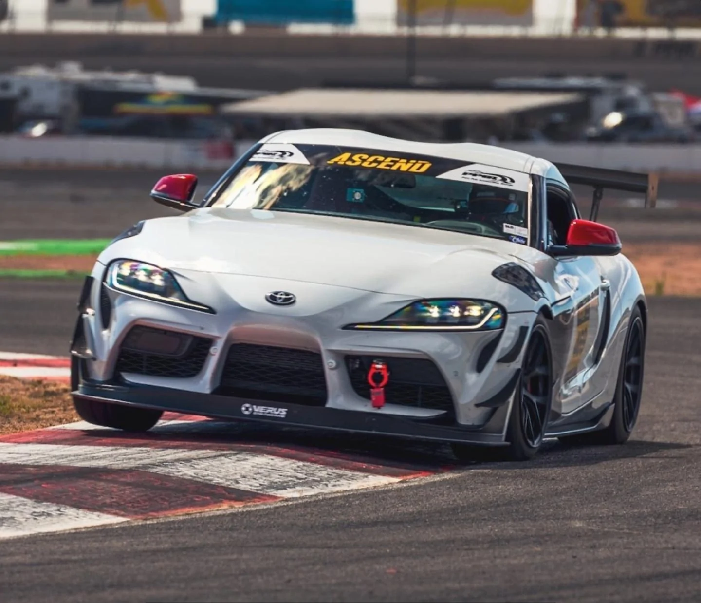

Front Eibach bar only here as well. Divorced and I run pretty high rates on mine, max stiff setting on the bar. May try the middle setting for a session or two next time, just to see how it does. Very easy to get the car to rotate as I please, VSC and TC off. Actually spun the damn thing in a session this morning, first time in months.
Great pic! I know the subframe has to be dropped to put that rear sway bar in. So I get why the benefit doesn’t outweigh the pain in the ass for the majority. The mechanic I used was really inexpensive to do so. That’s why I did both.
Great job fully driving her. She’s definitely more wiggly & easier to rotate with the VCS off. TC off is a must! Your car looks the same as Bryan’s. Don’t see many of them with that cool 2020 red/white. Jealous of all you northern folks able to track right now!
