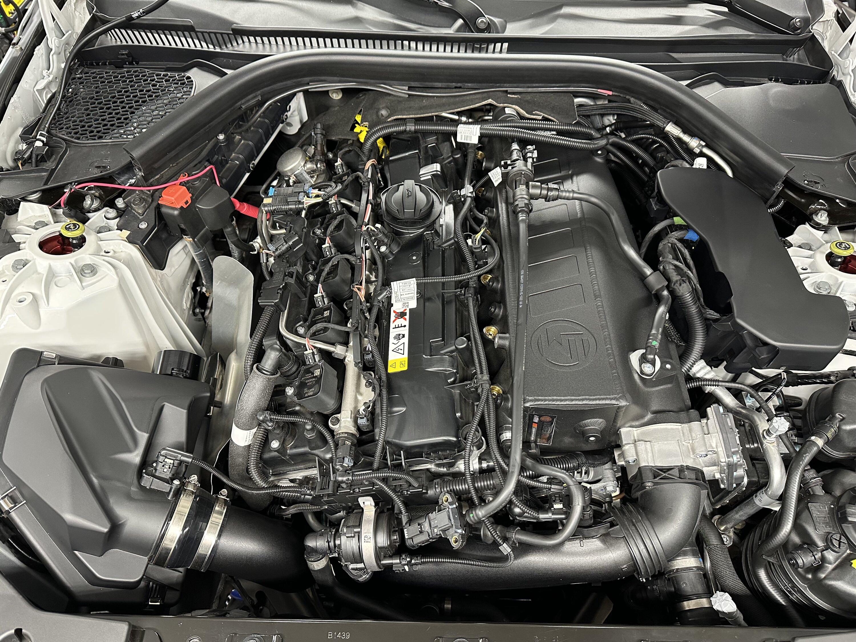

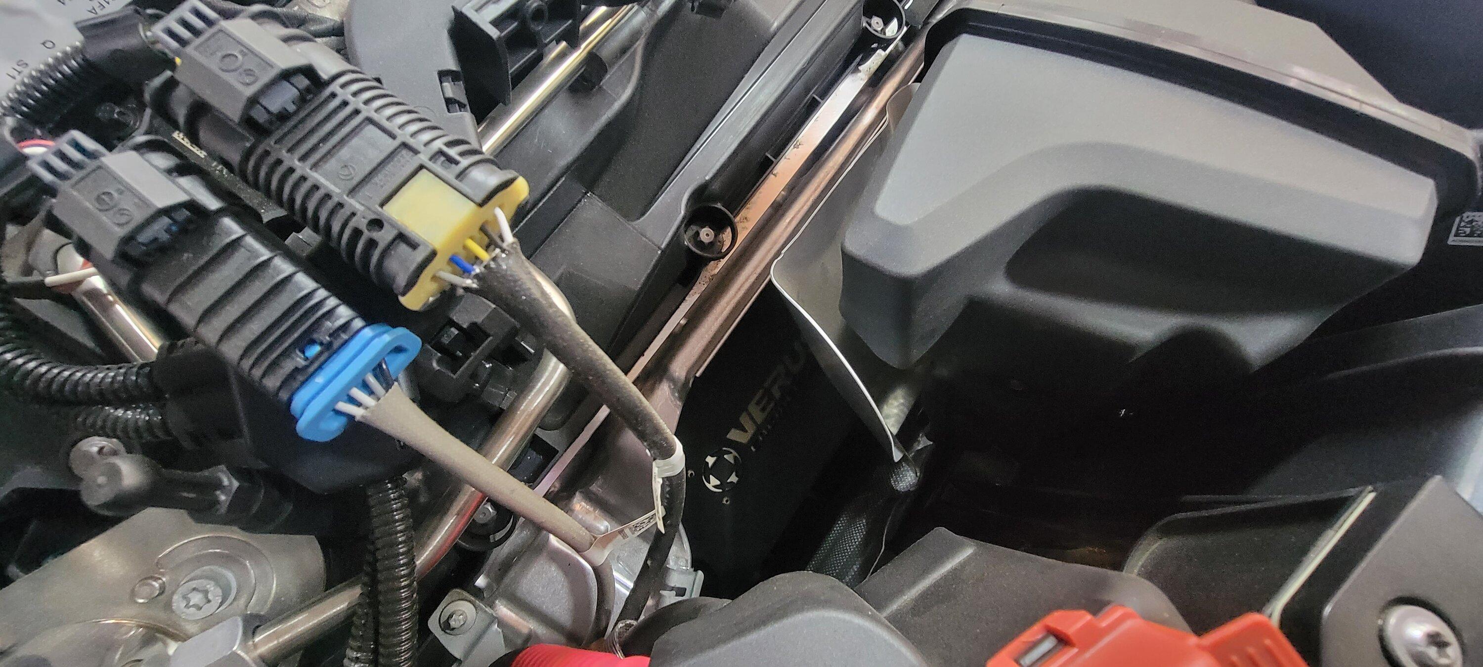

I am installing the verus heat shield today anyone leave the OEM shield in place as well to add extra shielding for the intake
8,783
17,240
The metal one attached to the airbox? I did.

Maybe on a six port you have to. Mine is a two port.
Nope, 6 port is fine too.
Although now that I look closer at it, looks like it does rub. About a 1/4" gap toward the bottom but not enough to where it won't rub. This is probably the rattle I hear every now and then.
Yes that is exactly where I saw it contact and I will pound it out and re-install.
I pounded it flat in that area with a rubber mallet and now have a good inch or more. It makes no sense to remove it from a functional stand point.
I'll do the same one of these days. Probably sooner than later haha. Need to get the resonator delete too.
