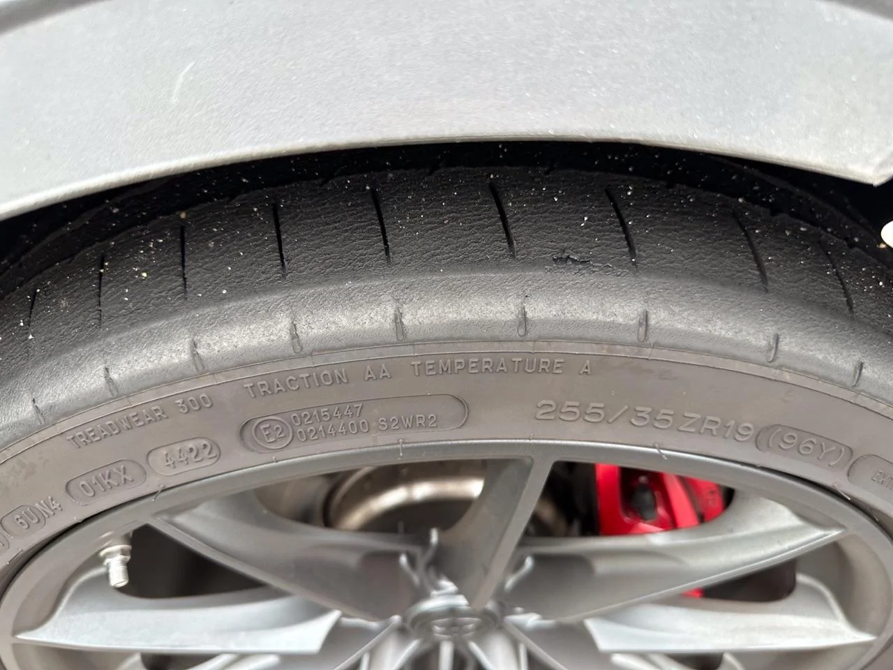

The very outside of the shoulder on my front left PSS took a beating at the last track day. The rest of the tire looks actually fine, just the very outside. I run 36lbs hot and may have to bump that up a bit. I am also adding camber plates and considering moving to soft on the Eibach front bar. I was told by someone at the track I could remount the fronts swapping sides. Has anyone done this? I’d like to make it a few more track days while I order new wheels and tires.
Are you considering setting the front sway bar solely to minimize wear or for any other benefit too? I'm asking because I have both the front and rear set to medium (eibach as well). I was wondering if I set the front to soft, if it'd help with even quicker turn in or do the opposite. I feel like turn in can be a bit quicker maybe but need a little more seat time with the sway bars to be sure. But just considering my options ahead of time. My car is all stock besides the sway bars and wider wheels, but stock tires still.
My turn in is a bit slow on the med setting but I do not have the rear as you do. Yes in theory you will get better turn in going to soft up front with less tendency to understeer, less heat in the front tires and overall increased grip. Give it a try and let me know. I actually am fine with the way the car is handling but really never tried soft. I am really beating up the front left tire so I am looking for some solutions. I'll try the camber first, stiffer sidewall track tires, then possibly adjust the bar. I may even install the rear bar once the season is over since I have it. Did you try soft on both bars prior to going to medium setting?

Softer up front can increase oversteer as front will have more grip.
For turn-in sharpness also take a look at your front toe settings. I found toe in causes some vagueness and going back to zero toe in front sharpened things up.
Adding more negative camber in front will be the single biggest helper in decreasing outer tire wear.
