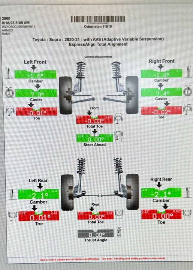

My turn in is a bit slow on the med setting but I do not have the rear as you do. Yes in theory you will get better turn in going to soft up front with less tendency to understeer, less heat in the front tires and overall increased grip. Give it a try and let me know. I actually am fine with the way the car is handling but really never tried soft. I am really beating up the front left tire so I am looking for some solutions. I'll try the camber first, stiffer sidewall track tires, then possibly adjust the bar. I may even install the rear bar once the season is over since I have it. Did you try soft on both bars prior to going to medium setting?
No, I set both to medium from the get go. Car feels very planted but I think turn in can be quicker. Mind you, this is only after one track day so going to go to a few more and see how it feels at autocross before I make any adjustments. I attached my alignment values for now, which are limited since my other suspension components are stock. This is what I'm running with stock tires, so also curious to see how you feel after the rear bar and stiffer tires.

I'm running -1.75 at all corners 0 toe. You do have significantly more camber in the rear. I agree with Razor camber up front is what you need.
Yeah I agree. Will get there when I eventually do camber plates or adjustable front arms. Leaning towards the arms.
8,779
17,223
Amazed your cars don't feel like oversteer machines with no toe-in in the rear. Probably because of the very small amount of negative camber in the front.
We have stiff bars up front, little camber, and 255 tires LOL

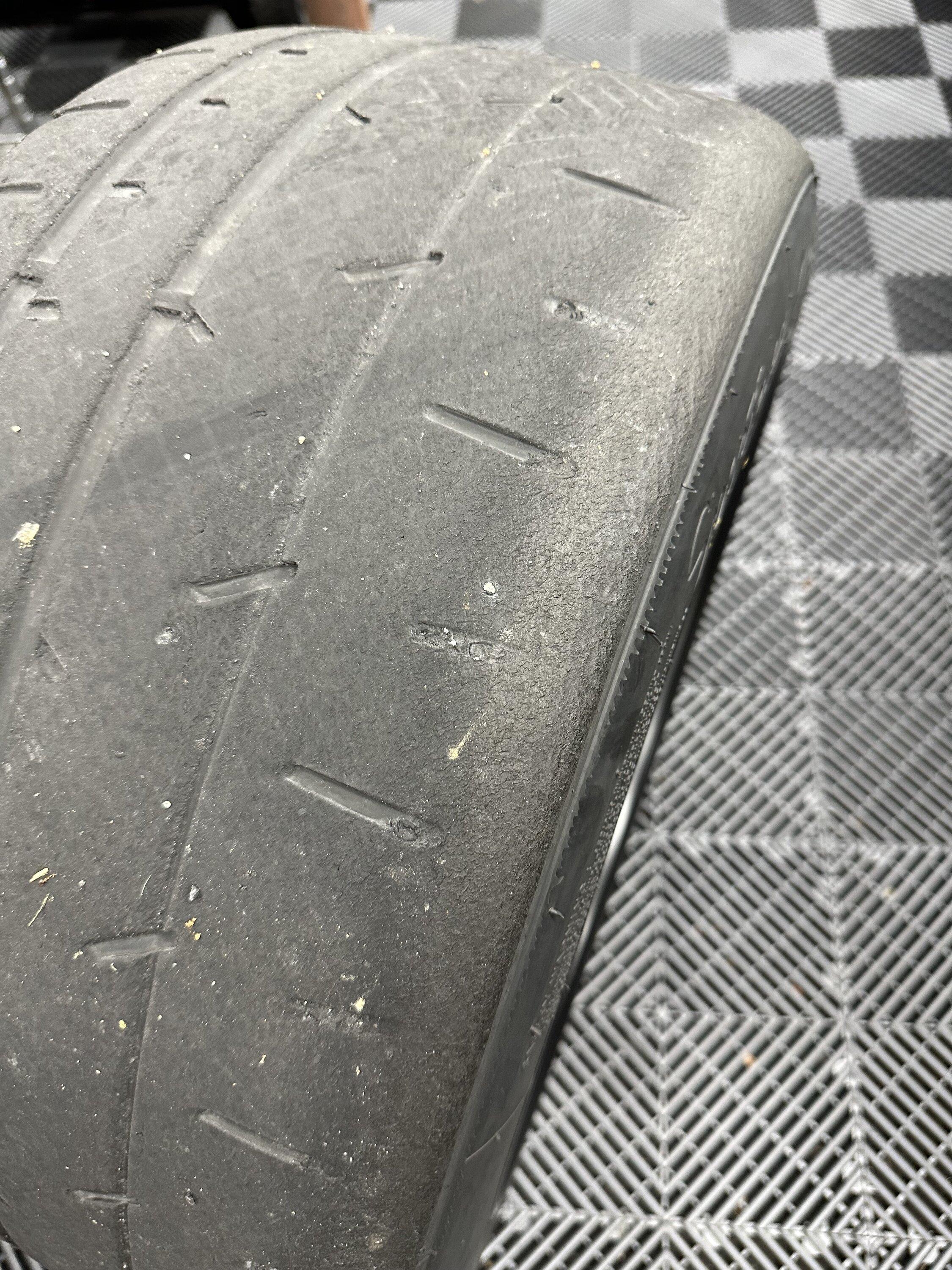

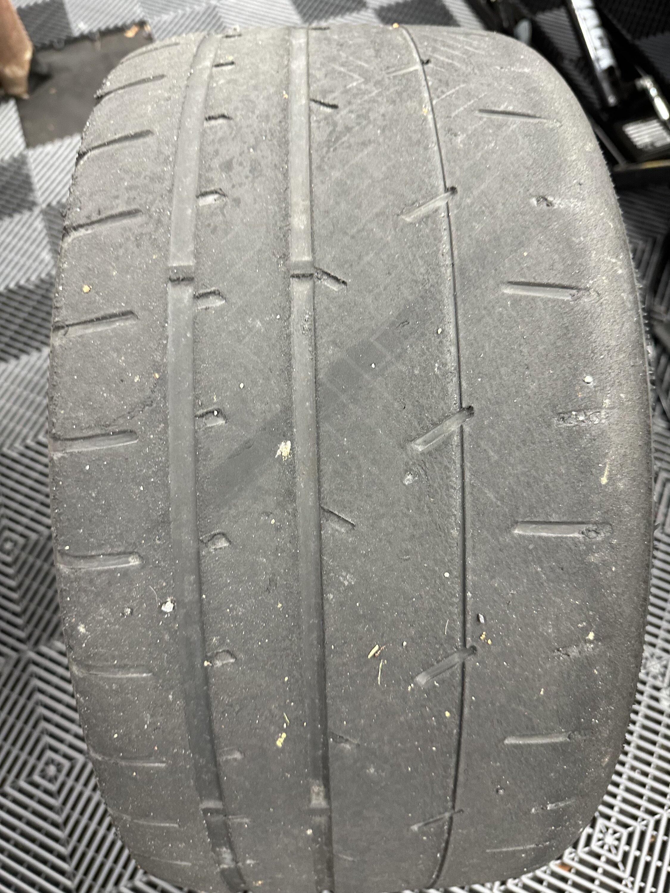

As for the tire wear conversation, I'm very happy with the wear on my CRS. This is them when I pulled them off after too many heat cycles. No complaints.
All four were even.
All four were even.

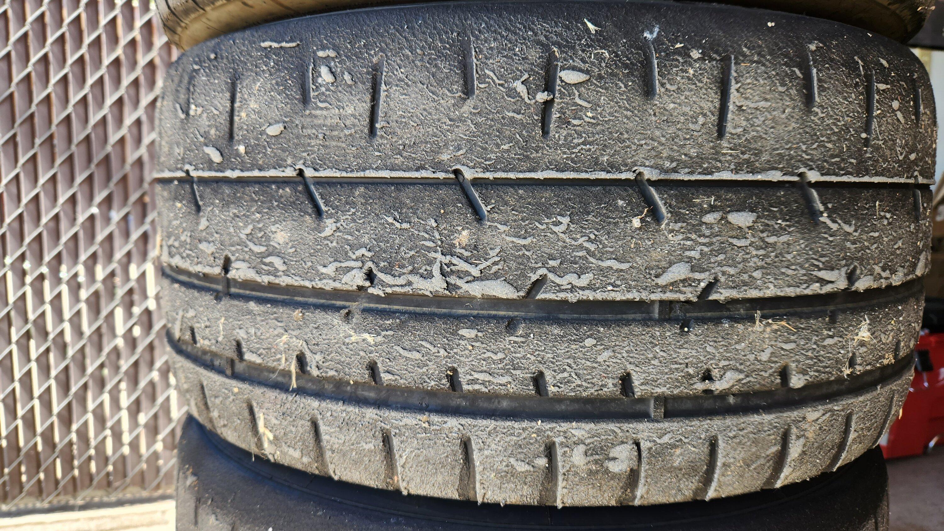

@kaj how many days on that tire?
Here are my V2 after four track days:
