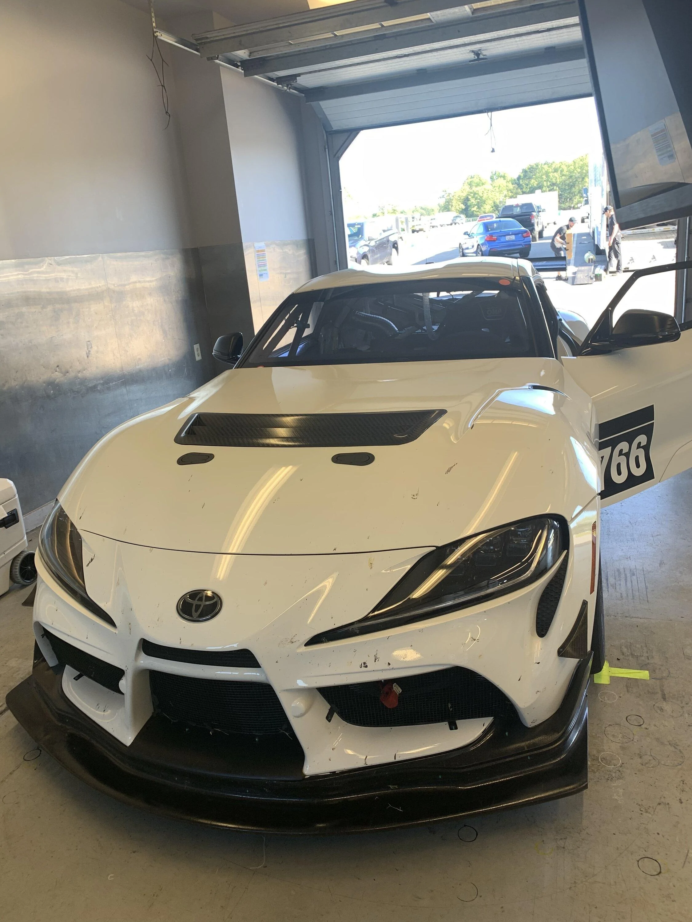

Here are rates and sway bar sizing. Rates are for true coilover rear. I converted to lbs/in for easier reading.
GT4 EVO
Spring set N/mm (lbs/in):
F: 150(856)/170(970)/190(1084)

Are you showing three different setups in the spring rates?
VERY interesting they use less rate in the rear. I might have been on to something this whole time… ;)
Correct. Car comes with 3 different sets of springs.
The rate stagger they run is slightly less than what I usually setup but they’re also on race tire with governed horsepower. If your rate stagger is not less the gt4 amount (100#) you’re on the right track. ;)

OK so sounds like I may run into same issue. I'll plan on maxing out what I can get with the stock struts/springs. Curious what you ended up with though.
I’m sure that mechanical diff doesn’t hurt either.
I currently run 50lb difference 650f/600r

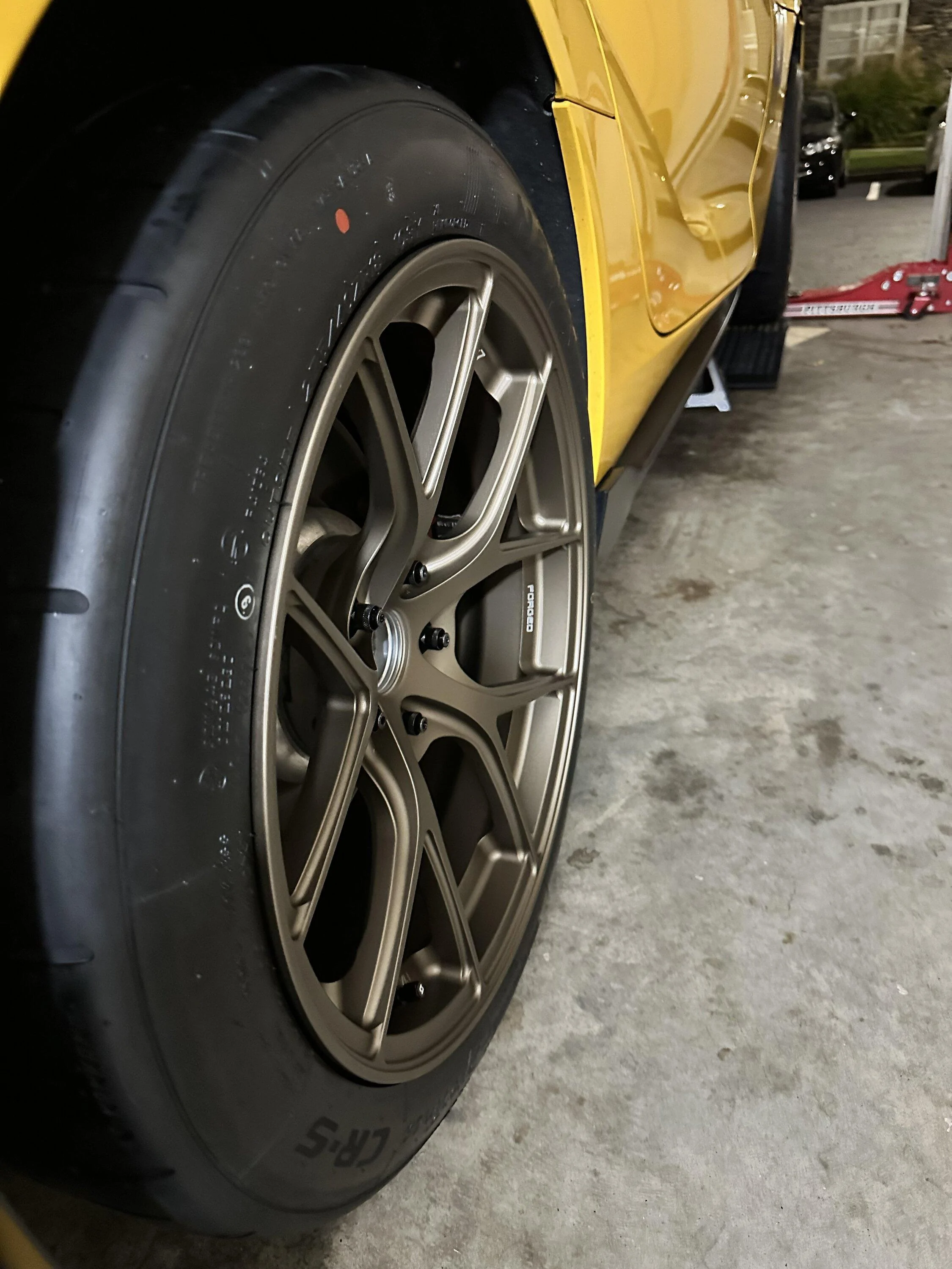

The meats are on! The motorsports hardware studs were a bit sketchy to thread in. The lugs fealt like they wanted to cross thread.
yeah it seems like those studs are always like that.
helps a lot to clean them up with a die before installing them.
I wasn't happy with how they went in nor how the lug nuts threaded on. I brushed all the threads off.. but still.
My install was even less fun as one of the studs arrived with a bent thread. LOL. To Apex's credit, they had a new one to me immediately.
Curious what spacer and length of stud? The wheel looks quite wide for tire. Are those the 10.7 Titans?
8,625
16,910
I think it’s the angle and lense of the camera exaggerating it a bit there, but yea, Titans are 18x10.7 and those are 275/40/18 tires
same tire size on my 18x10.5 for reference
