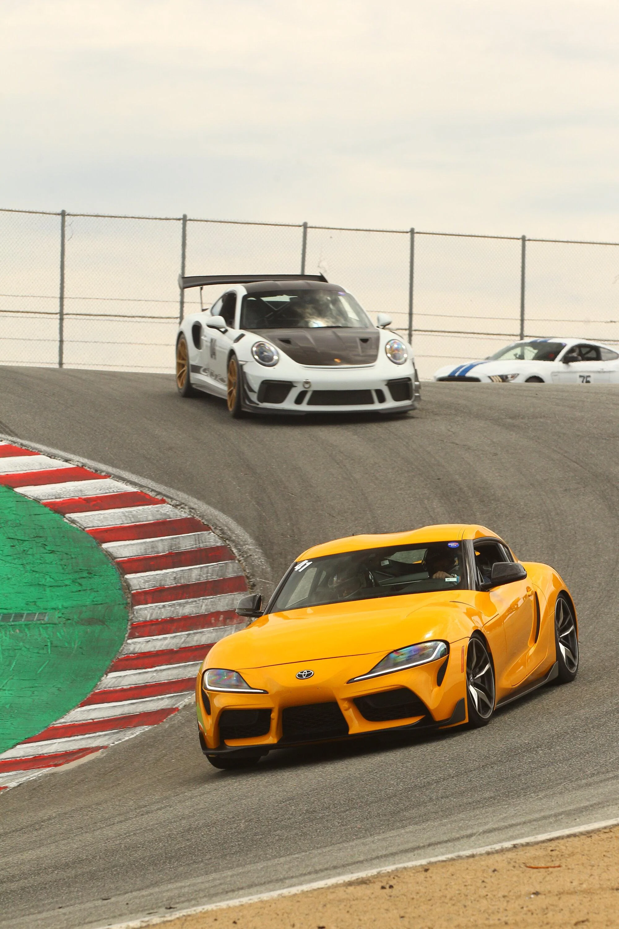

video is up....
frustrating day. SCCA TT were really pushing. green track from all the rain, track was colder and less grip than anyone expected. several offs. two cars bumped and went off. several spins. one crash prob 20k damage brand new GR 86
I was too cheap this time and thought i could squeeze one more aggressive TT day out of heat cycled out CRS. I was ice skating all over. could not turn, put power down, or even brake like i can there. was over second off PB and 2.5 seconds off where i should have ran. oh well i survived.
had fun w some friends in the advanced fun run sessions after i gave up on TT until.... i sheared a grade 10 bolt in my race seat. was leaned back and sideways trying to make it back to pit!!!
Holy sheeeeeee…. ? That track looks like so much damn fun! I was watching that Porsche thinking drive off, drive off, drive off…. He didn’t drive it off ? I’m sure you were thinking (watching) the same thing ?. Good avoidance!
Yeah, sucks when you loose that confidence in your tires (or car) & not due to track conditions. Great call to dial her back and just make the most of it. That’s all feel. You can see it in your driving. Well dun Rock ?

These cars are ridiculously capable right off the showroom floor. This was me the morning after I bought mine ?
