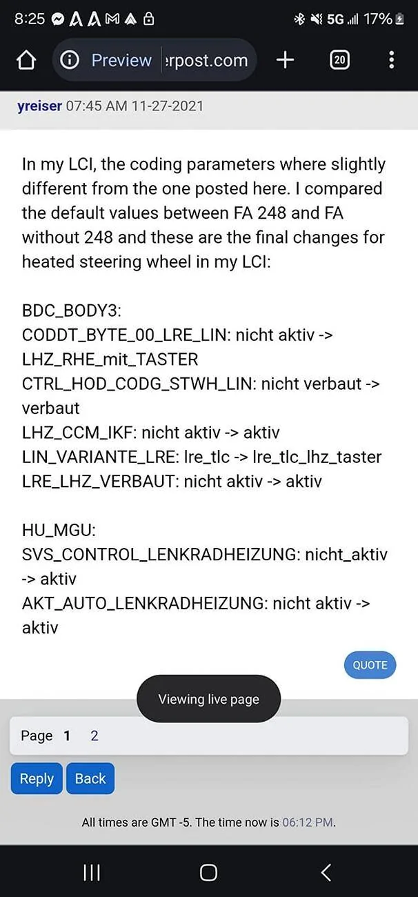

A few days ago I came across this post: https://www.supramkv.com/threads/mkv-supra-g8x-lci-steering-wheel-retrofit.25162/post-396766
I opened up the linked facebook page, and the OP had retrofitted a G series heated steering wheel to his car. He said it was as simple as connecting it and then entering the following codes using Bimmercode:

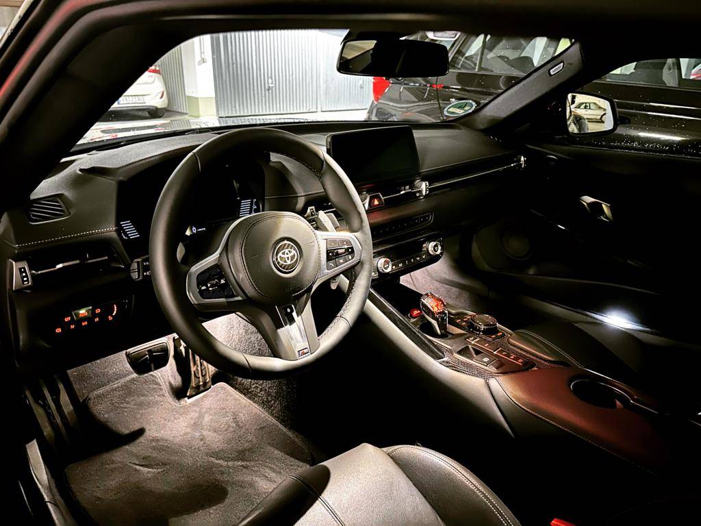

I have it working since almost 1 1/2 years.
With all buttons and heating working.
Ah shit, that's so dope bro!
Would you say the instructions listed above were sufficient to enable the heated steering wheel functionality?

There’s also a hidden setting in bimmercode that will auto turn on your heated steering below certain temperature. So if you get a heated core steering without the button, this may work.
Your adaptive cruise control is fully functional with the ability to use the gap adjust?

Yes. ??

Hi! Could you please tell where have you got toyota emblem on the steering wheel?
Cookie4u
Richy
Jul 26, 2022
Germany
GR Supra A90
Sorry for the late answer - They are custom made dry carbon plates. I've made the "design" and found a company which produced them for me ?
