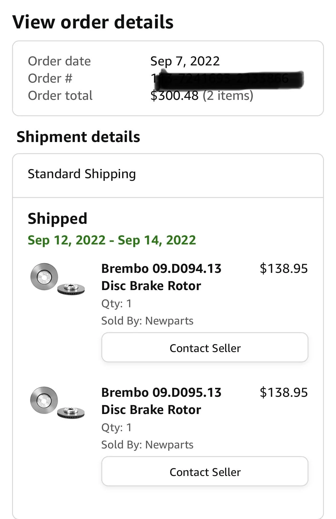

In my opinion, Stock rotor is not cheaper option. Although it is the one of better options. each cost about $250 and is sided, left & right. you cannot swap it otherwise air will concentrate to center rather than dissipate. - negative effect than original design. Cheaper ones such as centric does not have side which means air vents are straight and may not dissipate hot air as stock rotors mounted correctly. - would be better than stock rotors mounted reversed though :D more expensive centric - I thought I saw at rockauto - is sided as well as about same price as stock rotor. with few more $, I would prefer stock rotor in that case.
Also, I would not use drilled rotor on track on any car. last time used it on s2000, cracked it in single 15 min. session...
I'm testing out zimmermann at the moment. price is about same as stock. brake feels good so far /w hawk HP+.
OEM Brembo fronts can be found for $150 each new.
Damn that's a lot more than my MX5 rotors lol. But great info as usual @nibble and @razorlab :thumbsup:
