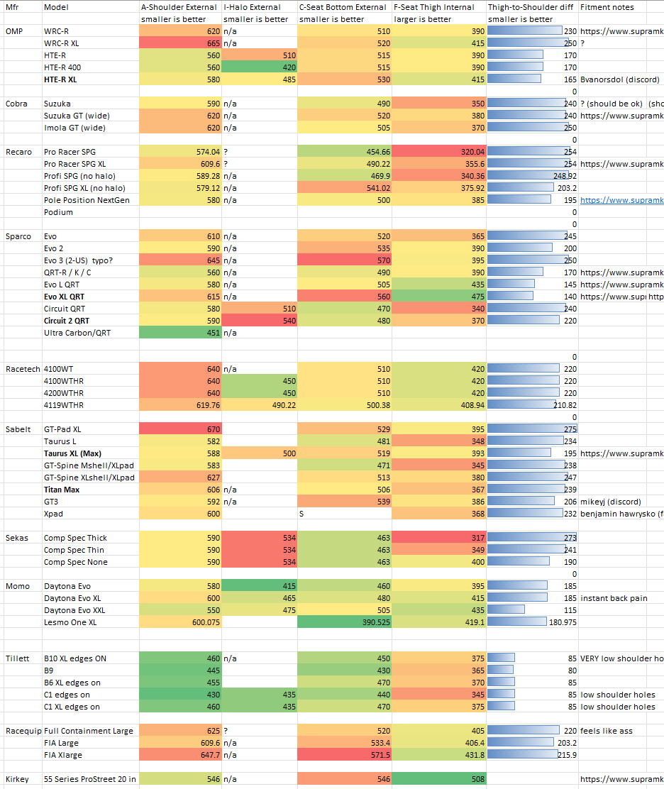

Got annoyed with trying to compare dimensions across different websites, so I dumped all the info into one spreadsheet. Screenshots are pasted in case you want to check other internal/external dimensions.
Shoulder external width limit for the car is about ~625 mm. Haven't been able to find anyone that wasn't able to fit a seat due to the bottom external width.

No Bride seats in consideration?

I haven't been able to find any bride size charts with interior thigh dimensions, and since they are generally sized for preteen girls, so didn't really see the point.
give me a few days and I’ll update with my pre teen girl size seat dimensions. Will agree it’s super tight. Like I can’t have anything in my pockets.
