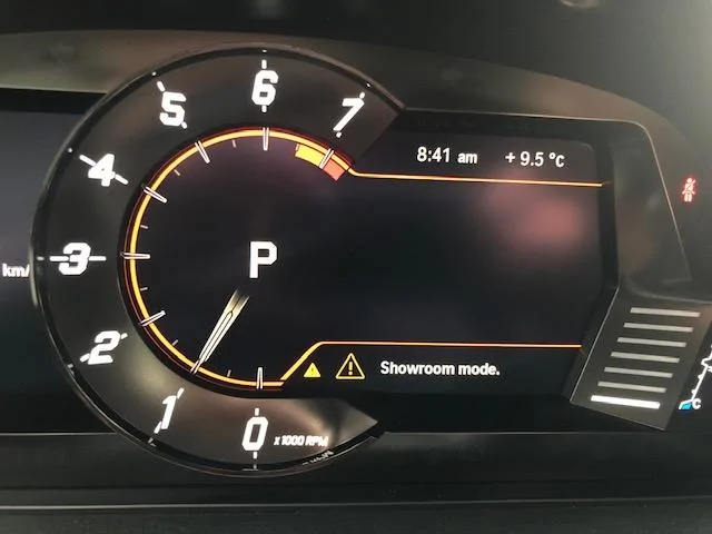

Picked the car up from the dealership and it's showing "Showroom mode" and I've tried to figure out how to get rid of it and no success. Emailed the dealership and they said bring it in and the tech guy will fix it. I would rather save myself the drive if it's a easy fix if anyone here knows how to get rid of it.

Tried that and it didn't work, didn't bring up the same screen that this video shows.

Doesn't show the same options like the video shows, it was the first thing I tried.

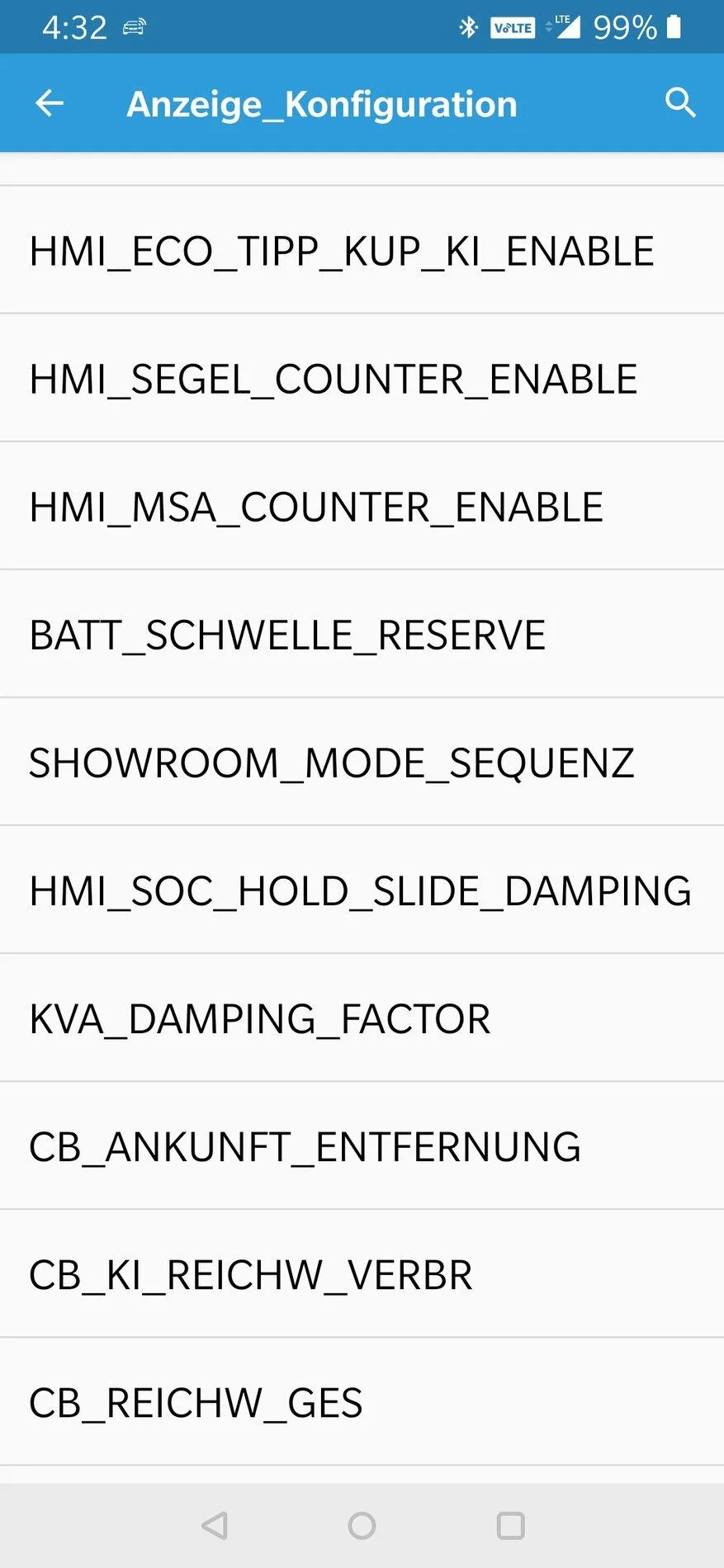

So had it not been for the mechanic who put my downpipe in, I would still have the showroom mode on my dash. My mechanic has his own shop and works mostly on BMWs so he figured it out no problem. He hooked the Supra up and just did a reset and it got rid of it, which supposedly the dealership did as well but it didn't work.
