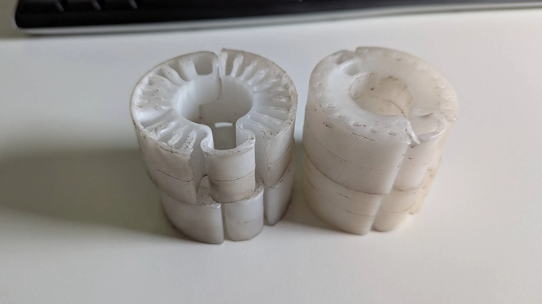

One thing I did discover are these bundles of joy:
At low speeds removing these didn't change things but it might stop the car from twitching when braking at higher speeds. I'll go for a longer drive tomorrow and see if anything this helped.
The car was at the dealership at least 6 times in the past year and nobody noticed these :(

Hi, what is the purpose of those white things? Can you tell us about them?
They are shipping blocks that are attached to the strut springs so that that the car doesn’t bounce up and down and around when shipped and trucked. When I bought my S2000 the idiot dealership didn’t same thing. The car drove like it had no suspension and cushioning.

Oh interesting, where do they come from and why were they still on his springs? Are they attached to the springs or… what did you call it? The strut?

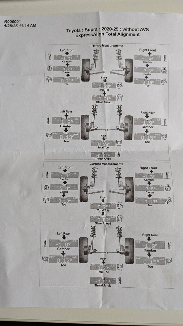

  • Did a few alignments. Helped a bit. I've attached the last one.
Ok, I took the car on a long drive over the weekend and oh boy, does removing these make a difference. It's a different car! It's softer and more planted under braking.
So, I realized I had two issues which I though were connected but they weren't. The first was the fact that the steering wheel is tracking the road when I tapped the brake and the road was bumpy. The other was the car twitching when I would press the brakes if I were over a certain speed and if the road was bumpy.
Removing these from the car didn't do anything for the first issue but it completely removed the second. This makes sense to me because these limit front strut's range of motion. At certain speed and when braking, the front gets loaded and front struts basically become ineffective. Every bump in the road then sends the car flying and it felt like the car was trying to kill me.
