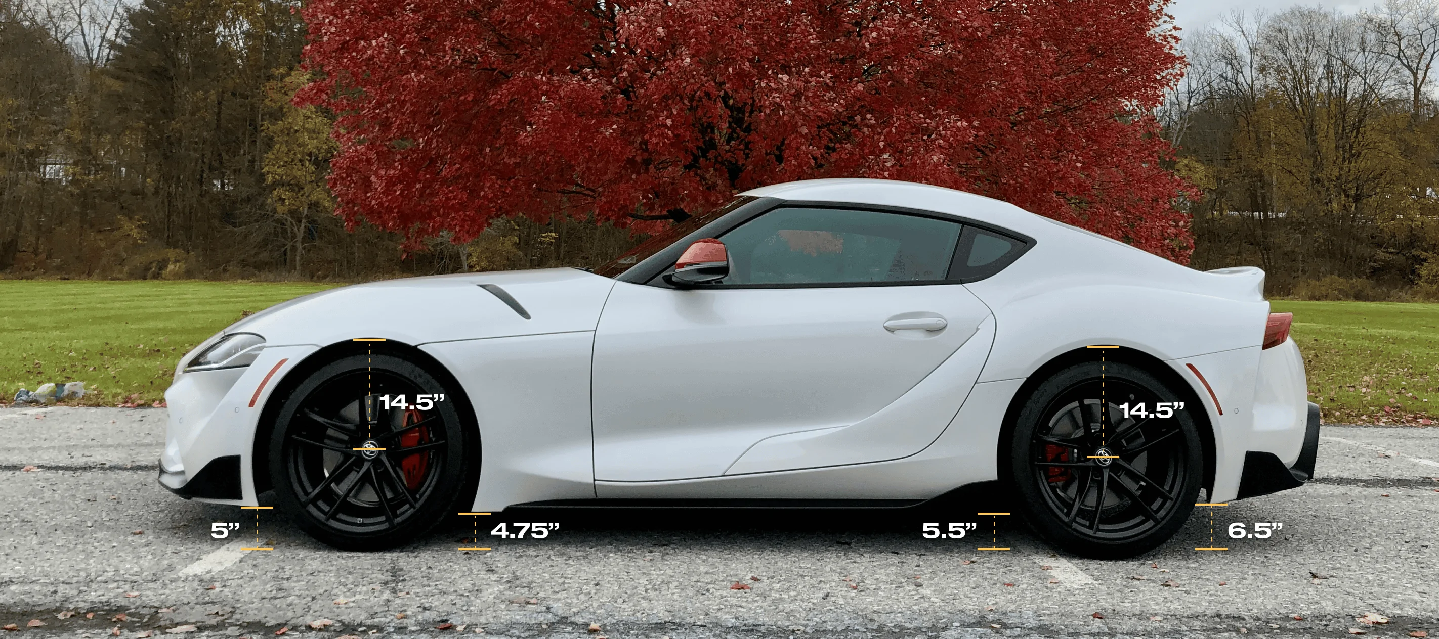

If you measure center to fender it doesn't matter the tire size. Also, the suspension geo doesn't change with tire diameter differences. Geo only changes when you actually lower/raise the car with the suspension components.
I'm currently at 13.75" front and 14.0" rear. OEM is 14.5" center to to fender all around.

Measured mine when it was stock:

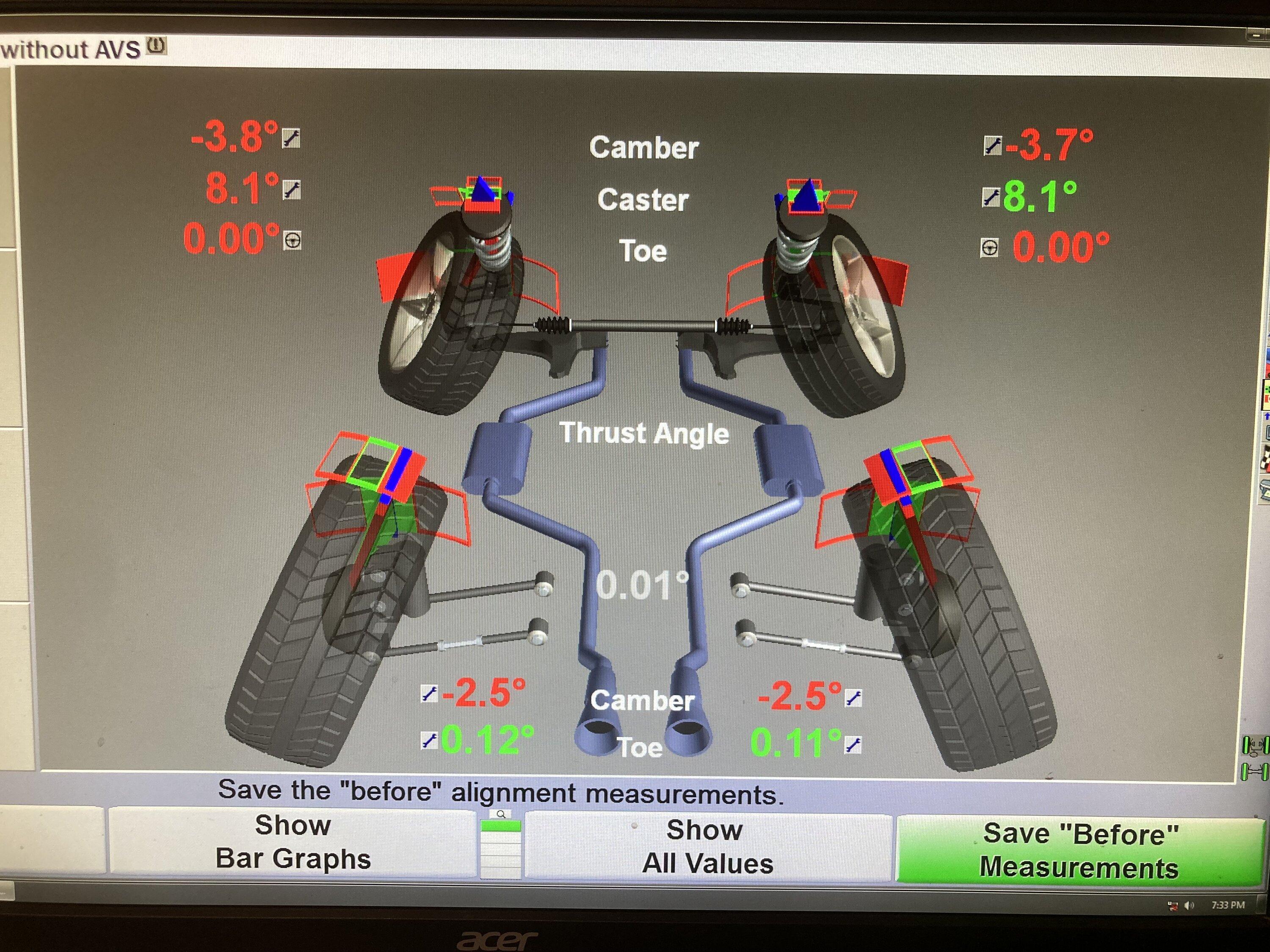

So speeds where I am getting trailbrake oversteer are 40-65mph. Would you say aero helps at those speeds?
edit: Here is my alignment

Alignment added to above post.
Higher speeds seems pretty stable, at least more stable than charging in at the turn in very hard and aggressively trail braking to rotate. I mean aggresive trail brake inducing oversteer is nothing new.. Suspension adjustments you recommended make sense to dial out oversteer. Just want to make sure I have the basics right before trying to correct them.
Under the limit (80-90%) there is no oversteer or understeer. Above that 95-110% limit there is still understeer which is what I try to beat with trail braking.
Tire pressures are 26 cold 32 hot front rear.

Yea I would try dialing it out with what you have currently. Try the Comp/Rebound changes I suggested. I would just do it by 2 clicks at first to see how it feels.
I also run lower tire pressure in the rear by about 1-2psi
