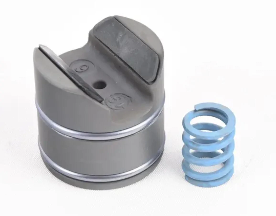

The preload adjustment basically tightens/loosens the nylon bushing in the rack. That is the only thing that would "wear out".
The cap puts more load on the little spring and that spring pushes on the nylon bushing
Looks like this:

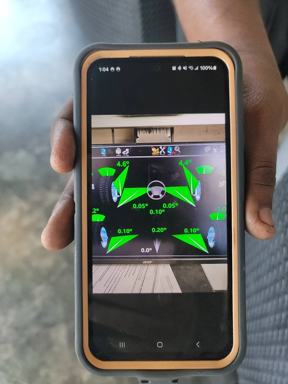

Today I took my car again for an alignment at a different shop, and they didn't provide an alignment sheet because they claimed their printer didn't work. I asked them for some sort of proof and all they gave me was this picture that doesn't even show everything:
Is it me or do those numbers look wrong?
@razorlab
