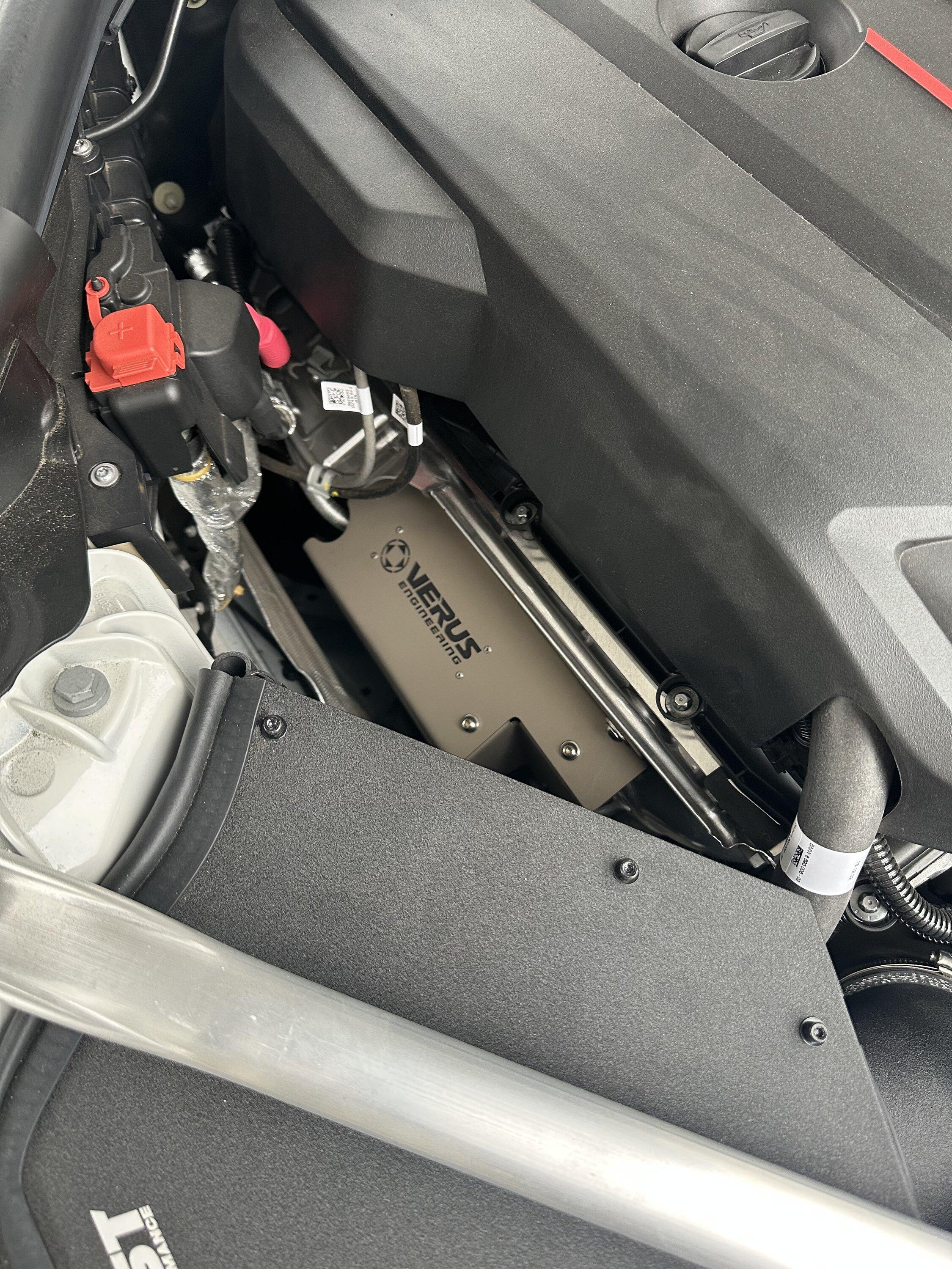

I was actually able to fix the problems I was having, just in case anyone else was experiencing the same thing.
Taking out the factory airbox, you actually take out a heat shield along with it and this causes heat soaking which then gave me my problems.
I put in the VERUS HEAT SHIELD and everything went back to normal.
-burbles came back
-exhaust sounded better
-gear shifting feels aggressive again.
I highly recommend getting a heat shield when replacing the factory airbox for an intake.
