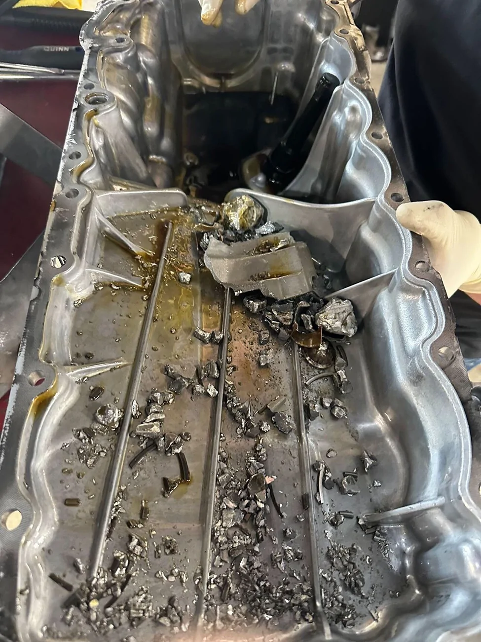

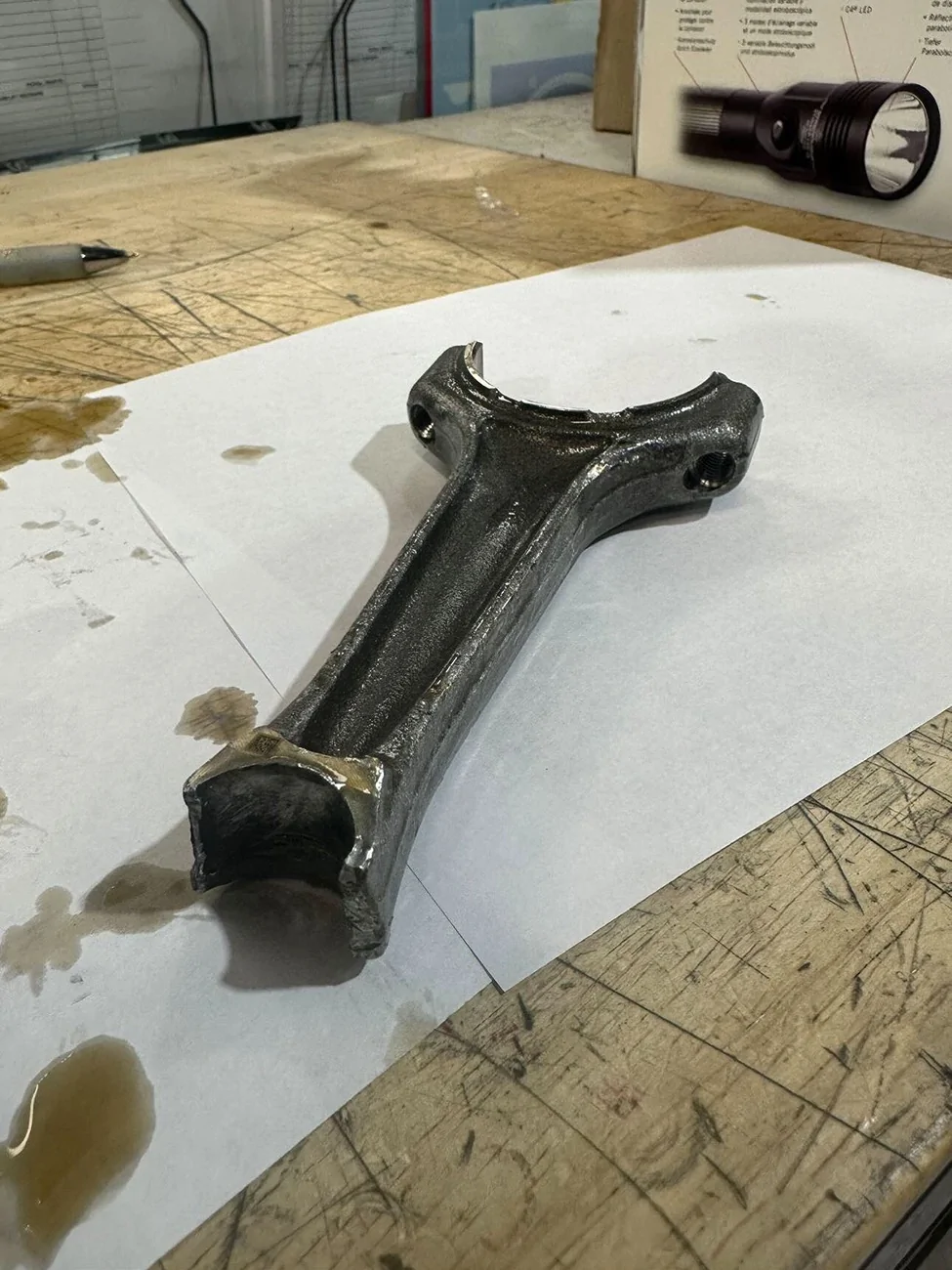

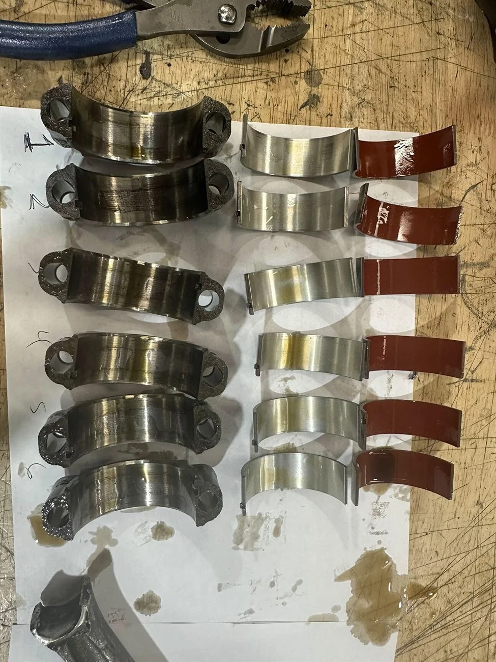

Ok genius. Here’s pictures proving it. But whatever, do what you want. The rods & pistons are a weak point with added horsepower and torque, the slipping transmission that was upgraded left the motor with slap. But kindly try it and prove me wrong. Can’t wait for your $20,000+ mistake.

I can see if you are running high torque and have heavy load on the car at WOT and as soon as the trans slips and the engine free revs, you could potentially chuck a rod.
You can see how quickly things can change in my video of sixth gear leaving the chat and suddenly free revving. Luckily I have a quick right foot from decades of dyno tuning.

Imagine if you were 650+ hp and closer to 700+ torque what it would do, then imagine the automatic was upgraded to handle that torque off a launch, hence my post above. Boom goes the rods. You can see the bearings weren’t the issue, the forged crank handled it just fine. The rods begged for mercy and decided to kiss the block.
Yup, sudden speed change are the rods worst enemy.
