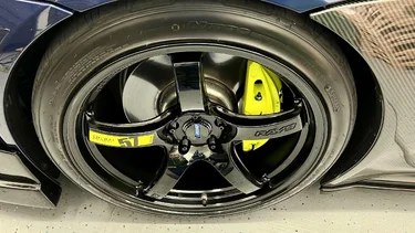

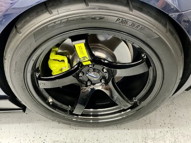

I am considering the same studs from Speed Industry. Do you have a picture of them on your car? Curious how far they stick out.
I just went out and took these, front and rear. Just the generic lugnuts they they sell also, I haven’t decided if I’m going to pony up for the raceseng titanium ones, or any other set just yet.

Thanks! That was really cool of you to do this for me.
