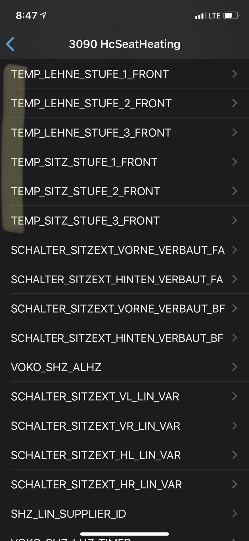

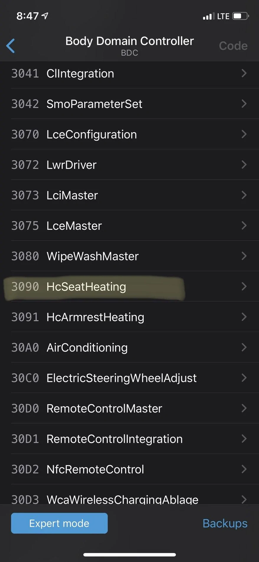

I adjusted my heated seat temps higher under these menus in Expert Mode. I went with backrest level temps in C (35, 41, 50) & bottom (30, 36, 45). 50C is highest selection.
