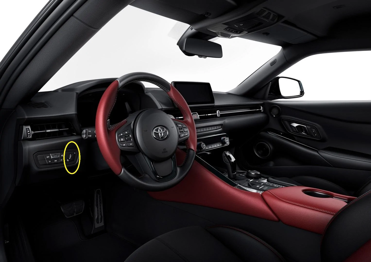

I tried the brightness (dimness) coding this weekend and it seemed to work afterwards. Then the next day i was driving the car, it acted like I never changed anything. The adjustment scroll wheel on the dash does nothing when I adjusted it and the screen was back to it's own mind. Has anyone had this happened? I won't be able to try this again until this weekend. But just incase someone has this experience or know that I did something wrong please reply (????)
I used OBD Link MX with Bimmercode (full version). Was able to change Auto Start/Stop behavior so I at least got that far.
One curious thing - does each change have to be made separately, i.e. can't combine several things in one "coding" step?

I coded the head unit brightness awhile ago as it was way too dim and not visible during the day....I'm still able to control both head unit and cluster display brightness using the thumbwheel control...Coding the headunit had no impact on brightness of the instrument cluster which I found to be sufficiently bright even during the day...
That said, I keep the thumbwheel control at max and never feel the need to change the settings for both day and night driving....

Not so. Changing the code in the head unit simply provides for a brightness control located on the headunit and accessible via the DISPLAY settings. It does not disable the instrument cluster brightness control.
There is, also, coding which isolates/de-couples the cluster from the headunit thereby allowing for independent brightness of the cluster as well as the headunit.

Couldn't wait until this weekend. I went back into the head unit ECU tonight after work and found that "DIM_VARIANT = old" is still there, which is the setting that solves the problem with dim screen on the head unit. It turned out (silly me) the brightness setting after the change was made has to be adjusted via the menu (touch screen or controller on center console), but not from the thumbwheel on the dash.
In fact, 30MilesOffShore is correct, once this setting was done the thumbwheel has no effect on any brightness adjustment, be it instrument cluster or head display. Someone mentioned these two brightness adjustments (inst cluster and head unit display) can be decoupled but I don't know how.
