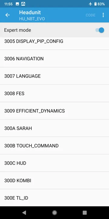

I was looking for other codes and came across it today under Expert Mode. I didn't test it out but I grabbed a quick screenshot. Not sure if it will work for you but to get to it go to:
Headunit >> Expert Mode >> 300C_HUD >> HUD_Turnsignal >> Default Value Showed nicht_aktiv (not active)

I was in expert mode today looking for other things and did come across it. I didn't try it out but I did see it. You have to use the BMW App to make it work.
Headunit >> Expert Mode >> 3006_Navigation >> Up Top In The Search Icon Look For "Lap" >> M_Laptimer will show up >> Default Value Showed nicht_aktiv (not active)

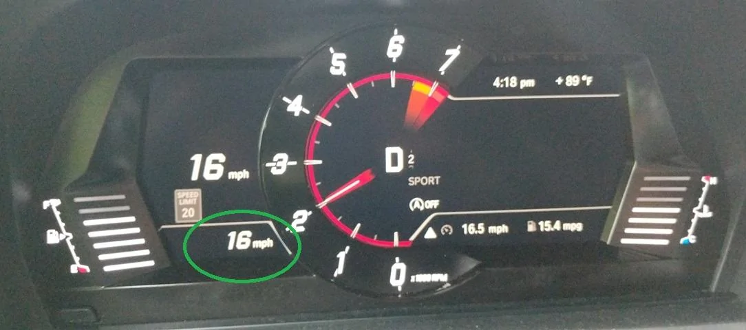

@Guff were you able to find anything under the Instrument Panel options? I turned on the MPH on the mini-computer board and it worked but it looks redundant to see the speed twice. I did like the bar above it as a guide to divide the gas tank in half for quick reference.
I wouldn't mind seeing some other sort of info there such as digital temp or digital tach. Have you come across anything?
Haven't dived too deep into it but I'll look at more of the options later
