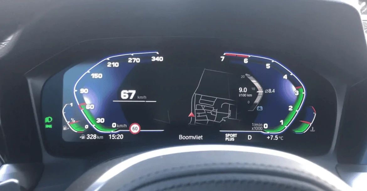

Has anyone tried the “Alpina Display” option? Does it do anything?
30MilesOffshore
Jan 27, 2020
50
457
401
Charlotte, NC
I was curious about the Alpina Display but chickened out because I didn't want to screw something up and not have it revert back to normal. I believe this is what it looks like.

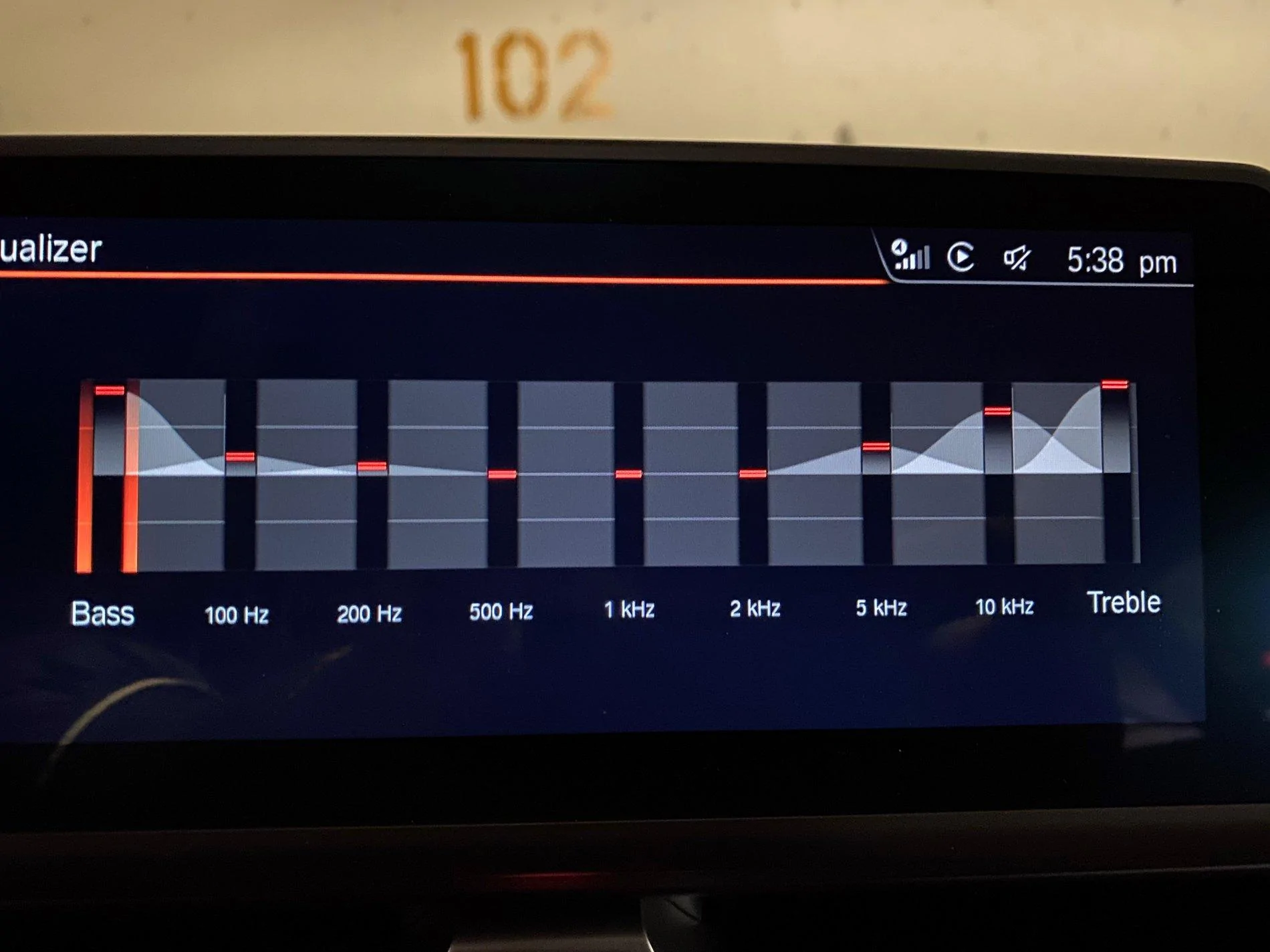

I'm not near my Supra right now, but basically what they call the "rock" setting with high treble and high bass, but bring the vocals (the middle section) to zero. It's basically the "U" shape profile that I prefer, but everyone has their own favorite way so each person has to play with the different settings. You will hear shockingly better sound because the high's and low's are emphasized but the tinny vocal sound is minimized. This is the same sound profile companies like Beats use for their sound profiling. I will take a picture of my setting in the Supra later and upload it to show you.

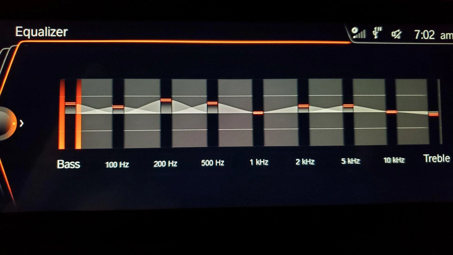

Using bimmercode to remove ASD will also reset EQ back to zero and clear preset buttons...EQ will need to be re-adjusted afterwards...
The Active Sound Design feature is only active in Sport Mode and electronically overlays a low freq noise (to simulate engine / exhaust rumble (when in sport mode)) onto the audio signal which muddies / distorts bass response...Once ASD is removed bass is punchier and more distinct while driving in sport mode...
I avoid "canned" i.e. rock, jazz, etc... EQ presets...I always adjust my EQ by ear to take into account environment and hearing along with music preference...
Here are my current EQ settings...

This is the equalizer setting I use. Again, everyone has their own taste but this produces strong high's and low's and create an illusion of a vibrant music similar to the profile being used by the Beats brand of headphones.
