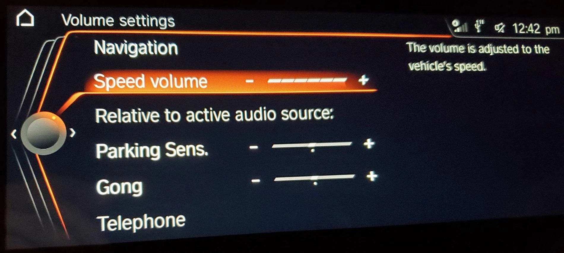

The codes I'm waiting for are the Brake Force Display and also how to Boost Amplifier Power. Supposedly on the Z4, there is a parameter where you can select whether the car is a convertible or hardtop, which will raise/lower the output of the radio system. Of course we currently have hardtop setting enabled, so changing it to convertible setting is supposed to help give the stereo system a bump up in power to help combat the noise associated with having a vert.
Isn't this similar to what we have already in our Supra in the audio settings where you can select volume increase levels relative to speed / road noise?
Your not suggesting this actually raises overall max power rating of the power amp...correct?

tadda, I've been trying to dig that information up to be exactly sure. I came across a thread on a BMW Forum discussing this but can't find the thread anymore so I was hoping someone would chime in with any info or clarification.
The reason why I mention this is I've owned other Verts that also had the feature which increases audio level if top is dropped and functions similarly to sound level feature relative to travel speed found on most other vehicles these days that compensates for road noise....
Sounds like Z4 vert has similar feature....
