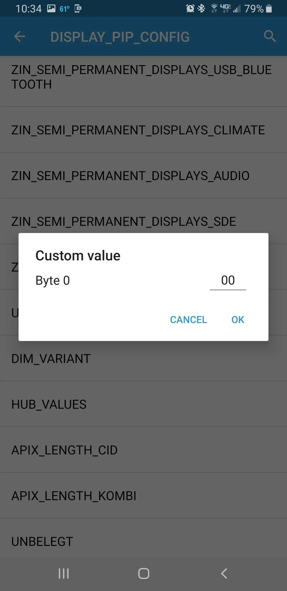

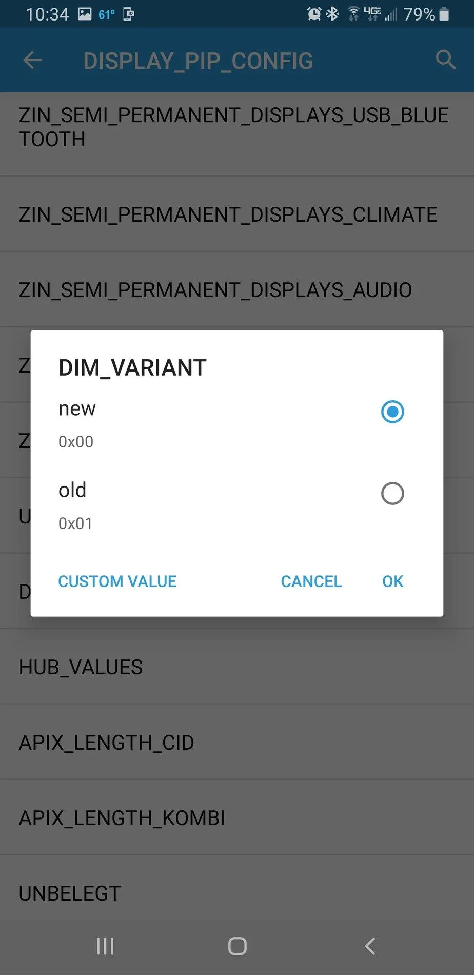

So I attempted to alter screen brightness during the day. I go through the directions but do not know what values to change. Can someone help me out? See attachments

The “old” option made the screen stay bright for me. The downside was it stopped dimming at night and stayed super bright so I reverted back to the “new” setting

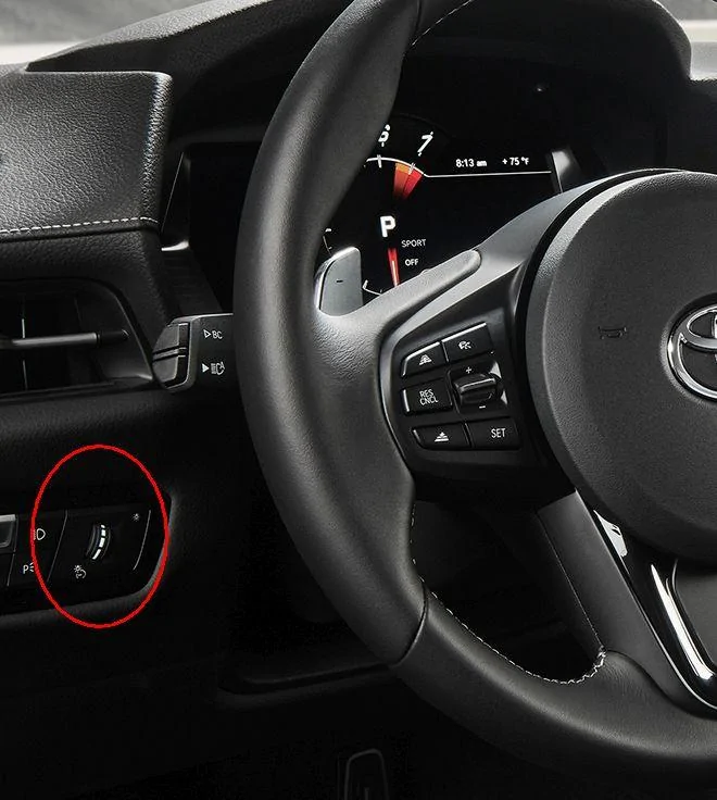

I programmed mine with old option and it can be dimmed at night so it's not so bright...
Did you try using the console illumination wheel (show in pic below) to reduce illumination at night...this works for me very well...

Hm, I haven’t tried using the dimmer wheel. I was hoping that the screen would automatically dim if the headlights engaged. That also dims all interior lighting as well no?

Yes it slightly dims the display as well but everything now seems to share the same brightness level at night...
I just couldn't stand how dim the info display was during the day...In some instances I couldn't even see the display...now everything is clearly displayed during the day and I have it set so it's fine at night as well...

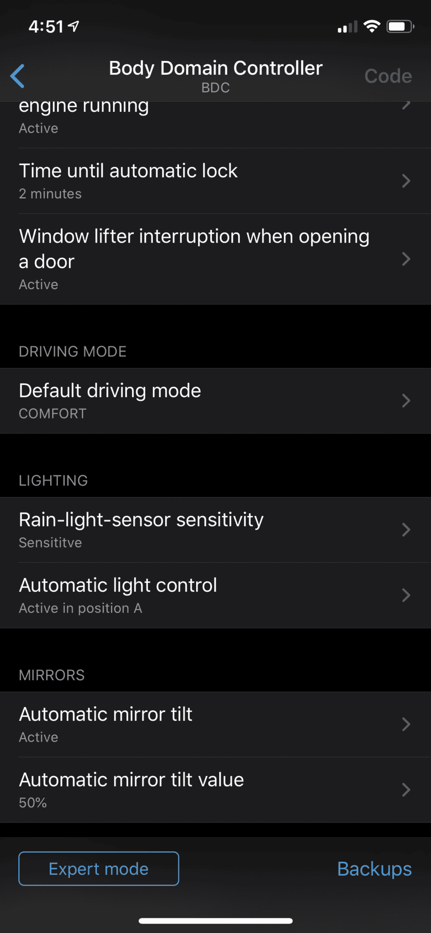

Hey guys the Body Domain Controller is now available under Z4! I have coded Sport Individual Mode as default driving mode & reverse mirror tilt to 30% which makes it useful! I believe there are tons of options to change now in Expert Mode if anyone wants to tinker!
