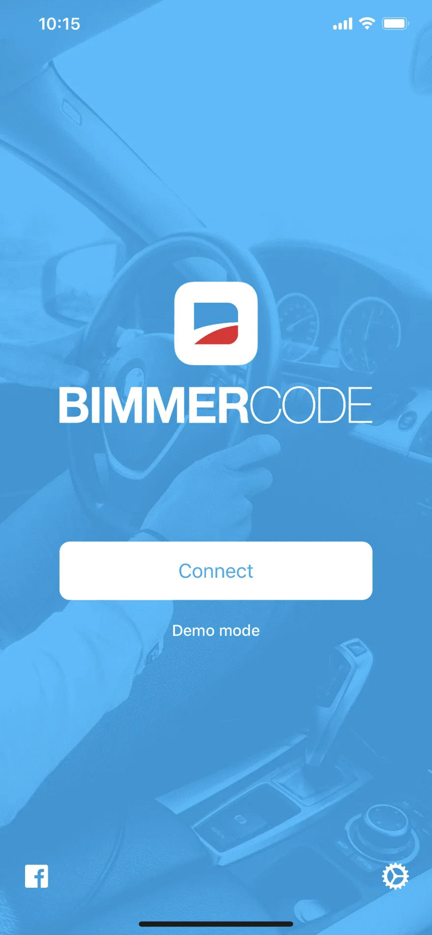

I haven't checked these out yet. Which menu and settings did you have to use for these?
i just went down all the modules individually and selected what seemed interesting, i did select the z4 setup and not the supra option in bimmercode

Yup! Coded the same things. Watched @CarGuy11’s video on YT.
Got the https://www.obdlink.com/mxp/
Downloaded BimmerCode and BimmerLink
BimmerLink you can use to clear error codes. When I removed my OEM seat to test fit a racing seat I got a driver restraint warning. BimmerLink easily cleared it instantly.
The codes I did were:
-Auto On/Off memory is on
-Active Sound Design is off
-Seat belt wind chime is off
-Start up warning off
-Backup camera warning off
-USB Video is on
-Daytime LCD Brightness on
Go to EXPERT MODE, select PIP CONFIG then DIM VARIENT
An important one for me was brightness. I turned off Brightness at Night so it’s just overall brightness day or not. MUCH more visible with polarized glasses.
