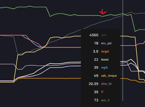

Something weird is going on, you're underboosting by quite a bit (requesting +5 but only getting +1). the PID seems to not add anything to your FF curve despite being on and set to 20. Auto shift redux is non-zero, so I don't think it's the MT logic kicking in.
V28+ has no shift redux, but MTs don't have it anyway. I am actually testing MT shift redux with Terry this week.
You are looking at dme_bt, not ecu_psi. MTs need to underboost. ecu_psi+target=boost

Right, however,
This is a hard equation as the returned variable (and is always true):
target - boost = ecu_psi
and this is a targeting equation:
dme_bt + target < boost - 1psi
yeah for the DME's PID on AT cars, no such logic in JB4.
Look at calc_tq, he is at the torque target the entire pull
ecu_psi technically 2+ psi below dme_bt, calc torque is still at target. MTs are weird dude lol. Given Aux3 (max 80), the turbo is at 91% WGDC total and shows slight oscillating behavior which would indicate its at its desired target.

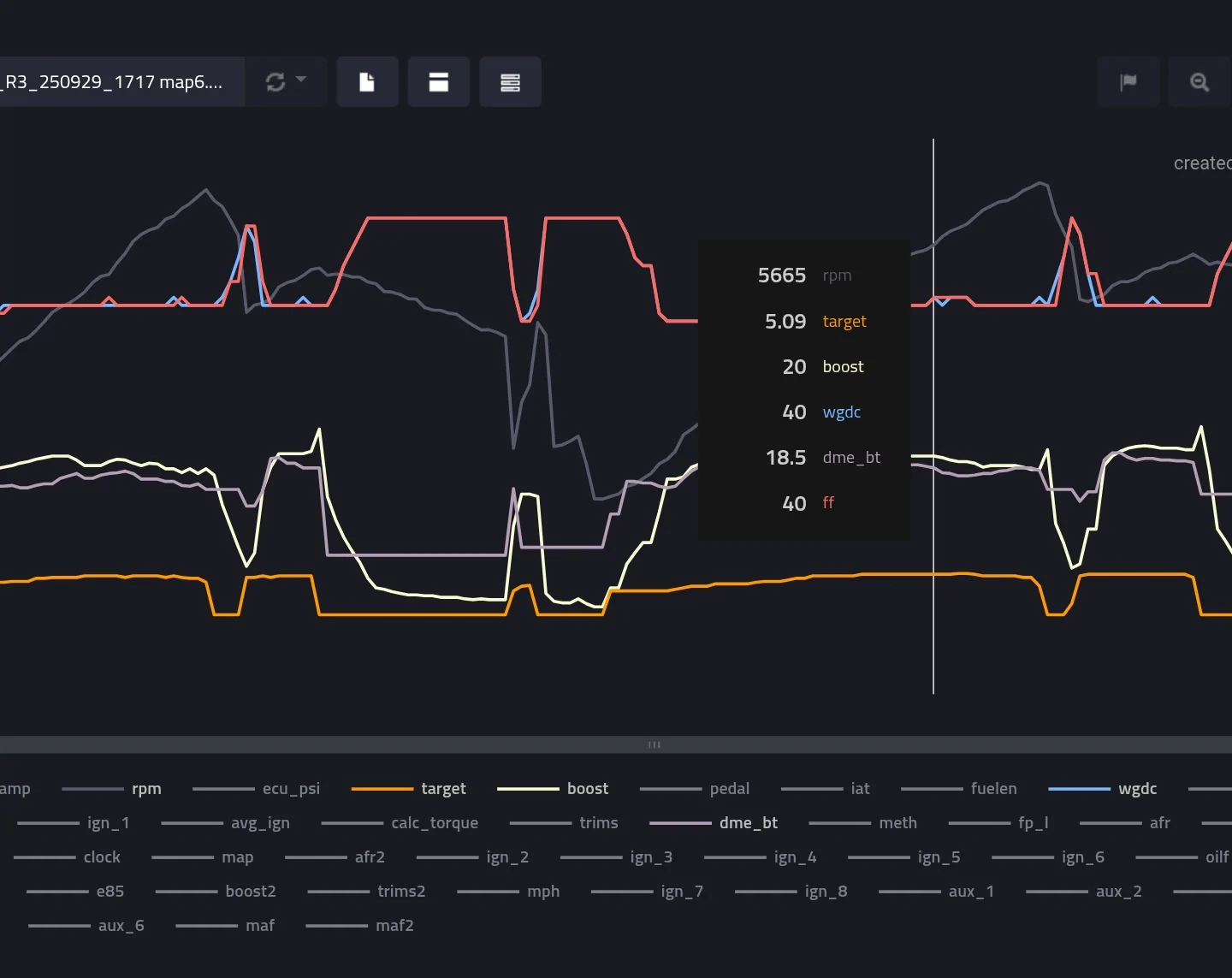

Both look fine to me. If you have a dragy or something you can verify which is faster. Map 6 is only 1 psi more so it shouldn't be anything drastic anyway.
Pardon me for the potentially stupid question, but it looks like its pulling lots of timing on map 6 and not on map 2 what parameter is tripping to do this?
I do not see any significant timing pull on either map. Remember Ign2-6 are the corrections on this firmware.
Ok so if I'm understanding correctly ign2-6 would spike if timing was pulled?
