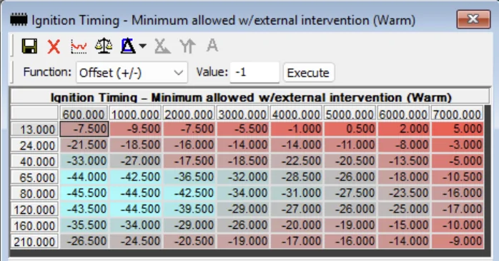

For reference, here is the ignition retard table the DME uses during intervention based on TC and/or tire slip. It's a bit aggressive for the S58/B58. It's one of the first things I fine tune on track tunes.
