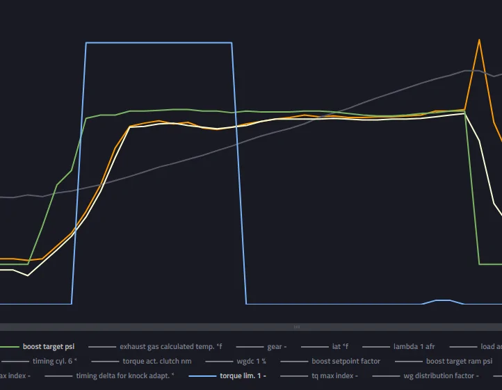

    • Seem to be hitting a tq limiter or something at lower rpm that keeps it from hitting boost target under 4000rpm, but don't feel it. perfectly smooth. Any ideas @razorlab ? 😂 https://datazap.me/u/coloneladama/log-1764180713?log=0&data=3-4-6-17-43&solo=43
But yeah, glad I finally made the jump. NGL, was nervous about the whole unlock/flash process (obviously, why I ran JB4), but no regrets! Will play around on OTS maps for a bit, then give E50 JB4 BEF a try, then next year will try to do my own MHD custom map.
Lol, I told you about the clutch slip protection on manual cars and there you are with a Torque Limiter 8388608, clutch slip protection. ;)
Once you get to custom tuning, happy to help you out!
Awesome, thank you! Does it mean there is actual slip or just to prevent it? Looks like load is held flat.

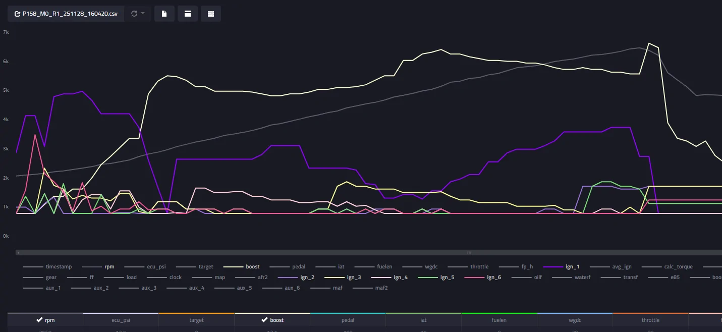

Hey guys, new member here looking for some initial feedback on my Map 0 and Map 1 logs.
Bone stock 2026 MT, 91 octane, located in Colorado so air density is absolutely pushing the compressor into a less efficient part of its operating range. This is on a JB4 with the fuel pressure add-on and an ethanol sensor. I have access to consistent E70.
Log is 4 pulls, two on Map 0 (forgot to turn TC off) and two on Map 1 (with TC off).
I'm a little unclear on where my FF and any other parameters should be set, as this thread has spanned a few changes in JB4 firmware so I'm not sure what information is current or out of date. I'm seeing some pretty substantial throttle closures in all the runs, and timing is... strange. Saw a comment mentioning that the way the JB4 reports timing has changed, so I want to make sure I'm interpreting the data correctly.
This is my first time playing with a piggy back system, but I've got a fair bit of experience on standalone systems (Megasquirt, Haltech, Hondata).
https://datazap.me/u/nick470/log-1764101344?log=0&data=1-4

Huge throttle closure can traction control kicking in. Set FF to 30 (FF is saved PER MAP) and try again.
Map 0, traction off, FF set to 30: https://datazap.me/u/nick470/log-1764371906?log=0&data=1-4-11-20-23
Map 1, traction off, FF set to 30: https://datazap.me/u/nick470/map-1-mkv-supra-mt?log=0&data=1-4-11-20
I'm a little surprised that the mid-pull FF shows at 39-40 in both logs, I had to go back and double check in the app but the FF is indeed set to 30 for both maps. Throttle closures are reduced, but had a dip to 70s around 3500rpm in Map 0 and some more substantial dips in Map 1

boost control is fine, just try to get your octane up
nick470
Nick
Nov 25, 2025
Colorado
2026 Supra MT
Can you clarify on how the JB4 reports ignition timing in the current firmware? I see Ign_1 is showing higher values than 2-5, which are decently correlated. On others' logs, I'm seeing all 6 are showing more similar values.
Additionally, am I seeing octane limitations even in Map 0? Or is this timing dip around 4500-5500 (in ign_1) something else, VANOS or otherwise?
If my local 91 is presenting limitations even in map 1 on a cool day (~50-60F air temps), I'm thinking I have 3 options:
1) stick with stock/map 0 for pump gas and just go straight to figuring out what the car is happy with on e30ish.
2) Put together a very mild map 6 for 91 and feed the car corn until its happy on map 1 or 2
3) play with spoofing a high IAT to get the car to pull timing and add fuel
ColonelAdama
ColonelAdama
Adam
Jan 30, 2023
1,493
1,721
Greenville, SC
All good options, you are on the right track.
