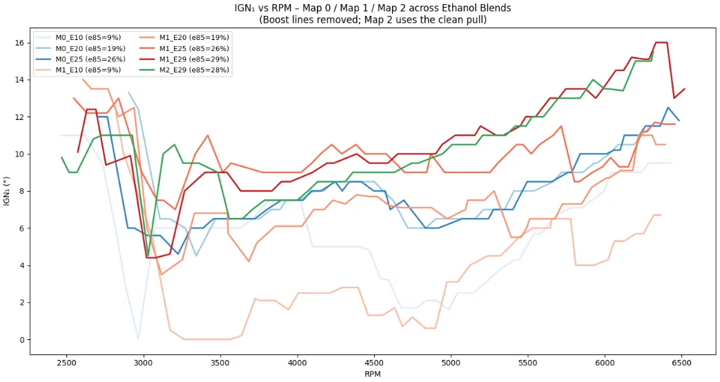

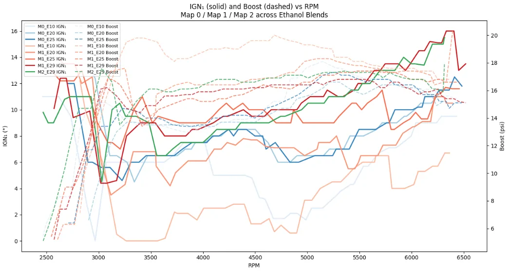

Compiled the data from a bunch of logs on different E content to capture timing convergence in ign_1, which seems to be my best indicator of how happy the car is with the octane.
Map 0: great correlation in my E20 and E25 runs, but there's a big step between E10 and E20. Need to try E15 to fill out the data and find the actual point of convergence.
Map 1: improvement between E25 and E29, but the E29 timing looks near perfect. Will try E35ish to confirm. Interesting that timing here is a fair bit higher than the Map 0 E25 pull. The DME appears to favor advancing timing vs adding boost. The second graph shows boost stuck on a second y axis. A bit more cluttered to look at, but it demonstrates that the response to insufficient octane is to pull a bunch of timing and add boost, possibly to chase torque targets?
Map 2: also looks pretty dang good on E29, although timing is a bit lower than the Map 1 E29 pull <5000rpm, also interested to see if any changes are observed bumping up E a bit higher.

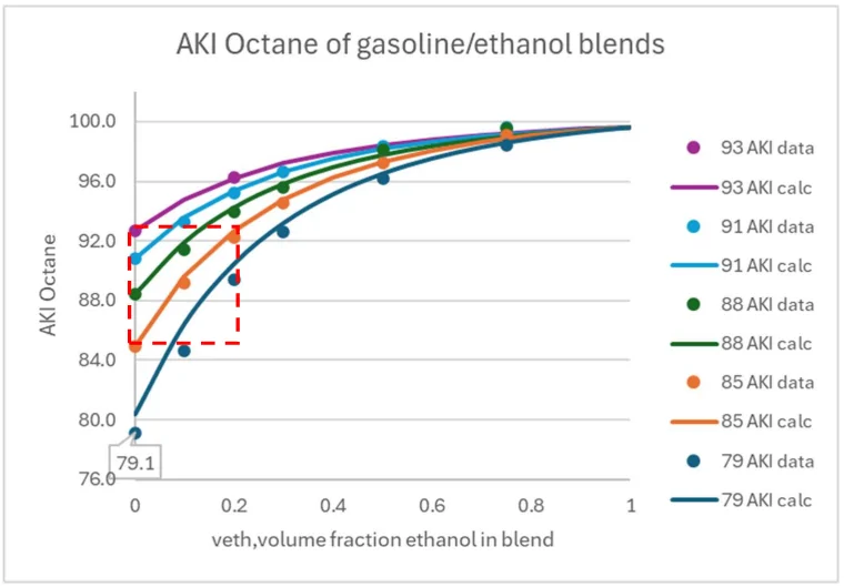

So, what does this say about octane needs? Effective octane has a logarithmic relationship with ethanol content; you get a bigger jump in octane going from E10 to E20 than you do going from E30 to E40. So calculating as if the relationship were linear, as I have done in the past, might get you a decent estimate but not all the way there.
source: https://ethanolrfa.org/file/2967/Octane Value of Ethanol_Hoekstra_2025-06-24.pdf
With my 91 octane being e10, the base gasoline octane is likely ~87 AKI (R+M)/2. So, in my case:

Stock, the car appears to want ~92oct. Map 1 wants ~94, and Map 2 wants ~95.5. Couple things to note here: octane ratings at the pump are minimum values. If you have "good" gas, it's likely that your octane is a bit higher than what is shown at the pump. If you have shit gas, it's probably right at that value. Additionally, I'm at 5000ft+ elevation. Compressors (the intake side of your turbo) operate on pressure ratios, NOT nominal boost values or even absolute pressure. Pressure ratio is absolute pressure/ambient pressure, or (boost + ambient pressure)/ambient pressure. I wish we had a published compressor efficiency map for the stock turbo, as it could provide some good insight into its operation and also better flag when the turbo is getting pushed outside of it's efficiency range. All else equal, my turbo's limits are lower than at sea level, and it'll push into heat generation instead of air density increase at lower boost levels - which increase propensity for knock.
So don't take these values to be absolute truth. They are applicable to MY car, in MY ambient conditions. MT cars in Colorado will likely see similar results. Everyone else, consider these just reference values.

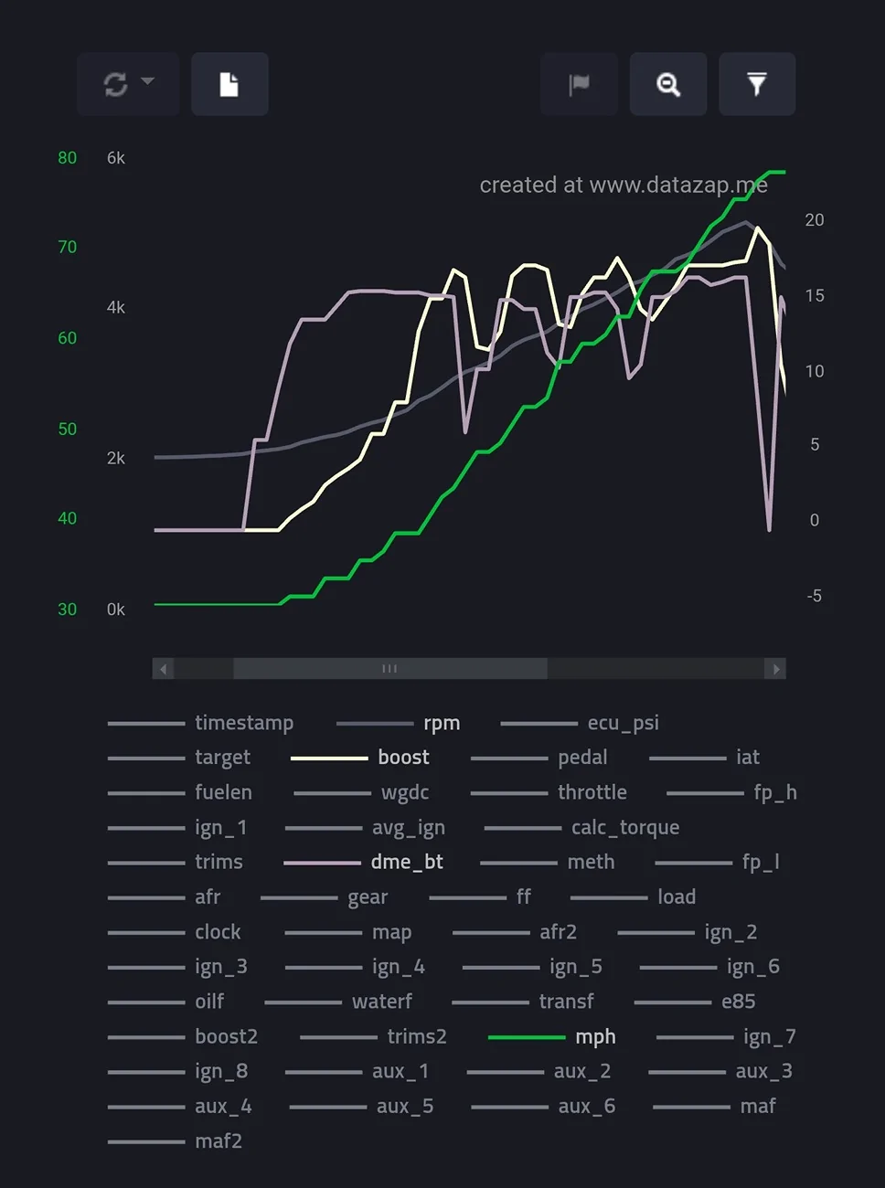

I'm suddenly getting significant throttle cuts in my pulls, any ideas what might have changed or is causing this? Ambient conditions have been pretty consistent. Almost wondering if there's a hardware issue? Haven't yet gone through to check connectors, make sure wires arent rubbing, etc, but I'm also not getting any codes which I would expect if that was the case.
https://datazap.me/u/nick470/map-2-surgingthrottle-cuts?log=0&data=1-4
I brought duty bias down at lower RPM, 45 in the first couple rows then a steady taper up to 50. Also lowered FF to 26 and increased FOL to 62. Improved it slightly, but I don't want to go chasing a couple parameters if they're not actually the cause of the issue. Any insight is appreciated!

Dme_bt has the same wiggle, so boost is following what the dme wanted. The same wave is seen in the speed sensor, so it was probably traction control. (keep it on, if you spin you'd need to lift anyway so it's a garbage log either way).
Timing is also bad, but this is probably a separate issue. You have lots of trim headroom if you want to add e85.

Sorry, I should have included more information. this specific log was in "traction mode", stability control still enabled. I tried again with everything completely off and I'm still getting the surging. So this isn't TC intervention.
The timing is a byproduct of the throttle cuts and load oscillation. The car has the octane to run this map. If this is ECU intervention, it's not knock driving it.
One thing I'm seeing is that boost is hitting values higher than ecu_psi+target, immediately before the first throttle cut. I had thought that it was basically (pressure sensor reading) - (JB4 additive target) = value sent to ECU = ecu_psi, but apparently that's not the case. Calc_tq is still well within the suggested limit of <48 at this time, and trims are still within reason. But the ECU is definitely being sent boost values that are more than the target/offset value away from the actual boost. The JB4 reduces ff/wgdc as this occurs, and soon after the ECU cuts throttle and pulls back dme_bt. Looks like it tries to stabilize it slightly by adding a bit of timing alongside the cuts. Maybe that's the triggering event?
ECU and JB4 both try to get the turbo spooled back up after dropping 5psi of boost, immediately jack calc_tq to 50, boost overshoots the 4.09 target, and the ecu promptly closes the throttle to try and rein it in. It's definitely not helping that I've left my foot buried in the pedal while this happens, so the ECU and JB4 are racing in conjunction to build boost back and blind to the fact that they have a helper in that endeavor.
It does look like the car is seeing ~1psi more boost ~200rpm earlier than the "good" map 2 log I'm comparing it to. Hard to say if that's a factor of slightly higher ethanol and a part-throttle start to the log just giving the car more timing right as I'm tipping in, or differences in ambient conditions.
