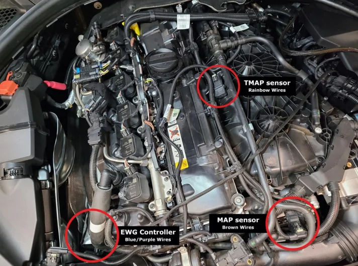

Just noticed this, I don't think the logged IAT is the charge pipe temp. This should be in the ~300 degF range under boost, due to the thermodynamic work done by the compressor.
Yep you are right, IAT is measured off the TMAP sensor which is post intercooler:
