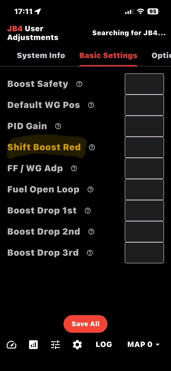

Just got the car out of winter storage, everything runs fine but I have a question. In the basic settings of the JB4 app, is the “Shift Boost Red” a new feature?? I don’t remember seeing that before storing the car last November.
The current value displayed when connected with the car is 60. Anyone played with this? Thx as always guys!
Its been around. If you are overboosting or have big throttle closure on the shift, try raising it. (To 70 or 80)
If you are dropping a lot of boost on the shift, try lowering it. (40 or 20, etc)
Really anywhere 0-80 is fine to adjust and test.
