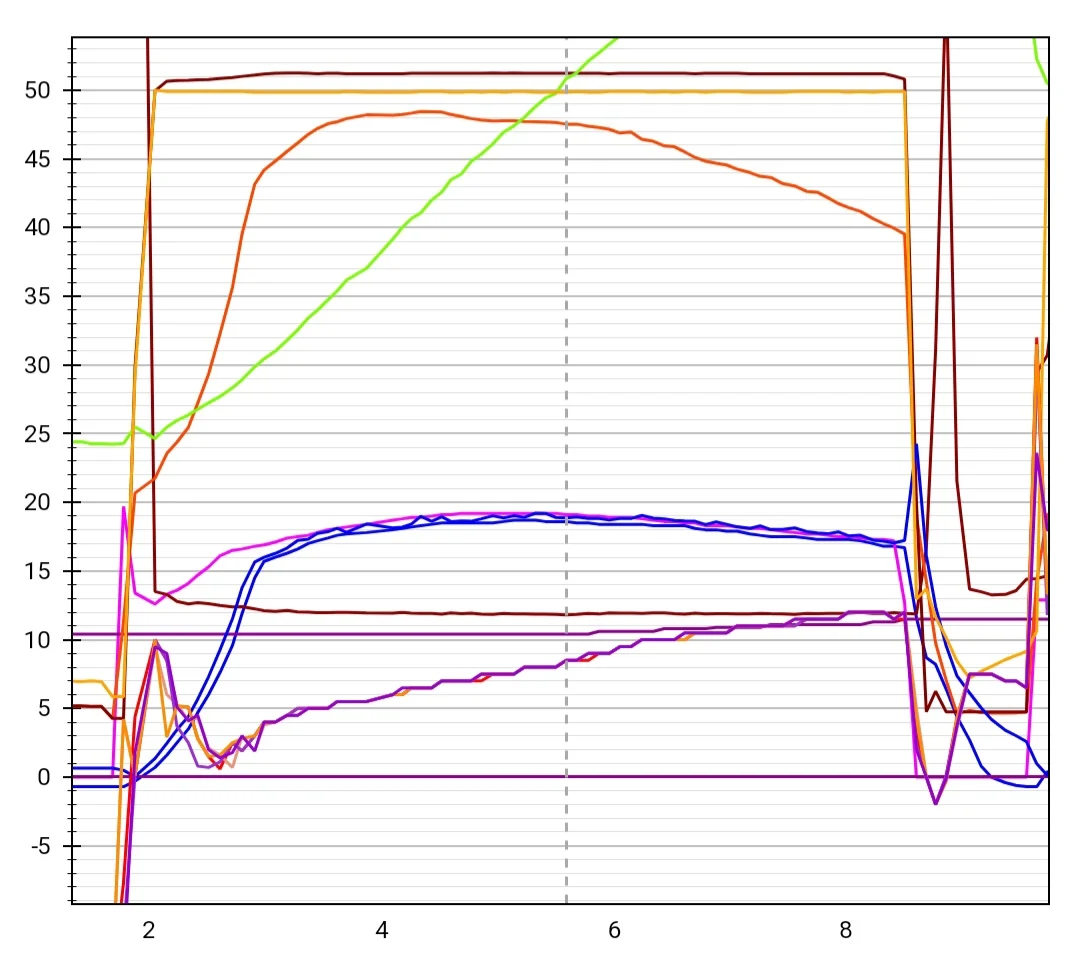

You should be running P158 firmware for gen2 b58.
I run V34 to help with the EWG fault codes
For manuals we want to "under boost" so I run my PID at 0
FF is per map
With 94 I'd try this on Map 2. Look at timing to double check if its good gas.
(v34 timing will reflect corrections. i.e. if it says 3 that's 3 degrees of correction)
Boost safety 23
PID Gain 20
Shift Boost Red 0
FF/WG Adp 20
Fuel Open Loop 60
FF is general curve, adjusting duty cycle is fine tuning the curve.
Lower FF where there are large throttle closures
Lower FF where torque higher than 47
I hope this helps

Thanks I’ll try to follow those guidelines for the FF adjustment. Had a clean run today in map 6 and didn’t get the same throttle closure. Hoping I can just dial in map 6 and run that most of the time. Do you go with PID gain on 0 in all your maps?

P358 is the firmware for the new JB4PRO unit I bought. It’s still pretty new so I haven’t found much info on it.

If its a 6mt it really isnt a good starting point. I used it at first because I wanted to go through each step from stock, to jb4, to mhd+jb4, to full tune and there is no comparison if you get the right tuner. The throttle closures, the fuel trims, the lean AFRs, the inconsistencies all suck on the JB4 and I was a huge promoter in the past when i was running it but now that the unlocks are done here in the US and cheap there is no real reason to use the JB4 anymore. The autos have it much easier but if you log your pulls you will see all kinds of throttle closures on the 6mt
