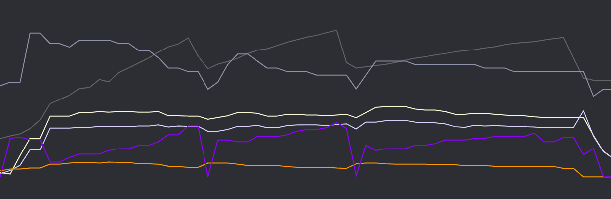

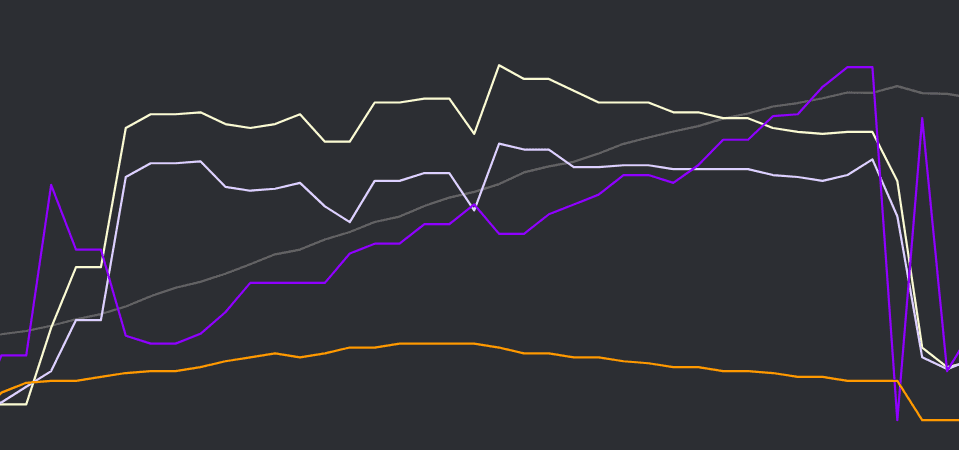

Plotted: ECU_PSI vs Boost (essentially your entire JB4 power gains - provided that timing stays up - shown purple)
Baseline run - choppy boost and throttle.
After MT firmware and tuning:
It only took a few revisions from the baseline I pulled from the last high-flow catted MT car I did.
