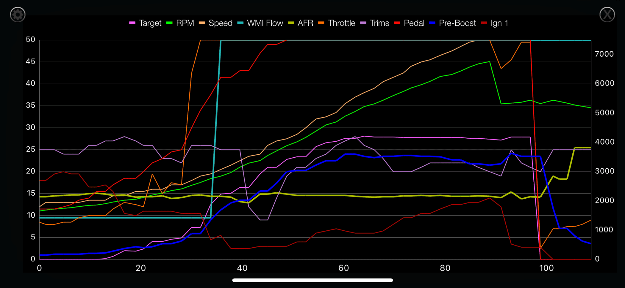

Would anyone care to look at my logs and give me some insight. Just trying to stay reliable with decent power for a bit, anything helps ??
Catless, auto 2022 supra
https://datazap.me/u/notwue/log-171...4-11-25-26-27&solo=4-11-25-26-27&mark=108-165
Tune definitely needs some love ?
Give this a try:
Switch to Map 2
Set FF to 25
These Duty Bias values:
duty_15duty_20duty_25duty_30duty_35duty_40duty_45duty_50duty_55duty_60duty_65duty_70
50​
50​
50​
50​
50​
50​
50​
55​
60​
65​
65​
65​
Give this a try:
Switch to Map 2
Set FF to 25
50​
50​
50​
50​
50​
50​
50​
55​
60​
65​
65​
65​
Did these 2 runs on low fuel tank with those settings, not sure if that makes a difference but will try again tomorrow on full tank. Also already have boost safety on 23.0, noticed I still got 23.40 in one of the runs ?

managed to get 3 more runs on full tank and I think it looks worst, timing all over the place ?
https://datazap.me/u/notwue/log-1717558977?log=0&data=1-4
It honestly doesn't look too bad, but yeah probably need to dial off boost a little.
Try this map 6 out. Remember to set FF back to 25
map6_15map6_20map6_25map6_30map6_35map6_40map6_45map6_50map6_55map6_60map6_65map6_70
0.6​
1.1​
1.6​
2.1​
2.6​
3.1​
3.6​
3.6​
3.1​
2.6​
2.1​
2.1​
0.6​
1.1​
1.6​
2.1​
2.6​
3.1​
3.6​
3.6​
3.1​
2.6​
2.1​
2.1​
Alright managed to get 3 runs in on the way back from work on map6 with these values set and FF on 25.
https://datazap.me/u/notwue/log-1717651868?log=0&data=1-4
