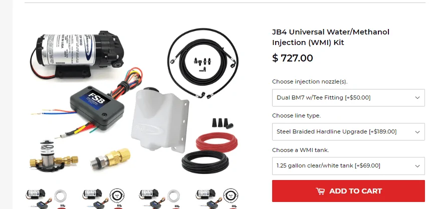

Man gotta say meth is looking real tempting hahaaha
Would you recommend the AEM kit or the snow performance? Price difference is huge so not gonna spend the extra cash if it’s the same thing essentially.
This is what he is running (options shown) + charge pipe:
The only thing I would be cognizant of is if you get the burger meth kit, You will also want a charge pipe with multiple bungs. I used the one from Burger as well. It integrates and tunes rather nicely!
I have been rather happy with the setup but if you take it a step further and go away from JB4 you will likely want the snow/aem kit. (long term plan for the car?)
The one downfall of the Burger kit is the housing for the meth won't fit under the hood like the AEM/Titan kit.
Edit: Car made 466whp. Assuming would have been a bit more if catless. Made over 100whp from stock to custom tuned/meth.

Yea I’m actually looking to go either mhd+ or bm3 maybe in the next 2 months. So I want something that can also be used with either of those platforms. Thank you for the heads up!
just waiting to see how that pure900 coming out performs!
