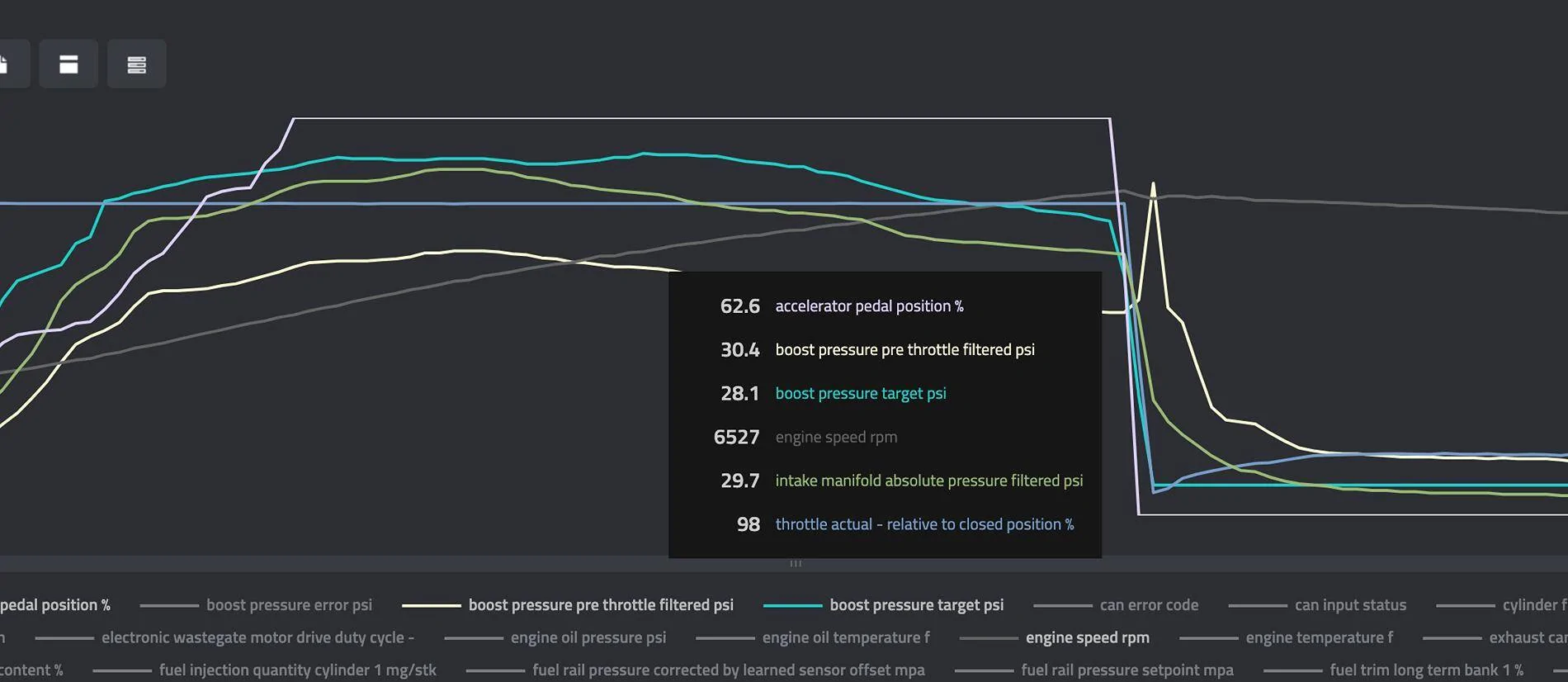

Very interesting on the Marin's tune. I thought there was something off about it for sure. Yeah we smoked it with pressure and were able to find that there was boost leak between the intake manifold and thermal space (CSF manifold and spacer) and we fixed it but that log you viewed was after the fix. Smoked and presured tested it after and nothing came from it. I almost wonder if there was something wrong with that manifold, I changed it out for an EOS one and haven't ran Jeff's tune in it yet. Think it would be worth a try to just throw his tune in and see what happens?
Edit: Added a log taken today using Jeff's tune.
I'd send this off to jeff, but WGDC still seems wild.

Yeah, you get out of it, and the throttle body valve closes. Of course, you get increased boost pressure in the charge pipe. Intake manifold pressure stays regulated exactly as it should.
Here's a log from a pass in my car a couple weeks back. Exact same shit, and is expected. Mine isn't as pronounced because of BOV, but it's definitely still there. You're chasing ghosts.
Jeff says I have boost leak, what parameter would indicate that? Is it that gradual decline on the boost pressure line on the graph? Car has been smoked and pressured tested with no indication of a leak..
