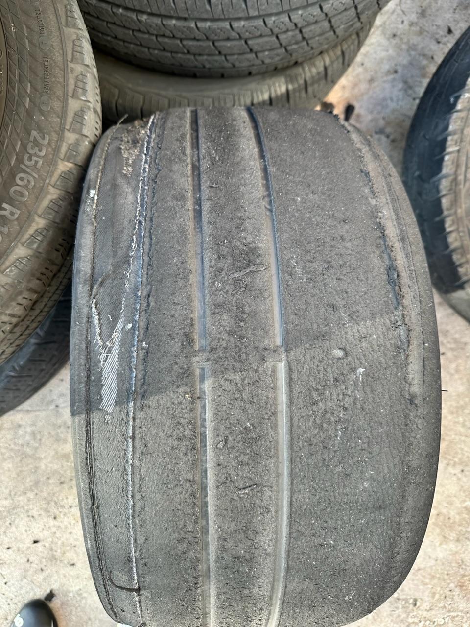

Hello,
I don’t know if it’s related to the lowering springs but my tires are completely down on the inside and 4mm left on the outside.
In the picture is a front tire, it’s not that bad on the rear tires.

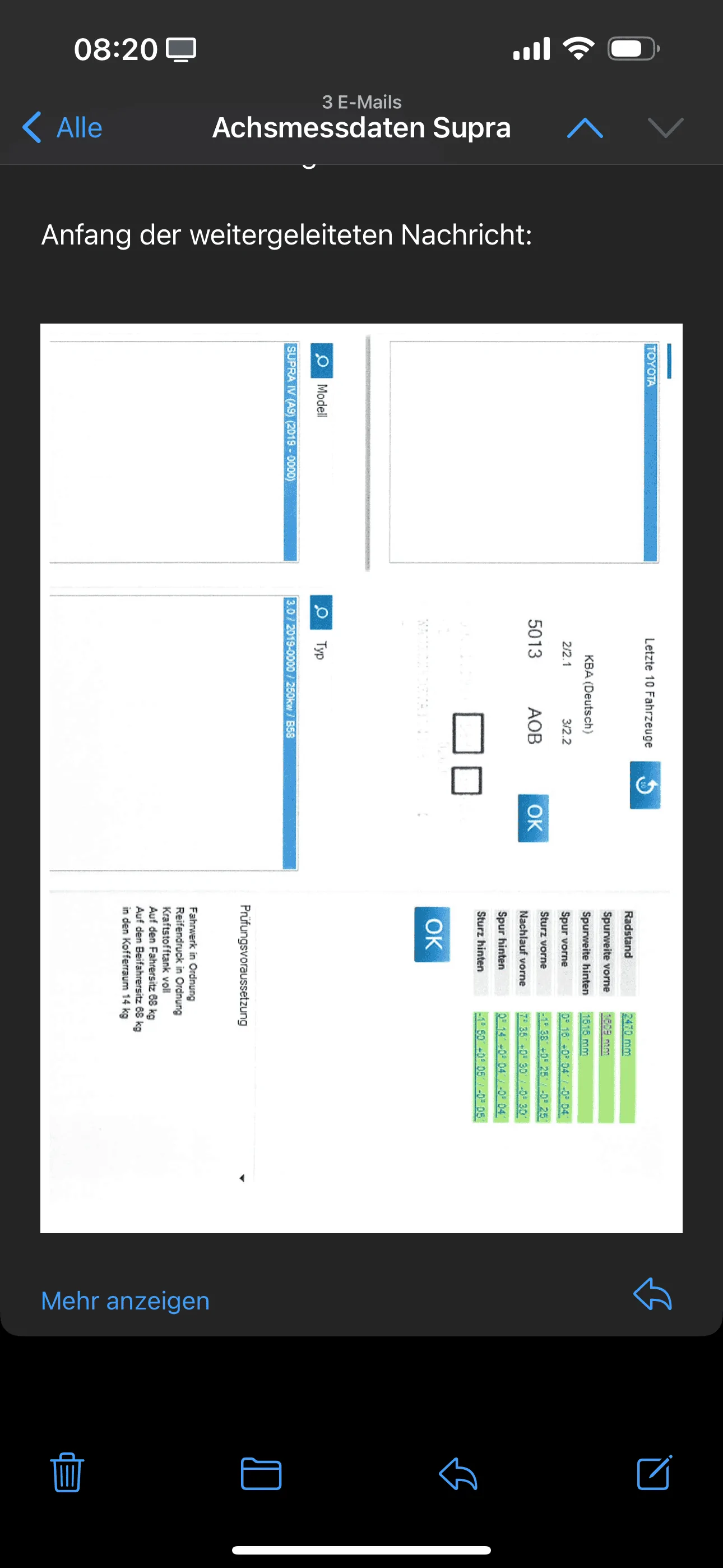

I got an alignment on factory specs after installing the lowering springs.
But I also did some hard cornering on the track 1 time and on the streets so I’m not quite sure where it comes from.

Looks to me like it might be rubbing on something. If it was alignment it should get progressively less worn as you move toward the outside of the tire, but the rest of the tire looks mostly evenly worn except that one inside corner.

The wear on the left tire looks pretty even across the tire. Looks like the right side of the tire has been rubbing on something…

I don't see any rubbing. Whole left tire's thread is pretty much gone equally.. Inside sidewall started giving up.. Yeah, just slight uneven. You've got like 3/32 more thread on the outside than inside ?
Horrible alignment and/or you've got a used tire or something.. Or, sorry but are you like rather overweight ? Assuming that's driver side tire...
What's even the mileage on these tires? Right looks brand new. Is that right side or the new replacement tire??

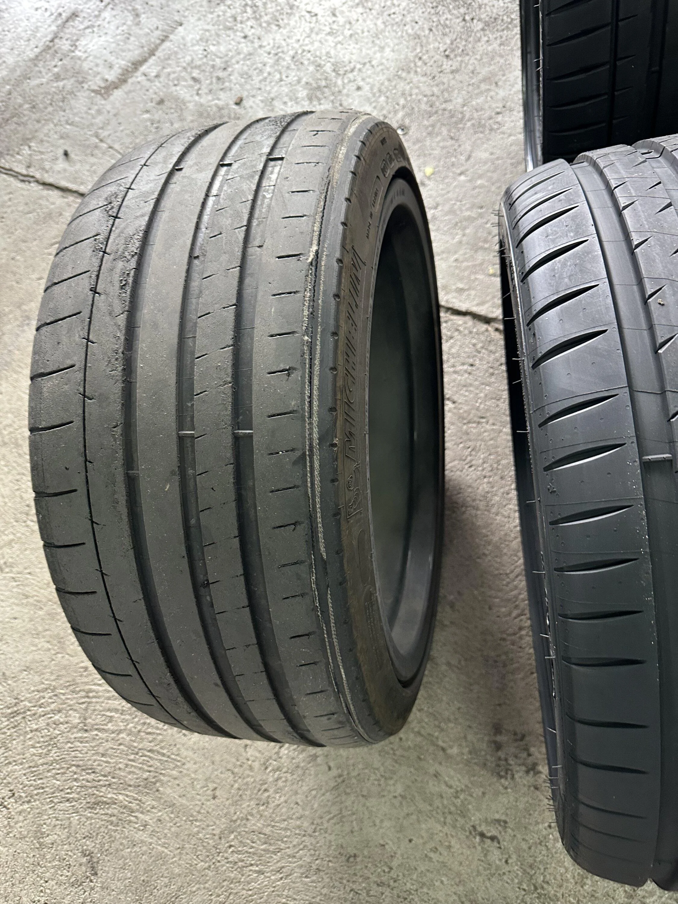

Forgot to mention, the left one is the old front tire (both look pretty much the same) after 26k miles.
It’s the PSS that comes from the factory.
The right one is the new one that is on the car right now.

Check the alignment of the wheels, maybe they are off grid.
AFAIK there are 4 reasons this can happen.
1. The alignment doesn’t fit the suspension
2. Hard cornering like under steering a lot
3. Bad tire quality
4. Tire is rubbing against something
I was too low - on 18’s and lowering springs. I’ve also seen other Supras with visible tire rub on the wheel well (hood fender). You can see black tire marks there, if you’re too low.

Have you had an alignment done since you bought the car? This is what a bad toe setting looks like.
I did alignment at 8K as part of dealer service (though I didn't get printout with results). They didn't tell me about anything wrong at that time. Next at 10K I started feeling vibration at high speed and brought car to tire shop to check alignment again. That is when they pointed me to weared off tires with threads showing up. That was very hard to see - only inside of 4 tires got damaged.
I changed to PS4S tires now and did one more round of alignment. This time I got print out. I will see how it goes.
