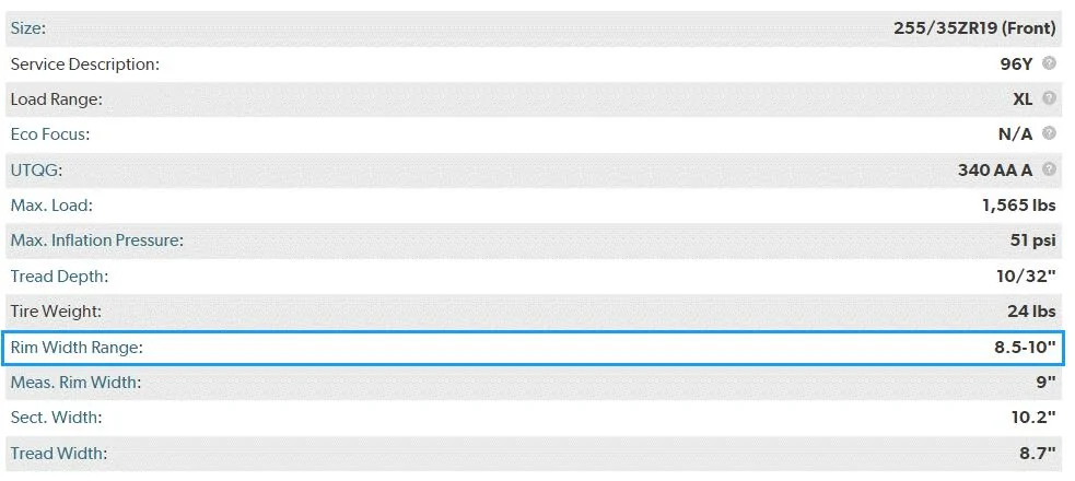

It may depend a bit on the tire you are looking at. Most tires will have a range of Rim Widths they support. The OE rear wheels are 10-inches wide, which is usually on the larger side of what a 255-width tire will support, but I looked up some random 255-width tires on Tire Rack (image below) and they do support a 10-inch rim width. So basically, check the specs of the tire you are considering.
Since the rear wheels are 1-inch wider than the fronts, running a square 255-width setup may result in a slightly different appearance front-to-back as the rears will be stretched a bit more on the wheel possibly resulting in a different sidewall appearance.

Hey thanks for the quick reply! I was actually just looking at Pirelli All Season +3 255/35/19 but can't find anything on Rim Width Range..

All good guys, supports 8.5 - 10in rim width. Thanks! But if anyone has any tire rec. lmk! Alpine 5, etc. Thinking of getting AS for the Supra and winters for the g80.

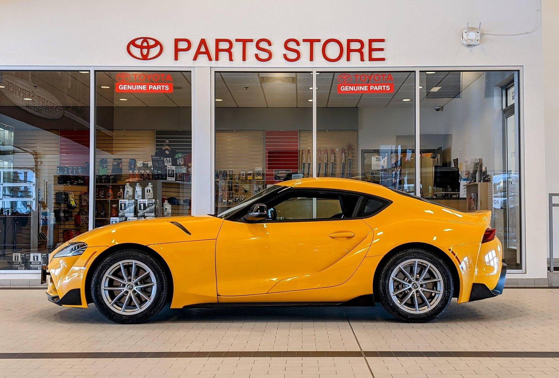

Interestingly Toyota sells a wheel specifically for Winter tires. It is a 17-inch wheel intended for a square 225/50R17 98H tire setup. I haven't looked, but I would guess plenty of winter options in that size, though such skinny tires may will look funny. There is even an option in the TPMS settings to select this size.
Part number for the 17-inch Winter Wheel is: 42611-WAA05, it's specs are: 7.5Jx17 ET24

I purchased a 17-inch Spare Wheel from Toyota (42611-WAA07) and test fitted on the front and back of my 3.0 Premium (because I also feared it would hit the calipers) and it spins freely, I believe I have the largest OE brakes available. I have also read of others on this forum using 17-inch wheels for drag racing on 3.0 models, though I imagine it may depend on the wheel.
Do you know for certain the 17-inch wheels that Toyota sells as Winter wheels will not fit over the brakes on a 3.0? (meaning have you tried it, or know somebody that has?)

I have not, but seeing how close they are on 18's leads me to believe 17's wouldn't work. A lot of the drag race guys go to 2.0L brakes. Most people go 17 in rear and 18 in front.
After doing a quick search, I see that the 17" wheels offered by Titan fit over the 3.0L brakes. Just keep in mind, not all wheels might fit. Very much depends on the barrel design.
