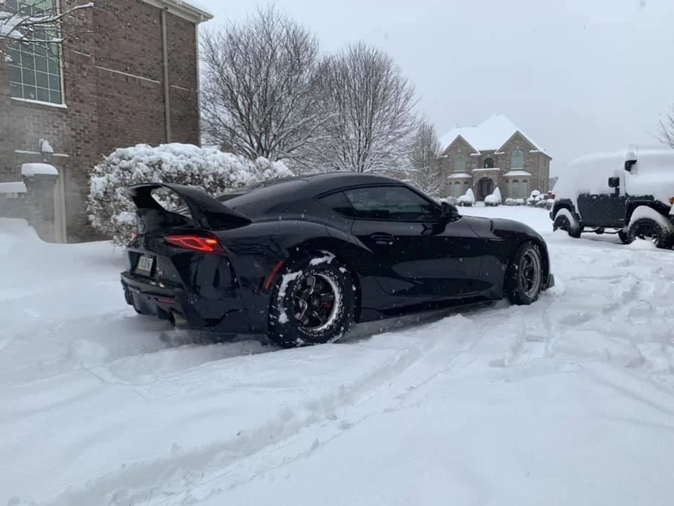

I was not planning to need winter tires.
Then winter came to Texas.
Now the Supra sits in the garage.
My XT4 sits in the drive covered with snow.
I sit in the house and drink rum.
