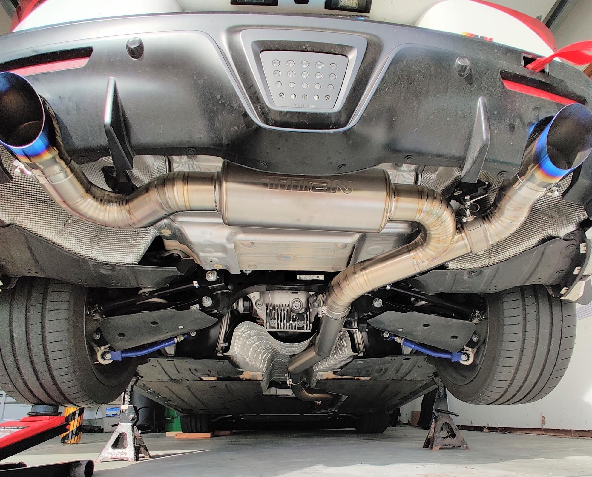

When you say - "The only way they could make it better would be to make it out of stainless rather than titanium."
Can you elaborate? Asking because the weight savings of the Titan kit is one of the reasons I am eyeballing it. Handling, acceleration, gas consumption should all be better with the titanium exhaust.
Probably sound and durability. Shedding weight is always good, but when it’s 20-40 lbs from the lowest point of the vehicle it doesn’t make a huge difference.
i3igpete
i3igpete
May 16, 2022
49
1,350
1,649
Chicago
2023 3.0L 8AT
ductility - titanium can withstand much less deformation before it completely ruptures
durability - most titanium tubing is thinner than SUS due to cost
repairability - very few shops can fix titanium if it gets dented. this means adding something like an extra resonator is out of the question

No doubt it’s the cooler version of Joe. But simple Joe just wins out sometimes for a street car.

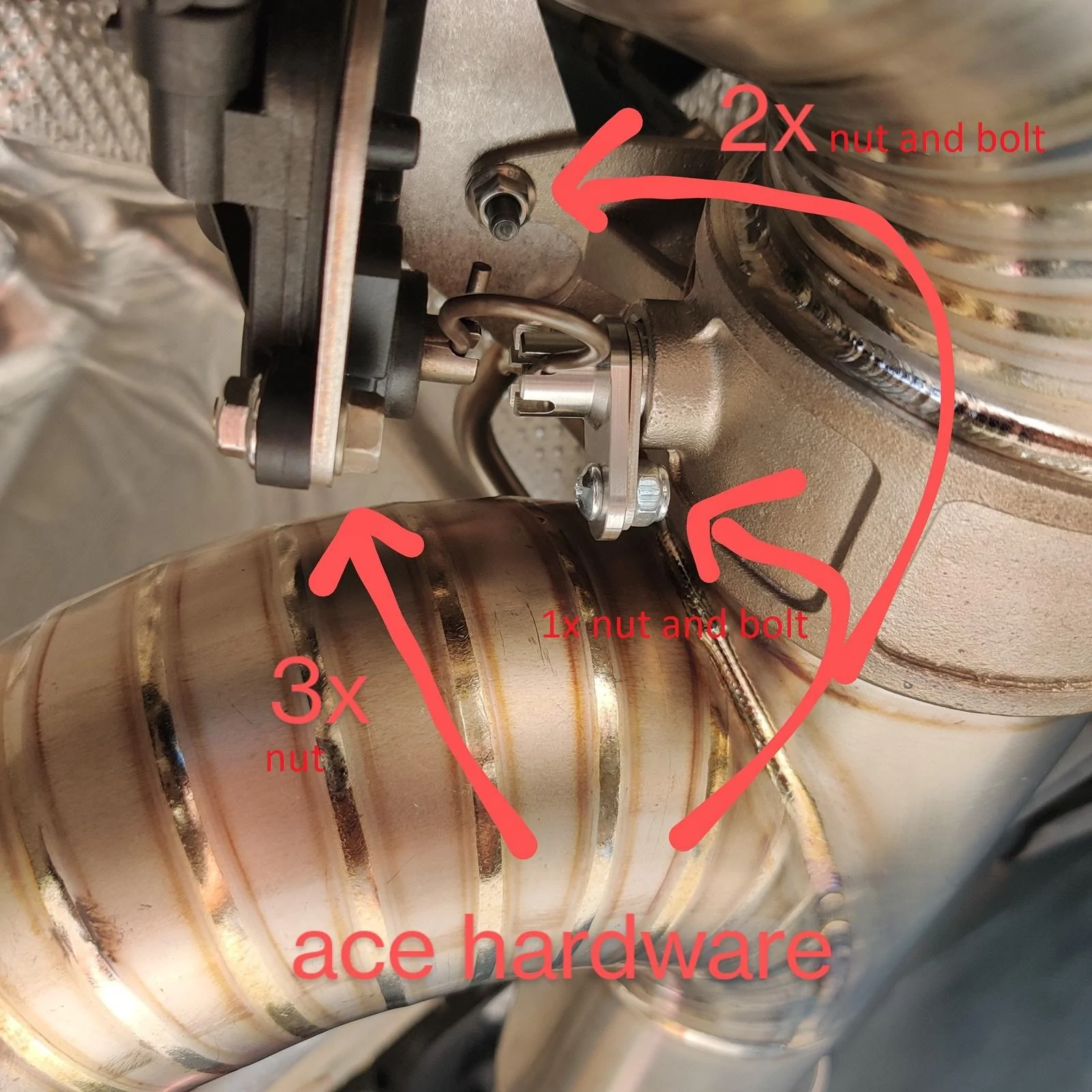

KingDreki
D
May 8, 2025
Supra

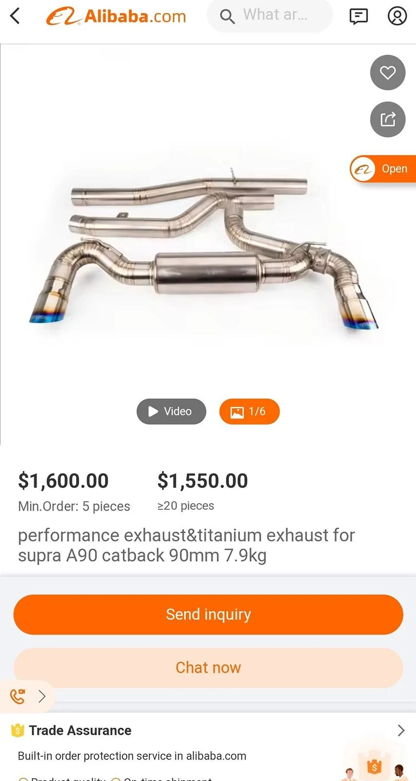

@i3igpete when you say it didn’t come with hardware, does that mean the previous owner didn’t give it to you, or it wasn’t shipped to the owner? This is my biggest concern on buying this right now.
i3igpete
i3igpete
May 16, 2022
49
1,350
1,649
Chicago
2023 3.0L 8AT
the previous owner sent everything he had, and titan confirmed what he had was the full kit.
that being said, its an alibaba exhaust, so it's possible the person at titan didnt know what exactly was missing either.

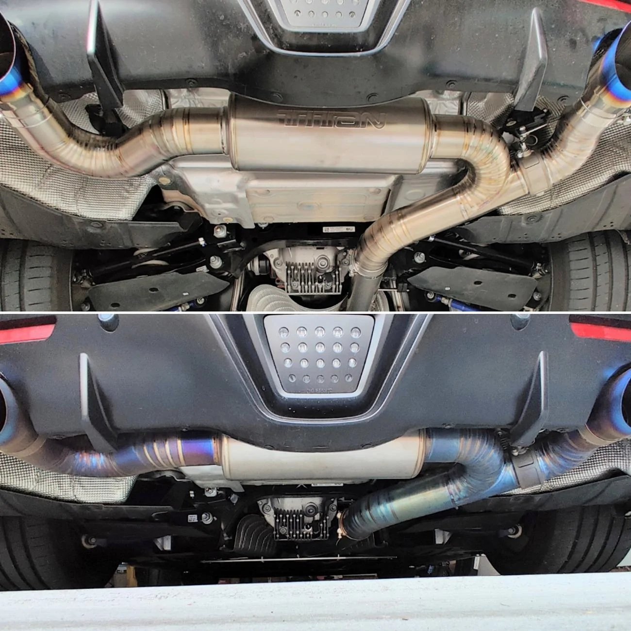

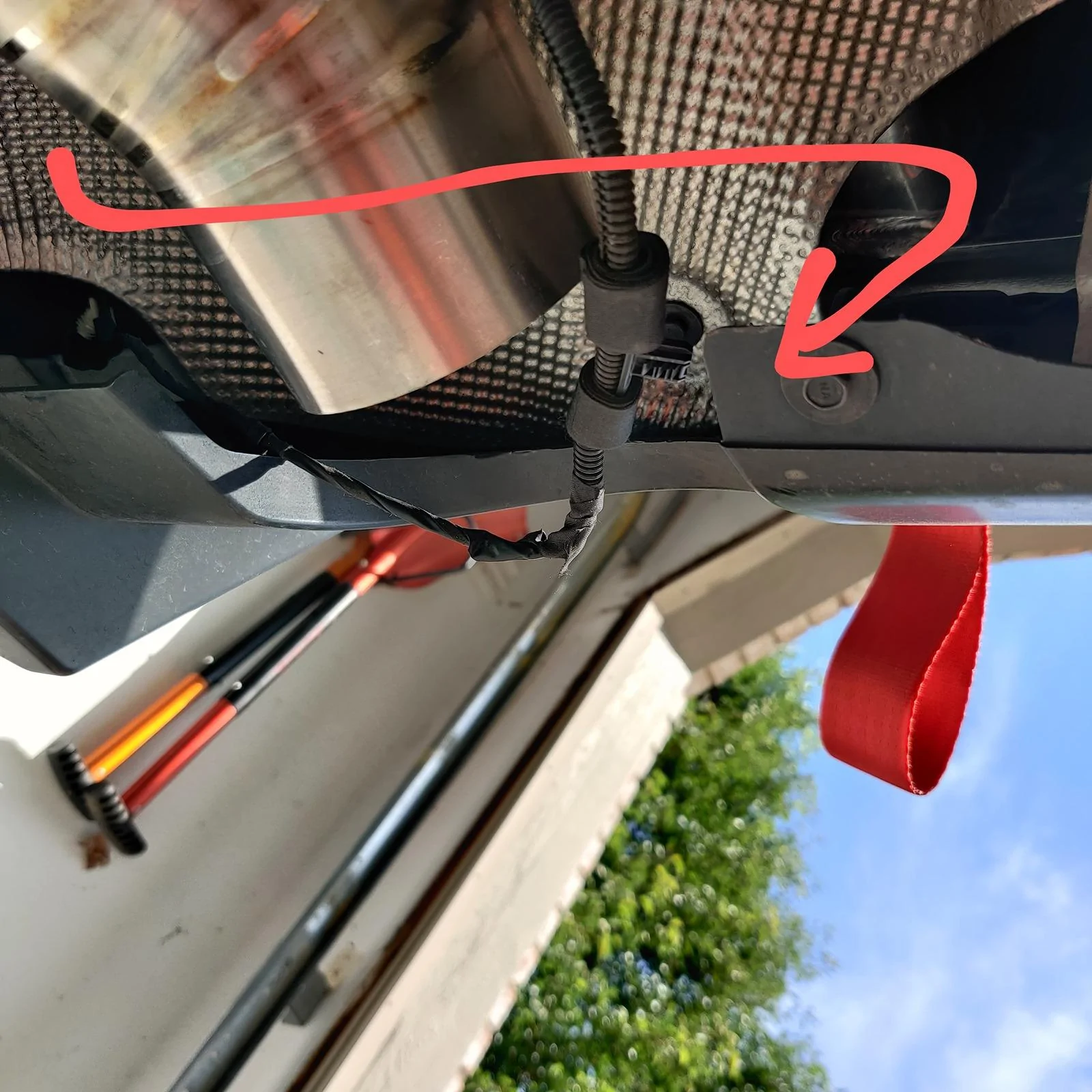

3 track days and a cool annealing (tempering? it's been awhile...) pattern emerges. you can see the EGT drop after passing through the muffler.
how's your rear valence around the exhaust exits? mine are pretty scraped up after a track day :(
install error?
i3igpete
i3igpete
May 16, 2022
49
1,350
1,649
Chicago
2023 3.0L 8AT
The plastic just above the tips is melted on both sides. The gap is still fairly even on both sides, so i dont think it's shifted at all. Just hot.
bushido
Oct 31, 2022
942
1,724
Miami
yes
mine hasn't shifted either. just glad i'm not alone. not worried at all but definitely caught my attention :confused1:

romanLegion9574
Dec 22, 2020
1,371
1,923
I had some melting on the passenger side
