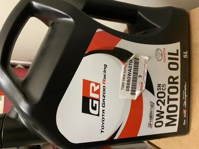

The dealers should have your oil in stock . I know we carry it. It has it's own special bottle lol I put some to the side for me. :)
can you post a picture of what the bottle looks like?

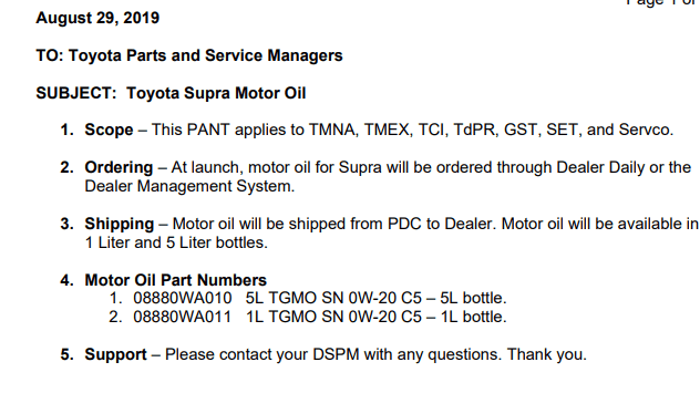

5L bottle.
Oil filters are BMW with a Toyota part number sticker on the box along with a “Partnership with BMW” sticker covering the BMW logo.

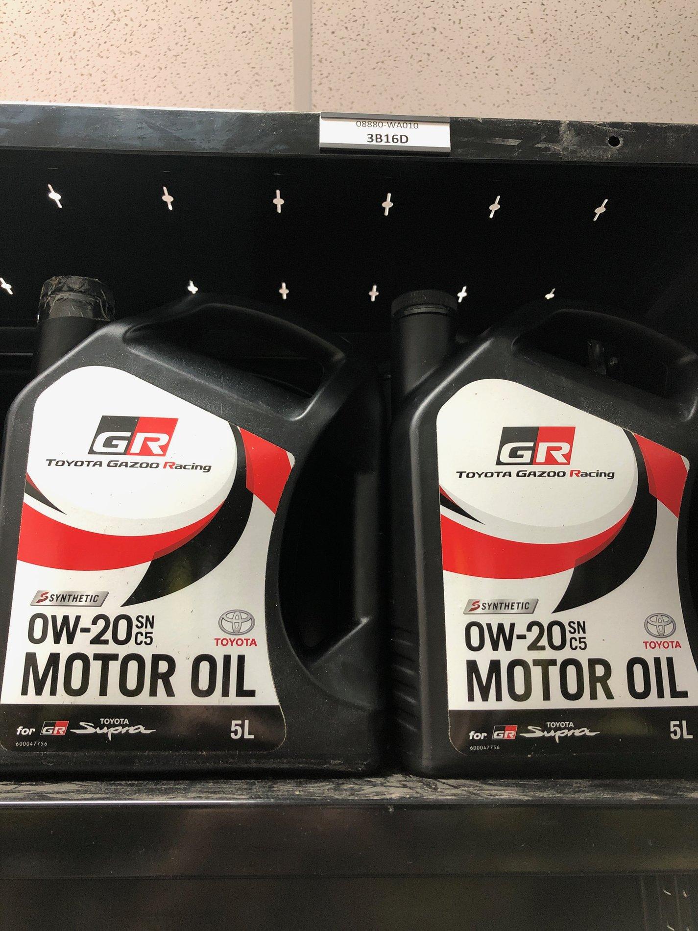

Glad I had researched things a bit and saw this thread before my trip to the dealer. Got the filter and that was the correct one, but they tried to sell me this oil.

They did not. Showed them the correct part number and it was “oh, guess we’ve gotta order that”. First dealer where I bought the car, I was originally going to have them change it under Toyotacare, but after an hour of waiting, found out they had neither the oil or filters available. This is the second local dealer I’ve contacted about this stuff and still no luck with oil.

I plan to print out a picture of the correct oil (USE THIS OIL) and leave it on my dash when I bring my car in. That way the tech see's it.
