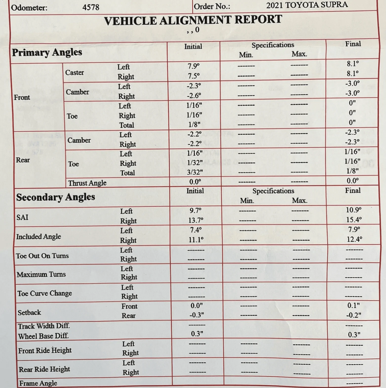

Sharing a new alignment spec I'll try out soon.
My original alignment was went a bit out of whack for camber/caster (it was originally like -2.5 front camber and 7.8 front caster). The rears weren't really off by much.
Using SPL FLCA w/caster bushing - everything else is stock.
