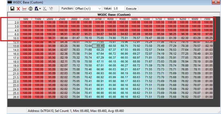

Figured I'd keep it in the appropriate thread. I didn't really have throttle closure issues on my base map except at lower pedal input. Also I did try the strategy of base < actual, just didn't quite pull out enough.

See rolling into the pedal sort of has the PID all over the place. I had done the base table sort of like the example you had sent me, where wgdc is 100% up to a certain boost. I am wondering if that should be done differently now. Since its is overboosting at partial pedal boost targets.

Yea you could also add more boost target breakpoints in the single digits. Pid should be able to keep up with most of this.
This is one of the drawbacks of moving away from the OEM airflow model.
There are a bunch of partial throttle tables for boost control. I'm not 100% if MHD+ skips all those too, but might be worth a try.

So no harm in dropping the base values for 6 psi and below and just leaning more on the PID?

I wouldn't think so. Try it out. You are already putting more thoughtfulness in tuning than most tuners. ;)
