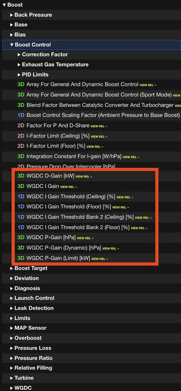

You mentioned that the log screenshot was taken with the dynamic PID boost control disabled, and that it’s a good method to tune the Wastegate Position Feed-Forward table more accurately before re-enabling PID. That sounds like a great idea, and I’d like to try that approach.
Could you please clarify:
Which tables or parameters need to be modified to disable the PID system temporarily for tuning purposes?
Are the following tables sufficient to zero out?
• Boost Control Variable (PID) Floor
• Boost Control Variable (PID) Ceiling
Or are there additional steps required to fully disable PID intervention?
Thanks again for sharing your insights!
Glad this has been helpful!
As far as disabling PID, I zero out the PID tables but you could try just floor/ceiling.

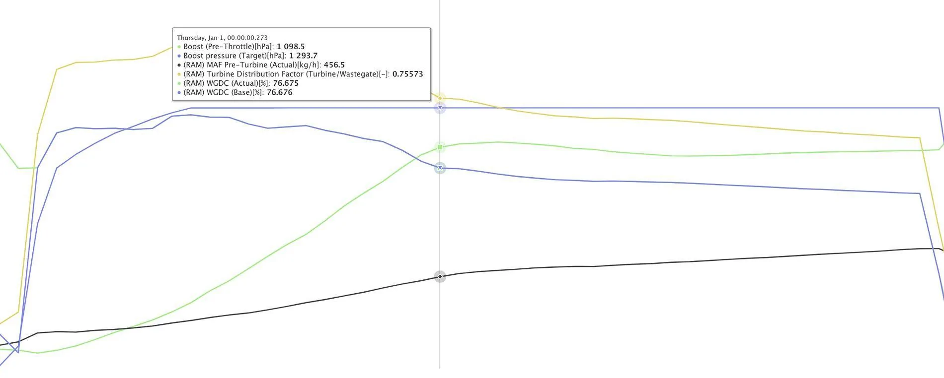

I followed your approach and disabled PID control to tune the WGDC Feed-Forward table. I adjusted it so that actual boost closely matches the target without overshooting. Below is a log I captured after disabling PID — you can see that while the boost curve generally tracks the target well, there’s still a slight tendency to overshoot a bit at the peak before dropping back down:
After refining the table, I re-enabled PID. On the first day it worked great — very stable, with little to no overboost. I drove about 300 km under varying conditions and it looked promising.
However, on the second day, I started to notice consistent slight overshooting after reaching the boost target, followed by a quick correction. Occasionally, this even causes a throttle closure. Here’s a log showing this behavior — note that WGDC (Base) is always about 1% lower than WGDC (Actual):
Do you have any suggestions on how to fine-tune this further? I’m particularly interested in why the WGDC (Actual) consistently ends up slightly higher than the base, and how to mitigate that slight overshoot under PID.

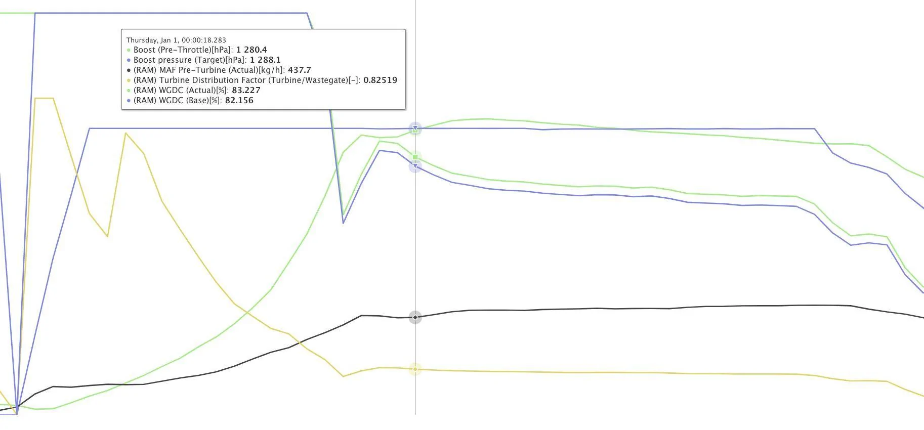

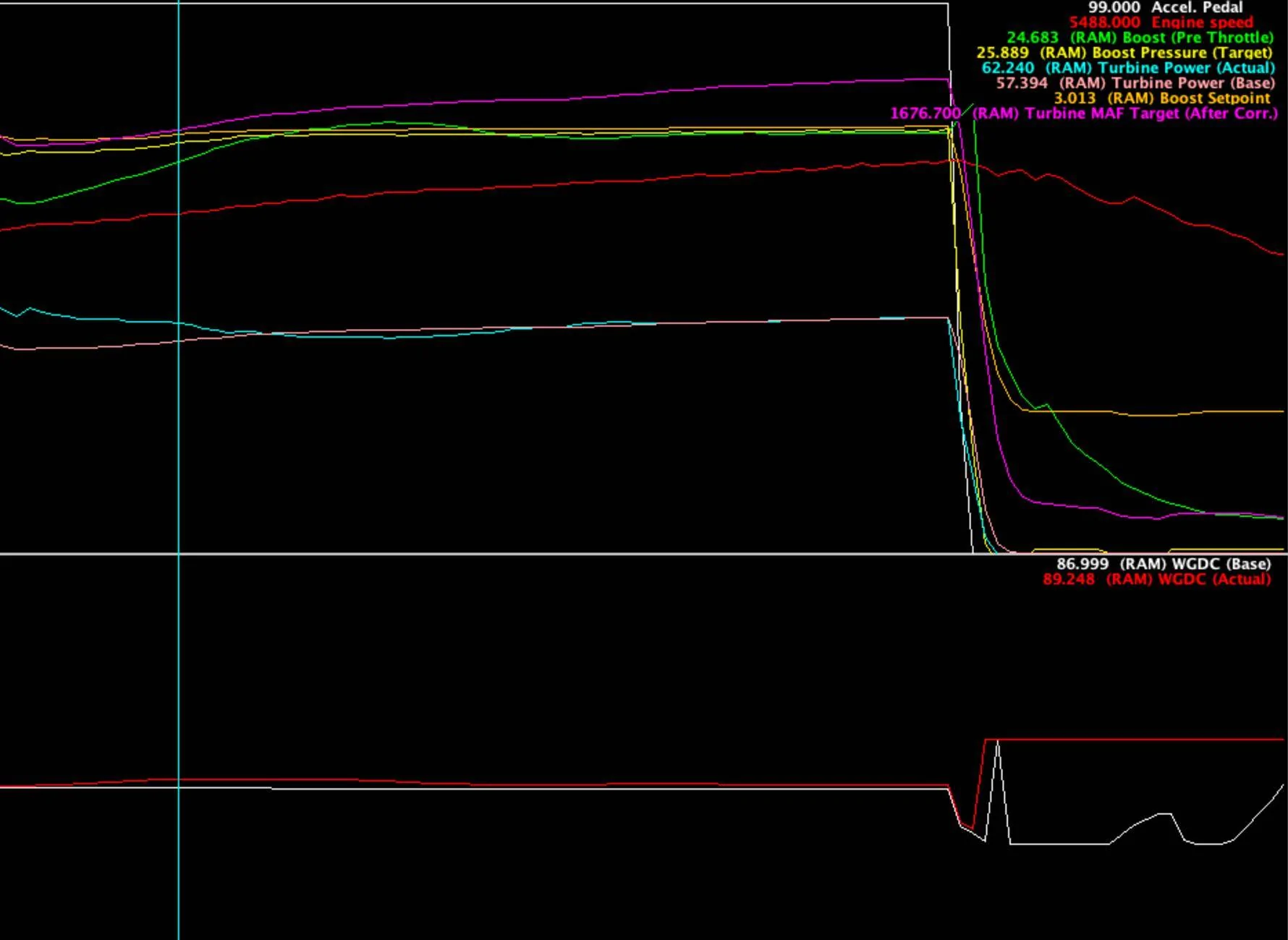

Make sure you are logging these:
(RAM) Turbine Power (Base)
(RAM) Turbine Power (Actual)
(RAM) Boost Setpoint
(RAM) Turbine MAF Target (After Corr.)

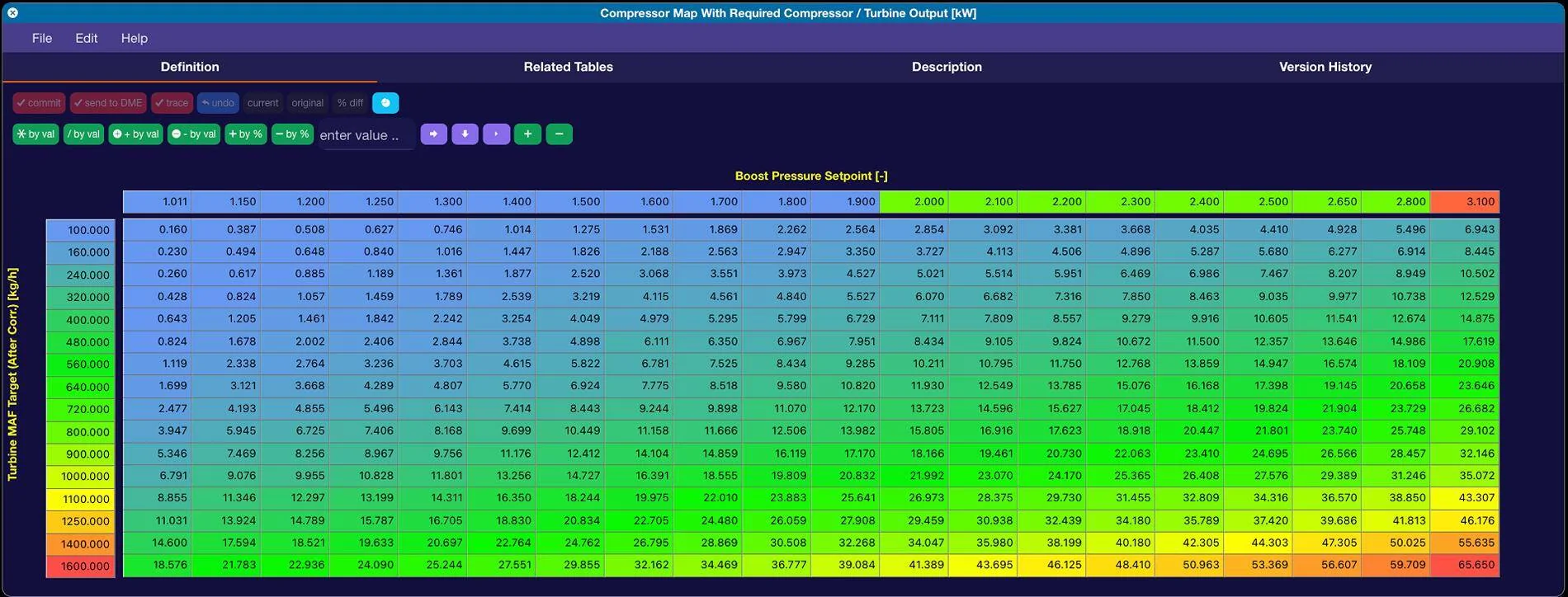

You probably need to reduce the values in your Compressor Map With Required Compressor / Turbine Output table at the area slightly before the part where you are over boosting.
Take a look at the values in your log of Boost Setpoint and Turbine MAF Target (After Corr.) as the axis lookup for the Compressor Map table to see where you need to reduce the values. If the logged item Turbine Power (Actual) is higher than Turbine Power (Base), than the P-Gain will add WGDC above your WGDC base to meet target. If it is lower, it will take out WGDC.
Here is a log example where the Compressor Map table is adding WGDC above base because boost is below target so the system is adding P-Gain to increase WGDC to try to reach target. You will also see the boost then overshoots target and then Turbine Power (Actual) falls below Turbine Power (Base) so the the P-Gain then takes out WGDC to compensate.

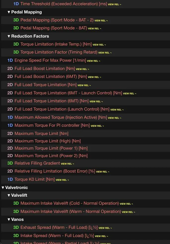

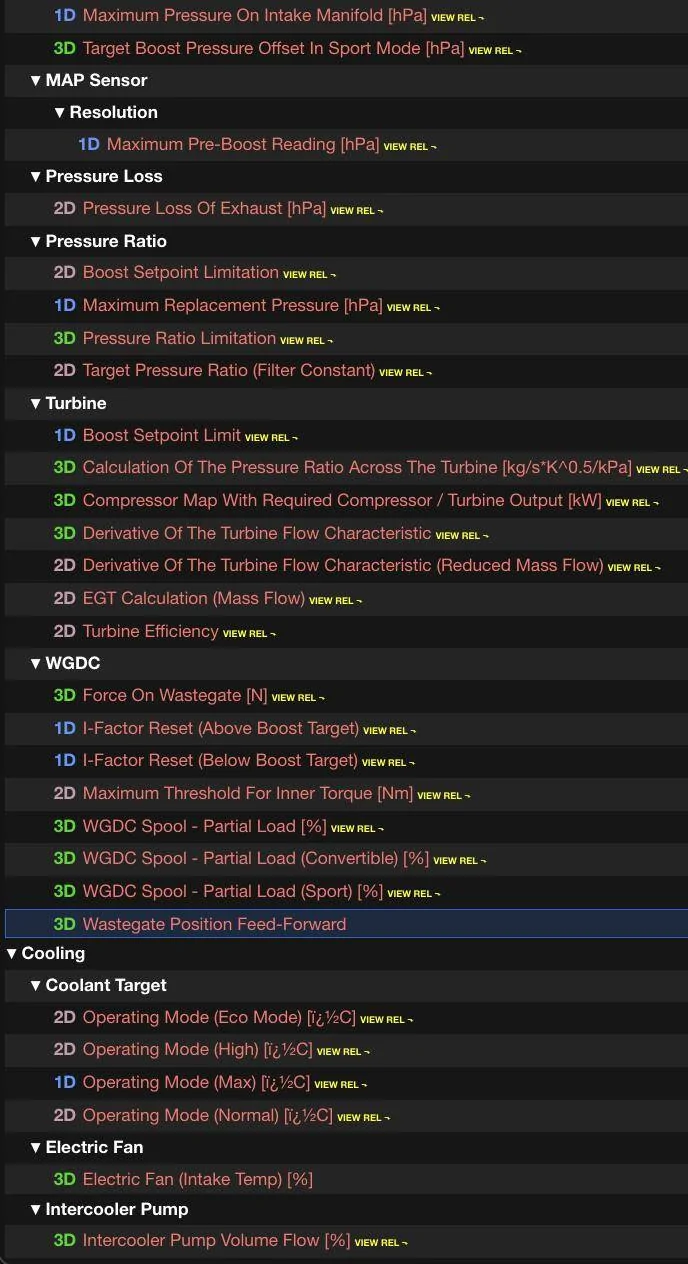

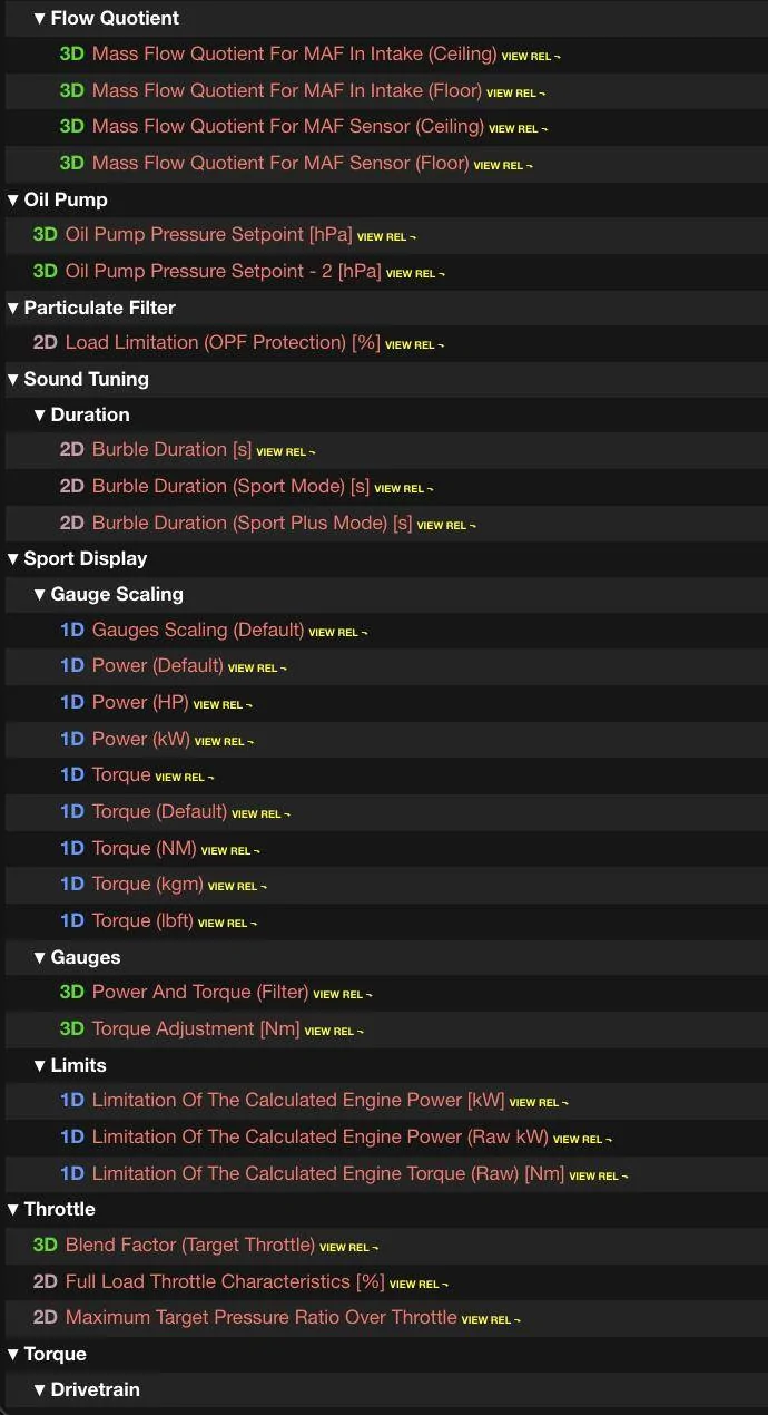

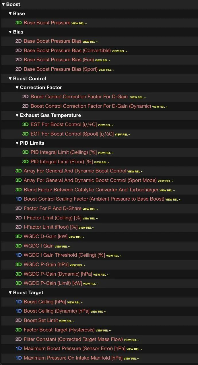

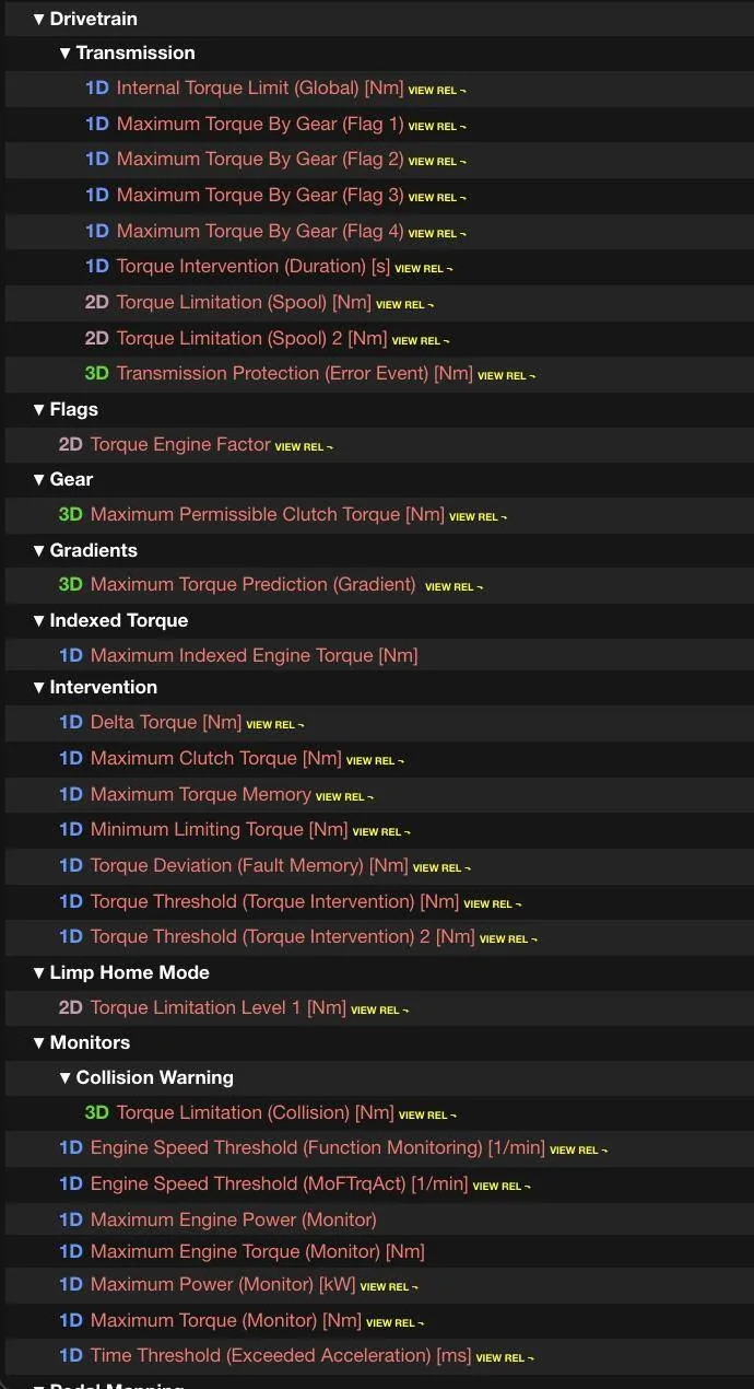

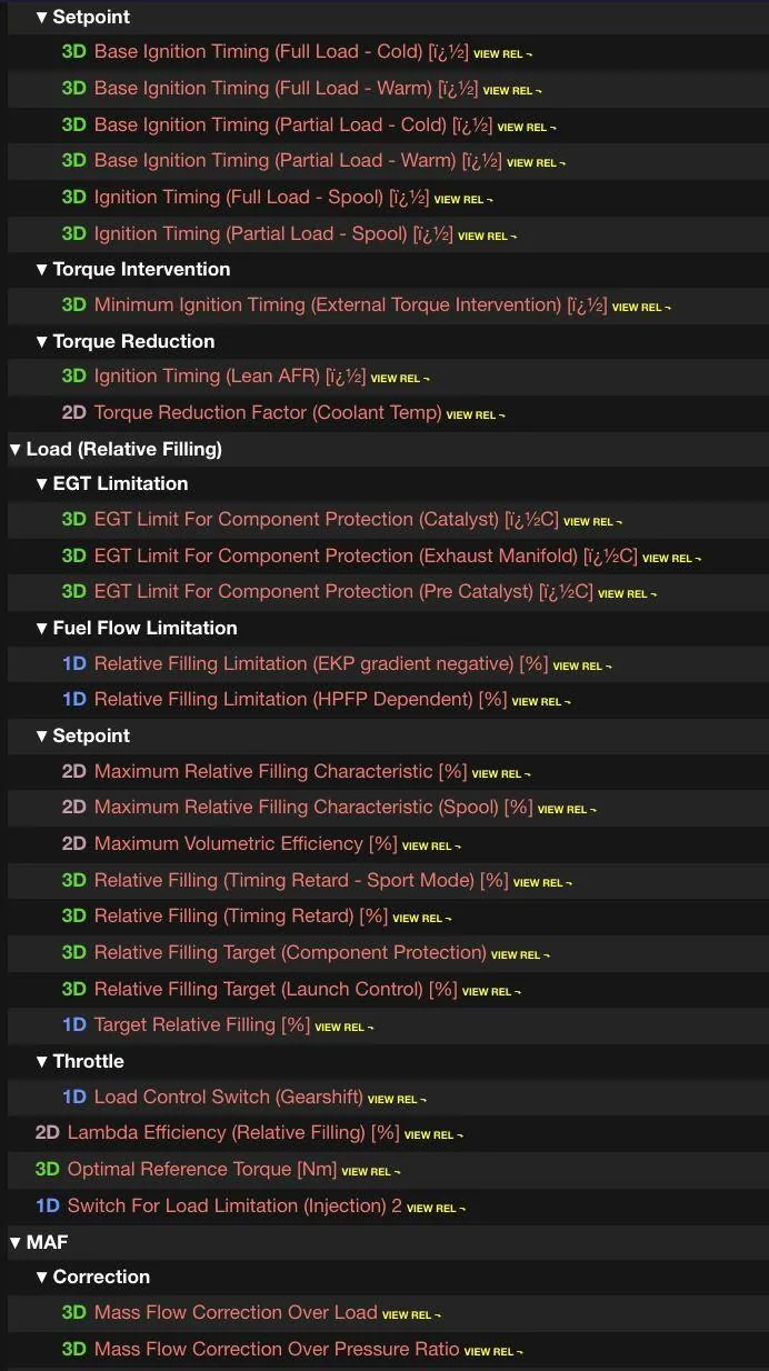

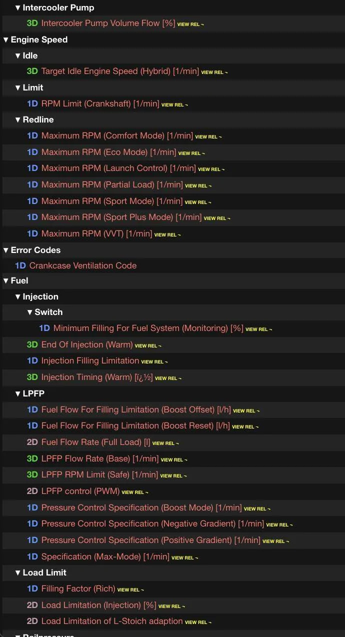

If anyone is curious of what tables I have changed in my personal tune:
Hi! Thanks again for all the great info you’ve shared in this thread — it’s been extremely helpful.
I saw the table you posted recently with your changes. Would you mind taking some time when you’re free to explain the significance of the tables you modified and why you made those specific adjustments?
It would be really insightful to understand the tuning logic behind it. Appreciate your guidance as always!
I'm not going to go through every single one but you can ask me about certain ones. Happy to help when I can.

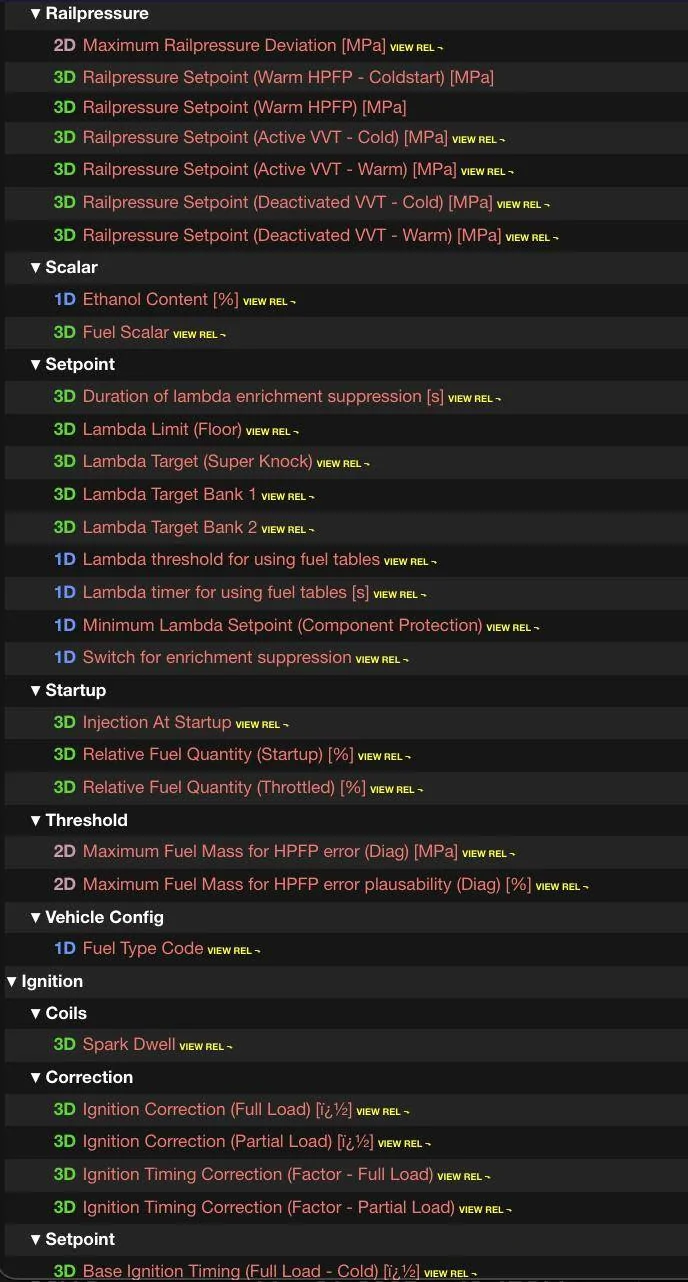

Okay, I finally got to the point where I have a good enough handle on the ECU strategies on this platform and done enough testing to get a pretty solid custom tune on my personal Supra this year. I have been testing and datalogging on the street and during all my track sessions, which has been invaluable to get my head around everything.
Now I want to share with others that might be interested in self-tuning on this platform with Bootmod3.
I'll start with fuel tuning, because it's the most straight forward part of the tuning platform. I'll continue to make new posts with different parts of the tuning process and eventually update the first post to have it all.
Tuning your AFR targets is probably the easiest part of tuning with modern lambda-target ecus and the supra/B58 platform is no exception. There are a couple more involved bits when you start using ethanol, and I will go into those here too.
Let's start with setting lambda targets and how to get the ECU to actually follow those targets...
There are two tables you want to set to your desired lambda. Lambda Target Bank 1 and Bank 2.
The OEM values for these tables look like this:
Now, if you have a 2020, the car will almost NEVER use these tables, and will try and target 1.0 Lambda (14.7 AFR) at almost all times, unless it sees high cat or EGT temps. In WOT it will richen slightly to low 14.X AFR. The 2021+ models go into enrich mode sooner and you will see high 13's at WOT.
In order for the ECU to use these tables instantly, which is preferred when tuning, you must change the following tables:
The first one is "Duration of lambda enrichment suppression". This dictates, in seconds, how long it will take the ECU to move to the Lambda Target tables, after an enrichment event triggers. On my 2020, you will see the table is set to 30 seconds. Very rare you will ever be going WOT for 30 seconds straight unless you are on the Autobahn or similar.
OEM values:
You will want to zero out this table like this:
Now, you want to also change the next three tables in order for the ECU to actually switch over to the Lambda Target tables.
Lambda threshold for using fuel tables:
Set this from 1.000 to 0.700
Lambda timer for using fuel tables:
Set this from 5.000 to 0.000
Switch for enrichment suppression:
Set this from 0.000 to 255.000
Now, going back to the Lambda Target Bank 1/2 tables...
Set these values to what Lambda you are wanting to target at what RPM and Load. Here is an example from my own personal Supra tune. Keep in mind I run an E40 fuel mix so I target leaner Lambda then one would on pump gas.
This translates to about 12.5 AFR at WOT:
That is it for basic fuel target tuning. My next post will be going over tables you will want to tune to get around some fuel load limitations and other tables you want to change if you are using Ethanol.

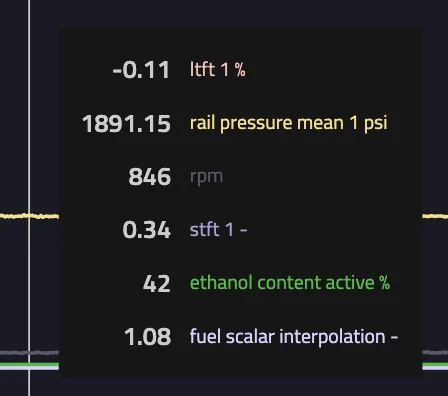

on the topic of AFR and what not, does anyone know what tables fix the rough idle that comes with running full e85? Is that because fuel scalar is too low (currently 1.4), or is lambda 1 too lean for E85 at warm idle? This is MHD, but I'm sure its the same strategy as BM3.
Maybe it has to do with the start and end of injection times.
just sort of looks like the car wants to die out and it saves itself with more fuel cyclically.

1.4 seems way too low for full E85.
What are your trims doing? LTFT and STFT.
Is this a DI car? What injectors?

Its DI and PI, but only DI at idle. Stock direct injection. Trims are relatively neutral. I haven't logged LTFT yet. PI is 550s but shouldn't matter. What do you recommend for scalar? 1.5-1.6? car is around e75

I recommend what your STFT and LTFT's are telling you. Also make sure your blending tables are setup correctly and you are logging fuel scaler interpolation to really know where you are.
