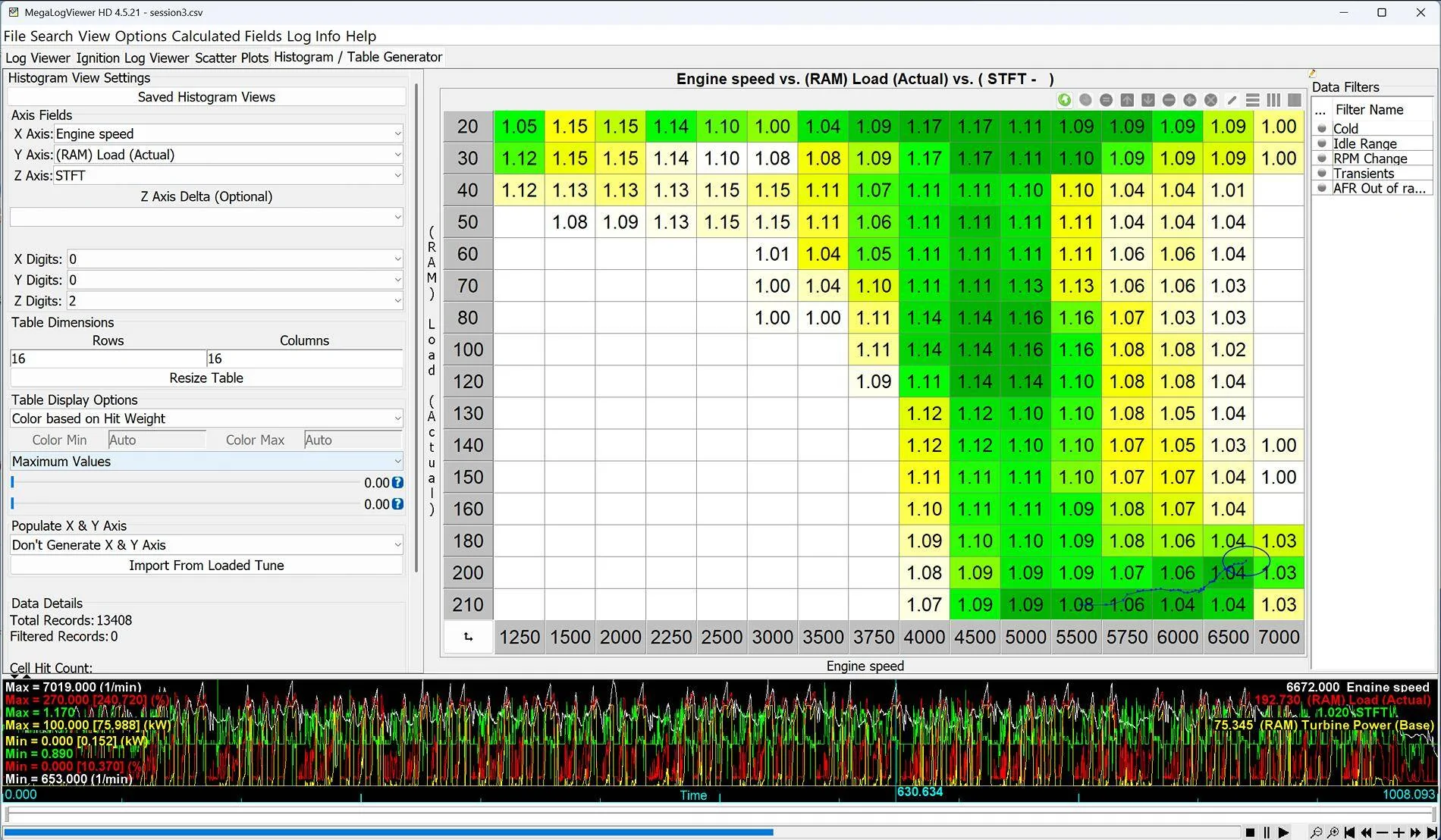

Also, I'm running E20 so will look to adjust the ethanol % accordingly. What affect does changing that have? Does it link to the fuel scalar table?
Yes, it's global as a 1D map, the scalar then is used for more granular tweaking. Best way to tune the 3D scalar table is logging STFT while driving in a bunch of different situations. I created a Histogram in MegaLogViewer and mapped the STFT onto the scalar table. Then I adjust the scalar table based on that. It's really powerful and helpful actually.
just had a flashback to AEM EMS that I completely forgot about. using Self tune, driving around, and then doing a diff of the old and new fuel tables. then grabbing the cells with the largest diff magnitudes to interpolate and generate the next iteration.
Hahha, yea I am a bit anal about some of this stuff. I doubt most tuners even bother.
I fear self-tuning is going to be a slippery slope of always tinkering to see if it can be made to be better.... mix that in with manipulating excel data, and I can't think of anything else that could be more enjoyable!

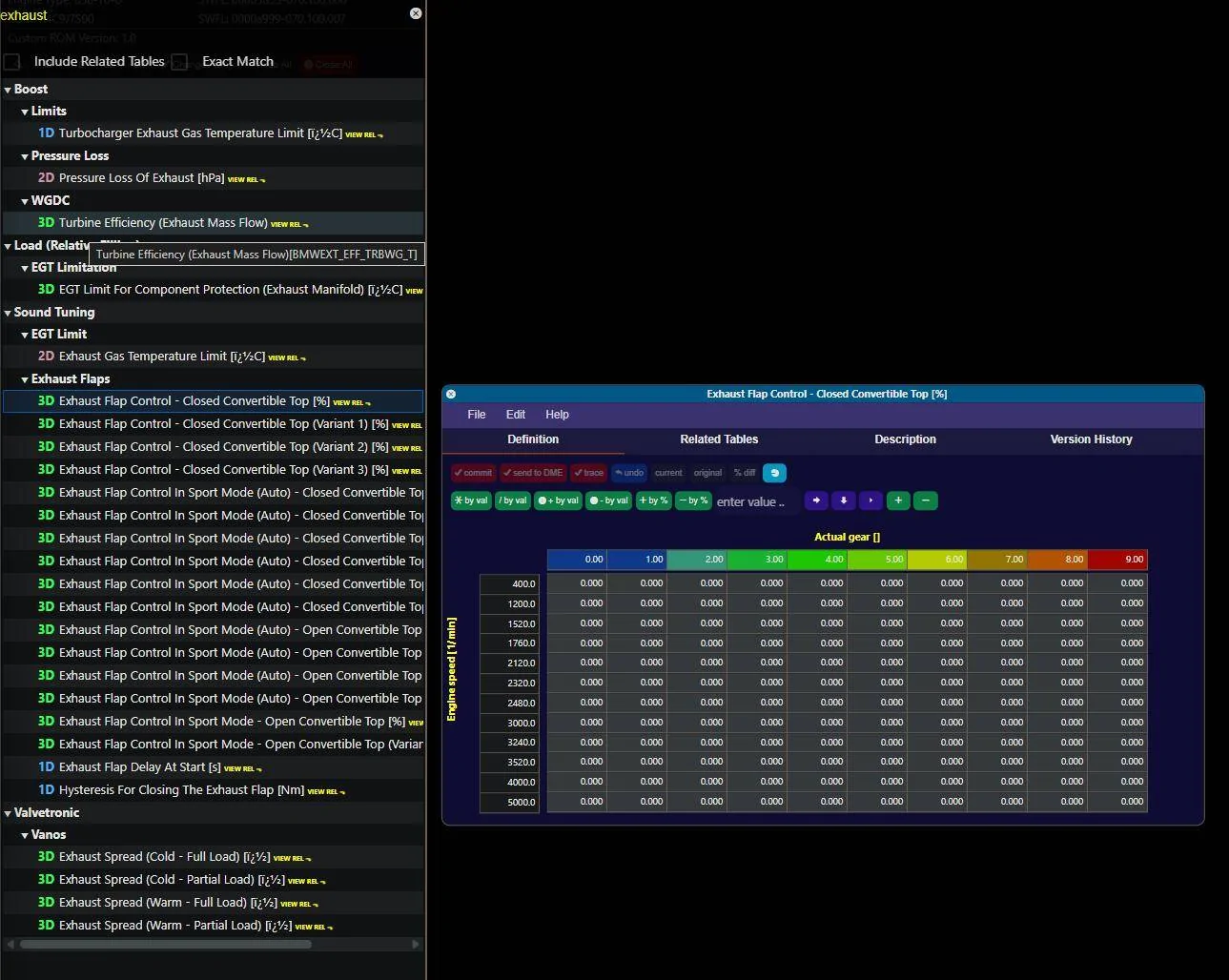

I got a question with this Rev2 release
At first i couldn't understand why PTF would use the exhaust flap to control PI. Searched in the map editor and saw that we have a table for exhaust flap. Dafuq? So is this the table we use for PI now?

I'm going to assume that is what they will be using but since I haven't seen a CustomRom2 yet, I'm not sure.
Also, there are a lot of tables that are and are not used across the platforms. For example, there are also radiator flap control tables, the Supra does not have those.

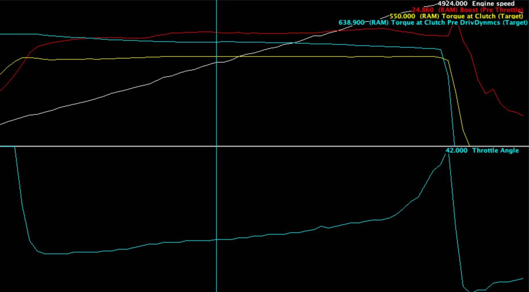

Bumping this thread reminded me of something.
I discovered in Bootmod3, for certain ROM ID's, switching on the "TCU Torque Limit Patch" in map config doesn't actually work.
I was tuning a car without XHP and torque kept flat lining at 550nm even when DME table target was much higher, with the throttle plate shutting down the party. I eventually tuned it out in the actual ROM itself, because the map config setting obviously didn't work.
