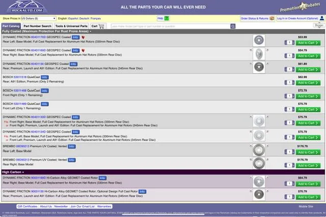

Nosa. No issues. Perhaps colder weather and letting the car sit after rain? I drive my car at least once per week, live in the subtropics ? and she’s garaged. She sees plenty of water. Dynamic Friction Geospec rotors and any race pad have been fine.
